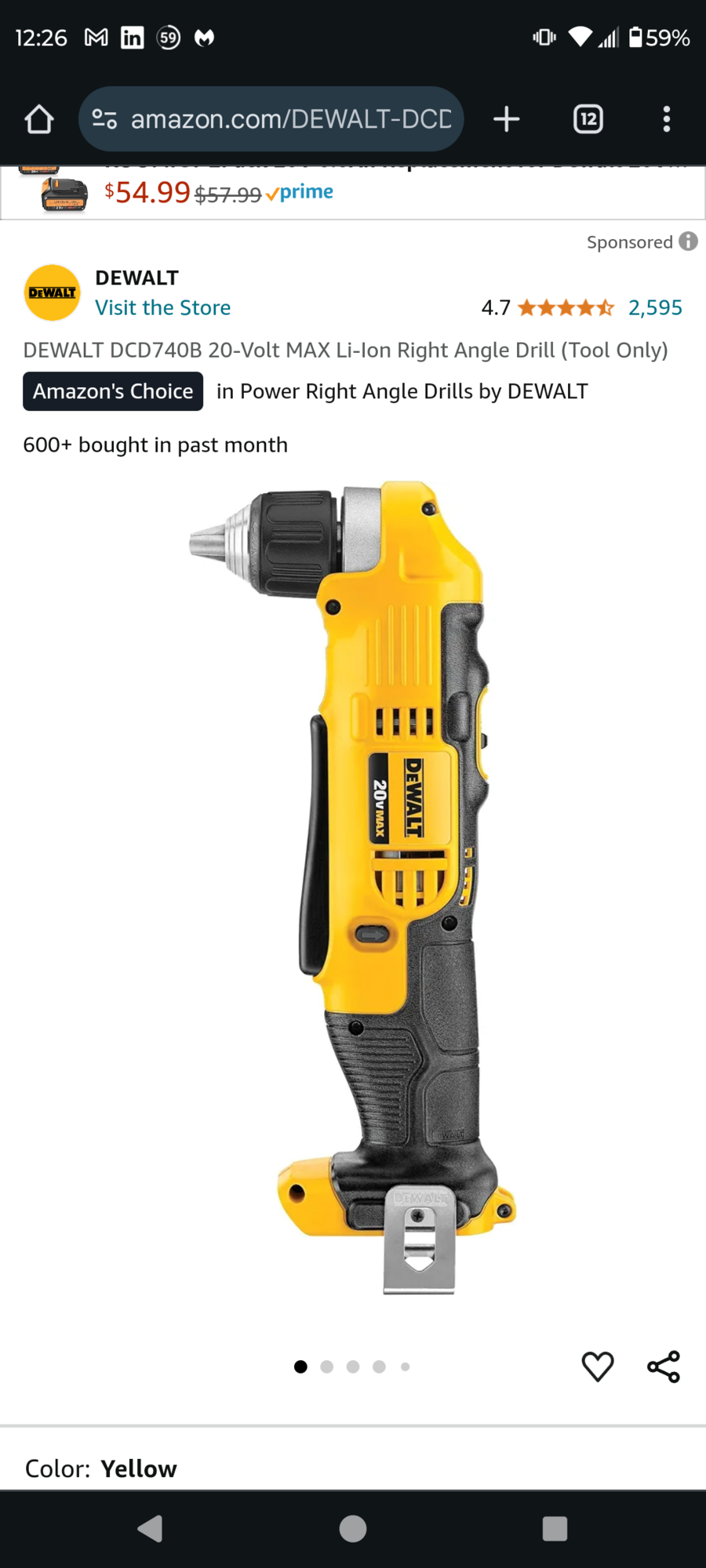

Have you tried an easy out on the broken bolts?
I would suggest using a drill like the following
Right angle drill
You'll probably need a longer drill bit if there are clearance issues. You'll need a steady hand to keep it from wandering and to keep the drill bit parallel to the hole.
If it comes down to it, there's nothing stopping you from removing the serpentine belt and removing the AC compressor and its bracket if necessary to get the lines out of the way. Obviously you would leave everything hooked up and just you relocate the compressor so it takes the lines out of where you're working.
