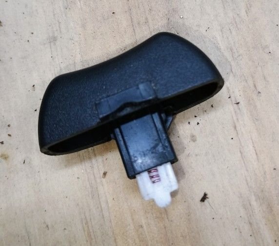

I did confirm that the window lock switch rocker was broken and looking inside the assembly I could see a single contact but nothing else.
broken window lock switch 3rd gen
There's supposed to be a tab on each side of that rocker to snap onto the pivot points on the main assembly.

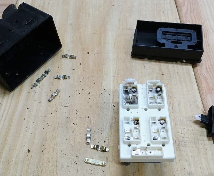

I could also hear something rattling around inside the switch assembly so I took the whole assembly apart.
center console switch assembly 3rd gen

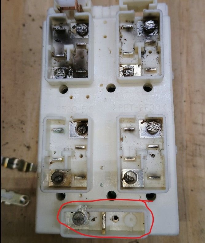

window lock switch contacts 3rd gen
Sure enough the movable contact for the lock switch was out of place and that's what I heard rattling inside.
I cleaned up all the contacts and reassembled everything and this time used some gorilla tape to hold the window lock switch (and its contact) in place.
Window now goes up and down just fine.
Great!
