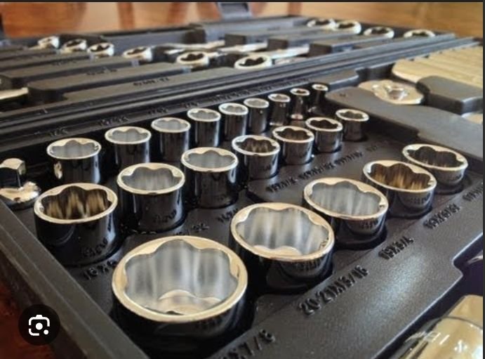

Way late to this party , but for simplicity and end user enjoyment, i recommend you pick up a set or more of REAL metrinch sockets ( NOT THE ONES ON AMAZON )
i have some German TUV-spec sets since i was 19 years old , way back in 1999. Sure, there is many sockets and tools to pick from, but what stood out to me, was these sockets worked on exotics, without scratching or remove paint off nuts and bolts. ( I worked in collision repair for expensive cars)
Looks like they grab on the points of the fastener head, not on the sides of the fastener heads. You may not scratch the sides of them, and no they are not notched crappily like a 12 point socket, but it still looks like there may be a good amount of play where the points of the fastener head sit.
Or is that particular shape in that design advantageous because the corner of a fastener head will find its natural resting spot inside each of the arcs regardless of the wear on the different corners of the fastener?
Please do tell
Please do tell
