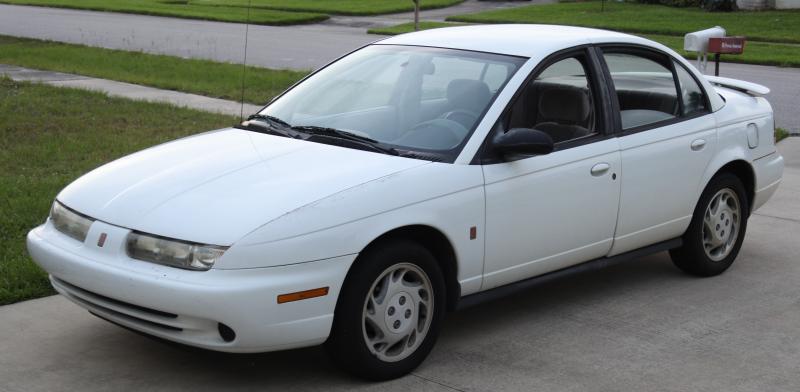

Here it is. A photo of my new daily driver. A '96. I don't know if it's an SL1 or SL2.
