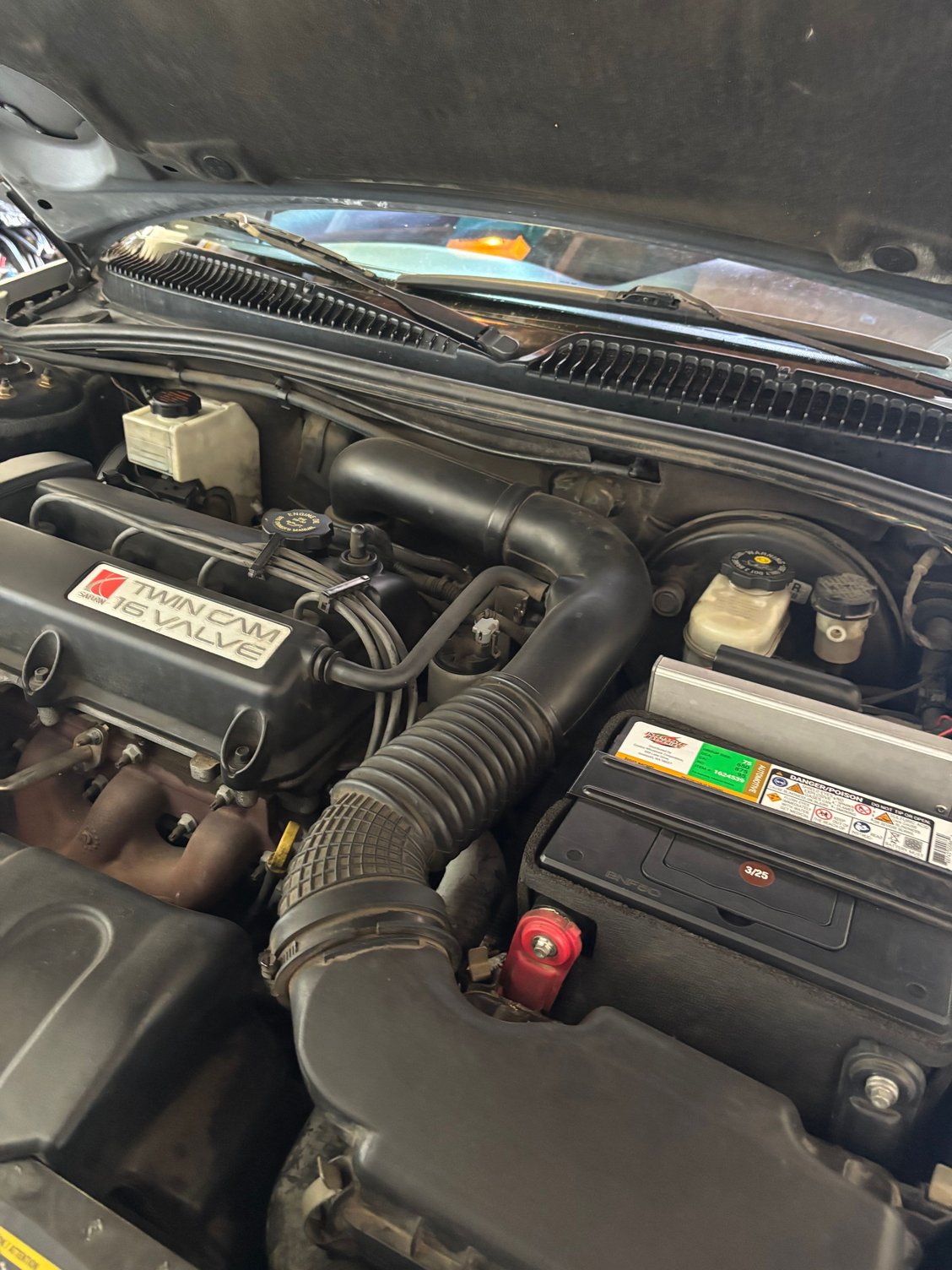

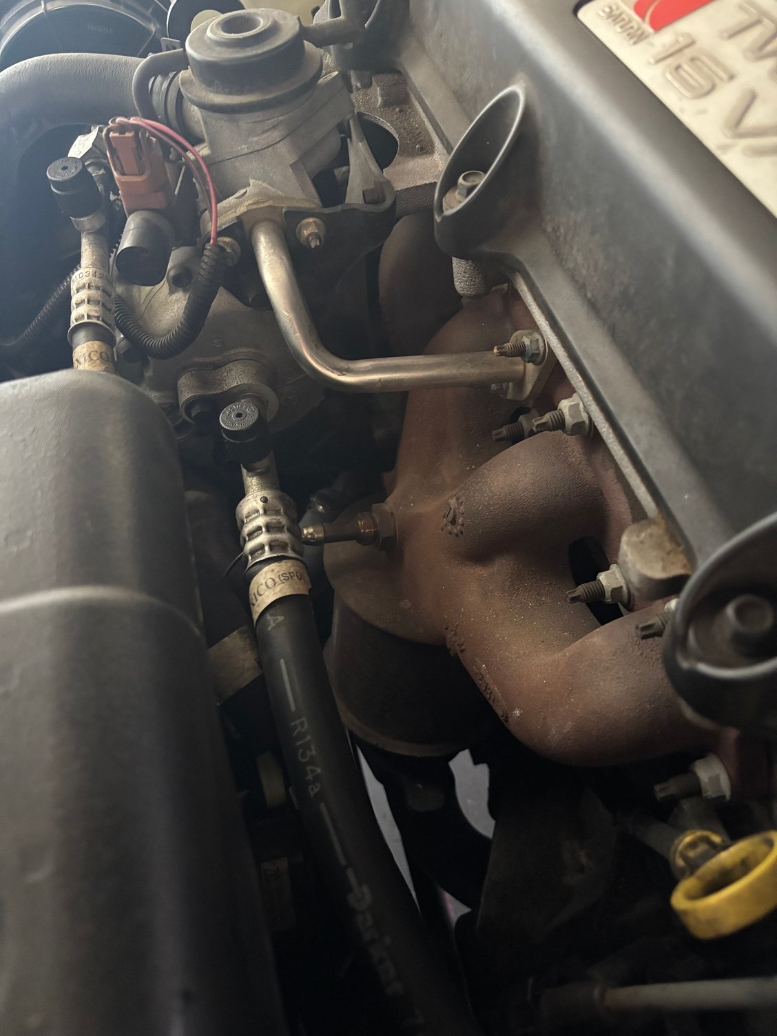

Greg97SW2 Feb 7, 2026 03:36 PM
https://cimg5.ibsrv.net/gimg/www.sat...318e42075.jpeg
https://cimg6.ibsrv.net/gimg/www.sat...42c283c88.jpeg
Here’s a 2002 DOHC engine. The precat is fairly obvious.
Rubehayseed Feb 8, 2026 09:00 AM
KInda sticks out like a sore thumb, doesn't it? LOL
derf Feb 8, 2026 12:41 PM
Thank you.
Your power steering fluid appears to be extremely low....
