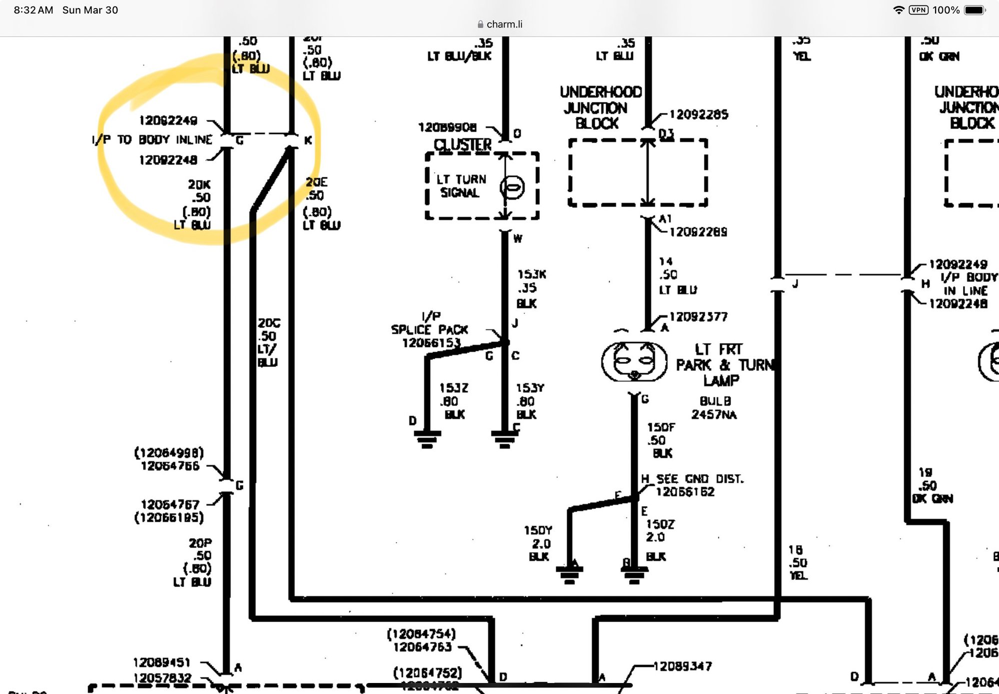

Originally Posted by 02 LW300
Andy,
That's the one spot in this wiring diagram I do not understand. If there are two separate 12 volt runs, what does the "c---k IP to body inline" signify? Are the two supply voltages not already separate?

  #48
G…K are locations in the connector. The third brake light and the rear brake lights have separate feeds from the front to the connector. After the connector there are three feeds, one to each light. My L is the same, lots of small wires in the harness. I split my brake lights and use them as turn indicators and brake lights when towing my L.
