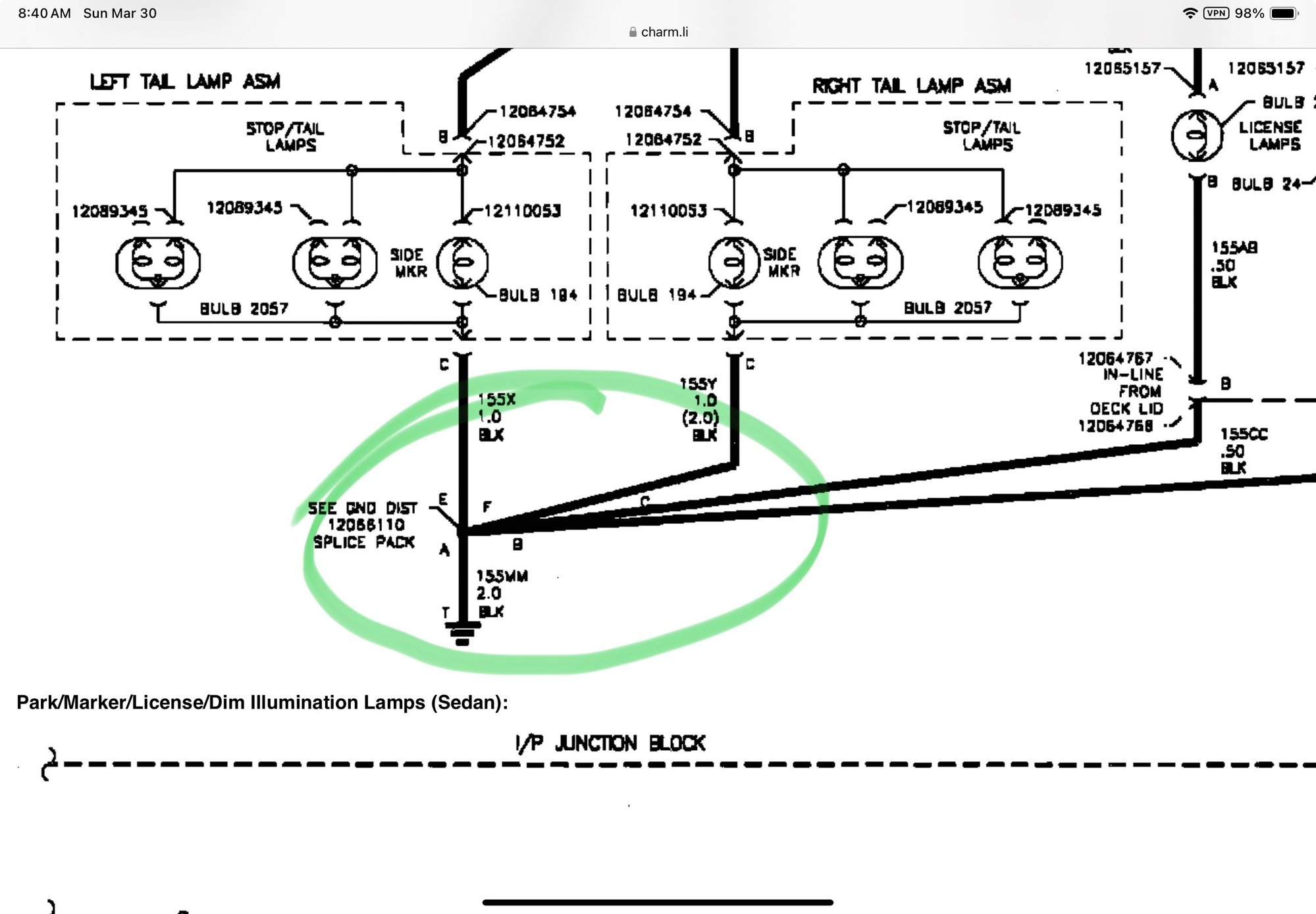

Default Look at this ground splice

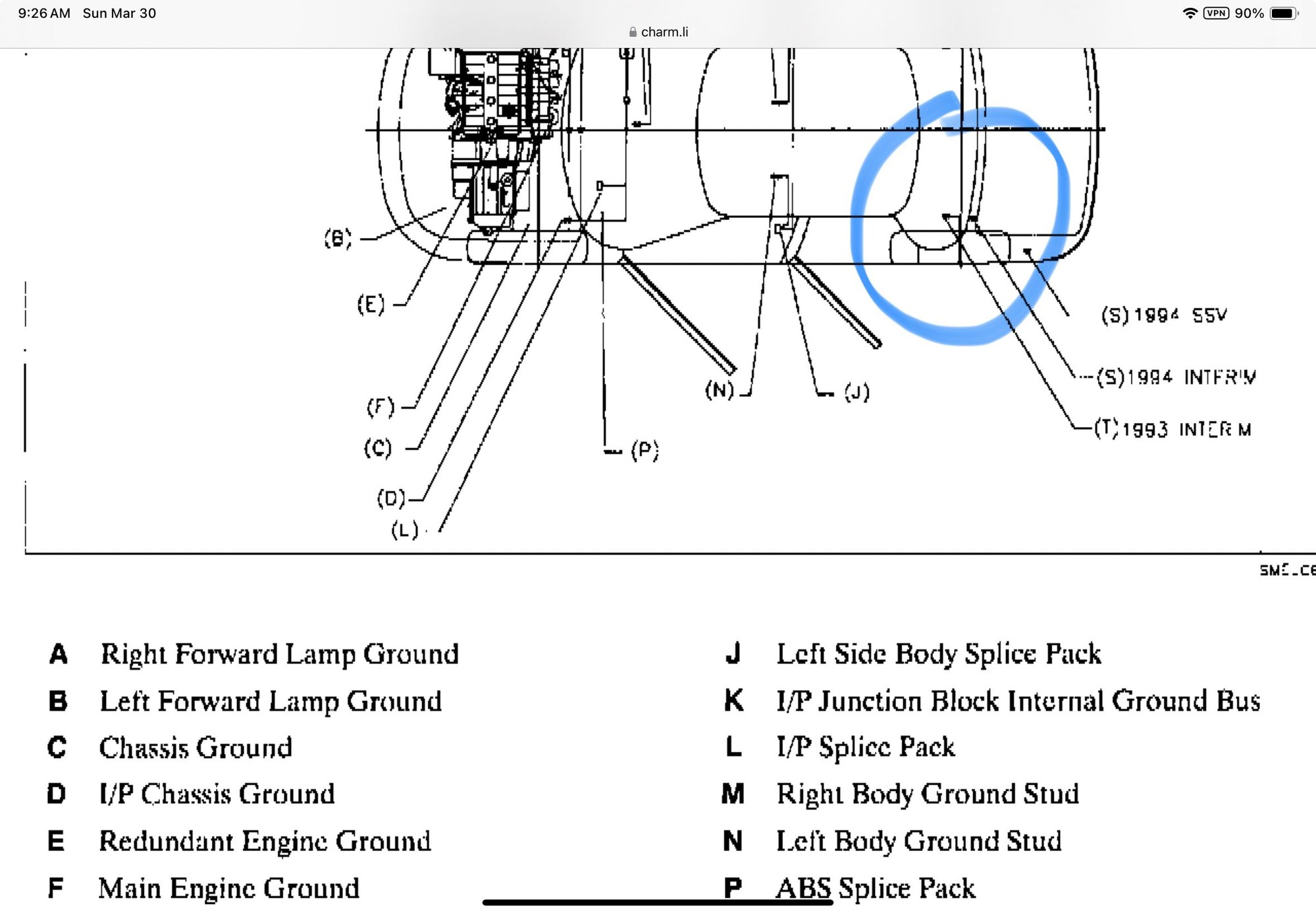

Originally Posted by 02 LW300
Where is that ground splice physically located?

  #37
I would remove the interior trunk trim panels and look. Location T in this drawing is listed as the rear ground stud.

  #38
The ground splice on my car had a plastic cover that I removed. I found each ground wire had its each own connector. I disconnected and cleaned the 1/4” spades.

  #39
Here is the manual link and a couple other pictures. I use an iPad so I cannot edit pictures.
