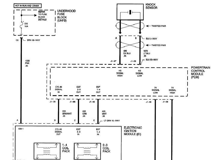

Dude Dec 18, 2022 01:19 PM
OK, so NO codes, pending or current.
Have you confirmed voltage AT the coil pack? As in, is 12VDC making it to the CP?
If so,
https://cimg1.ibsrv.net/gimg/www.sat...23cf1f02ff.jpg
confirm PCM is grounding thru relay, I think that's what derf is getting at.

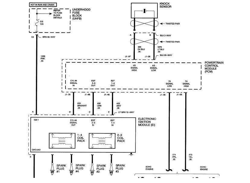

Dude Dec 18, 2022 04:31 PM
We gotta find a connector pic w/connections, my daughter just took Whitey cause I need to look over her Accord! She literally just took it.
https://cimg6.ibsrv.net/gimg/www.sat...dd85a5516.jpeg
Does this help?
Dude Dec 18, 2022 04:32 PM
Or this?
https://cimg5.ibsrv.net/gimg/www.sat...5bda8bc8e.jpeg

derf Dec 19, 2022 07:07 AM
Ow, Shayt.
Happy you are alive. What got broken and I don't mean the car?
derf Dec 19, 2022 07:10 AM
Yeah I'm assuming nothing is getting to the coil packs because nothing is coming from the ICM. I don't suspect the coil packs not being grounded as they are supposedly grounded through the bolts that hold them in and that's not going to change overnight.
I've been working like a dog but I will look today during a break at what the voltages should be at the ICM connectors.
