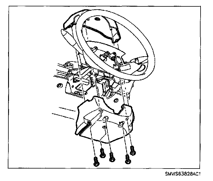

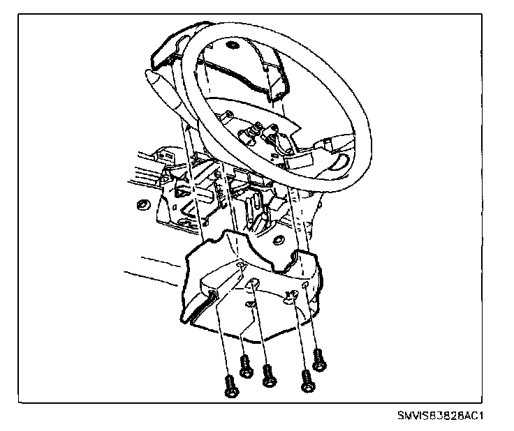

3. Remove shroud fasteners and remove steering column upper and lower shroud panels.

2. Install steering column upper and lower shroud panels and shroud fasteners.
