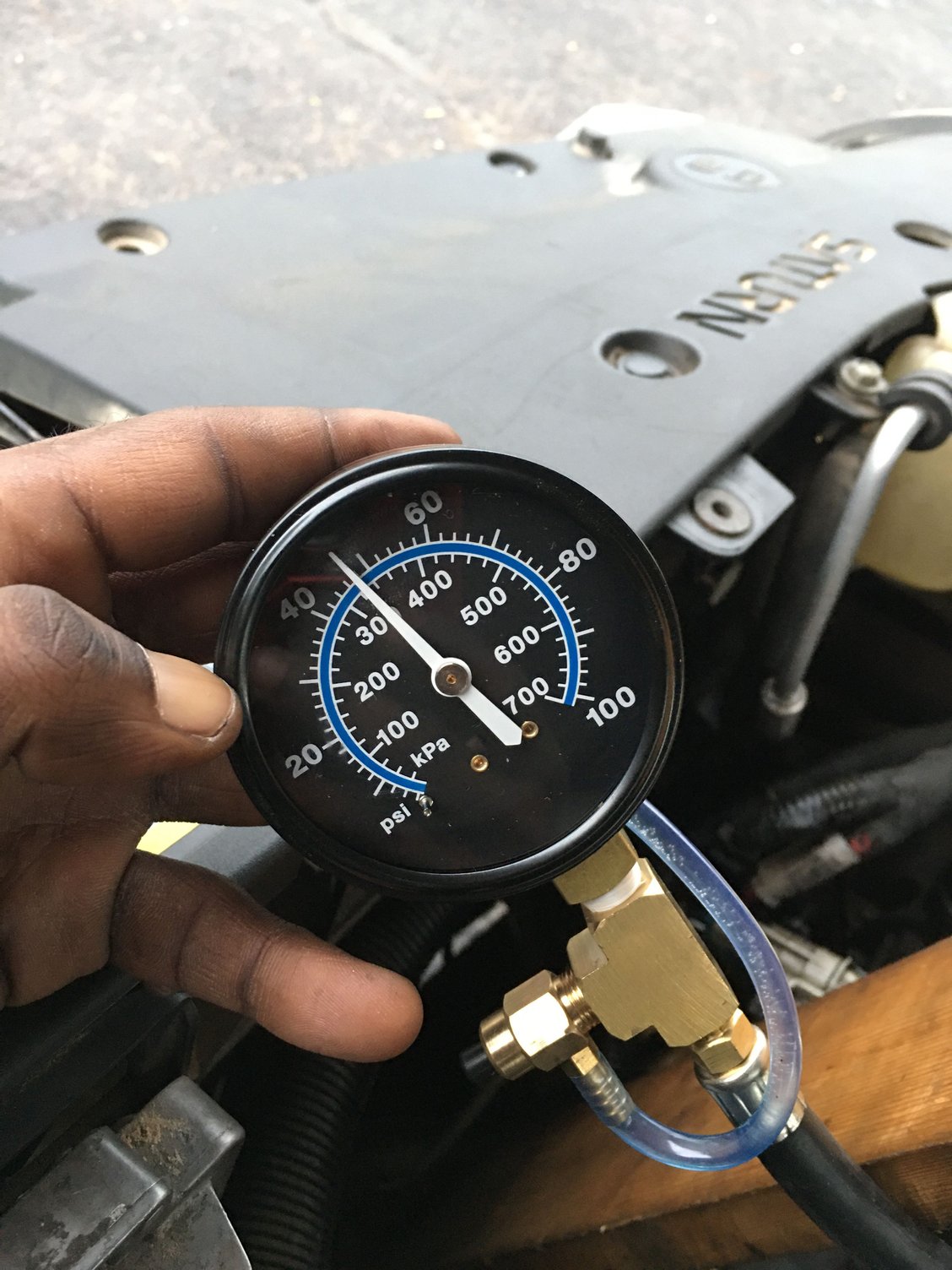

Update: I went on ahead last night and ordered everything I need to perform the test without going to Autozone. (Amazon Prime Same-Day delivery .)
Here are my Results:
Fuel Pressure Test:
Cylinder #2 Test:
Video of Cylinder #6 Test (So you can hear how it sounds while starting):
How does all of this look? I am getting right at 150PSI on all 6 cylinders, Should I try to replace the fuel next or have the Alternator tested? Any other recommendations?

150 sounds low for compression but the readings are even and likely suggest even wear across the cylinders/rings.
Seems to rule out timing chain slippage or breakage on either Bank of cylinders so that's a good thing. No sign of glaring head gasket issue.
When you crank the engine, there is no attempt to fire. You either have no spark or the fuel is crap. I didn't look up the fuel spec for this engine but near 50 psi with the key turned to crank seems reasonable. If however that is the reading with the key turned to accessory, there may be an issue.
But check for spark first at all six plugs.

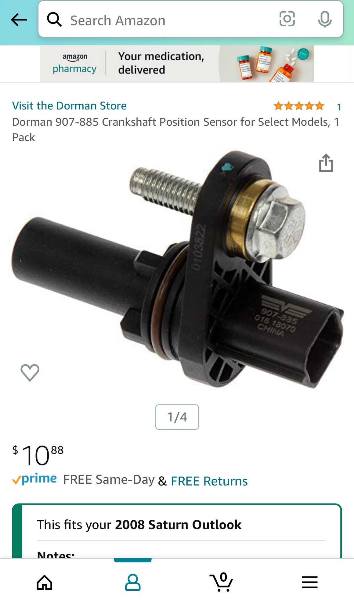

I can't remember. Have you checked the crank position sensor CKP? Most modern vehicles will cut spark and fuel if the ECM does not receive a valid signal from the ckp.

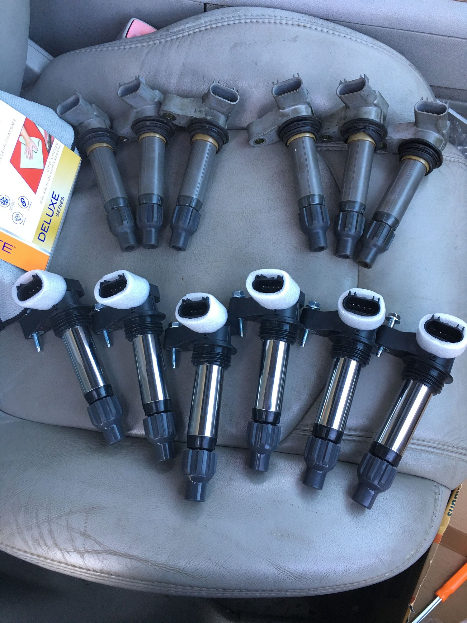

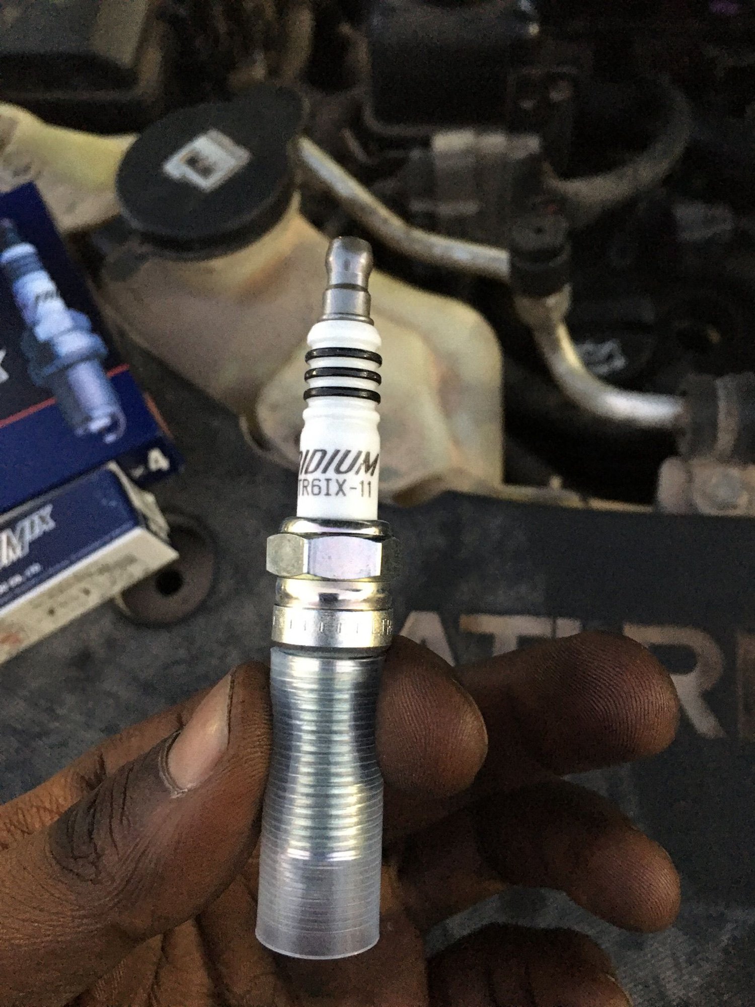

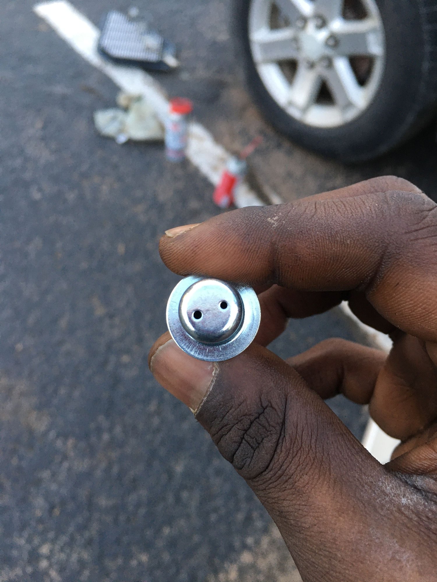

@derf , Here are some more pictures of everything else I have done so far.
New Iridium Spark plugs x6
Spark plug

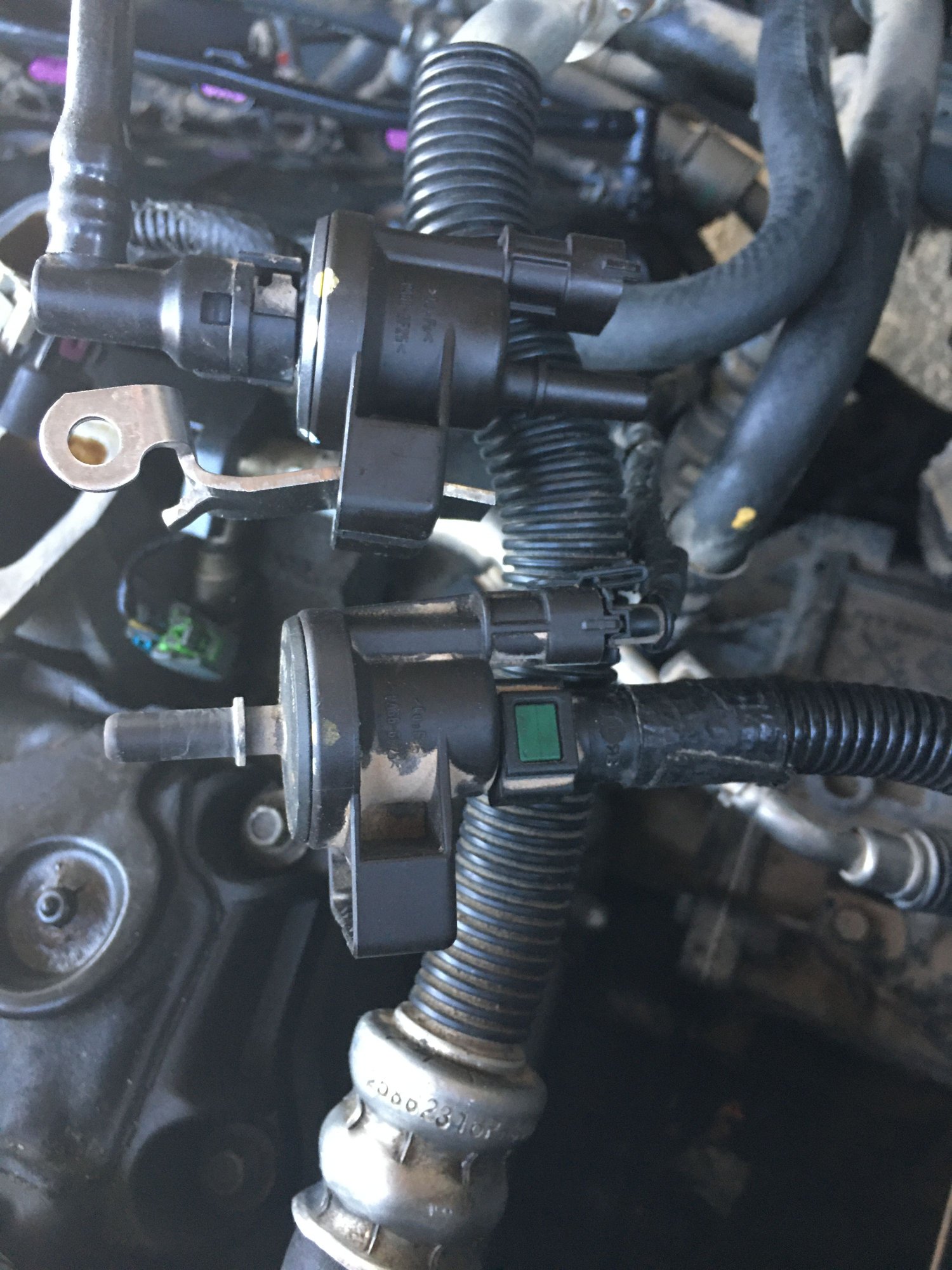

New Purge Valve
New Coil Packs

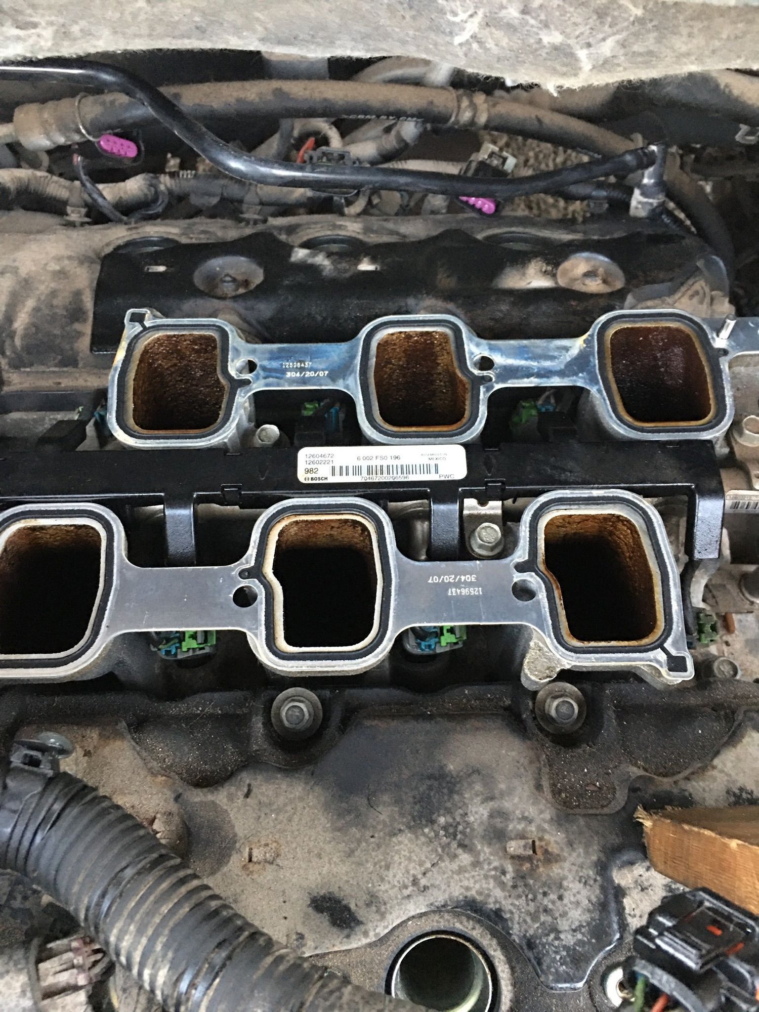

New Upper intake Gaskets installed

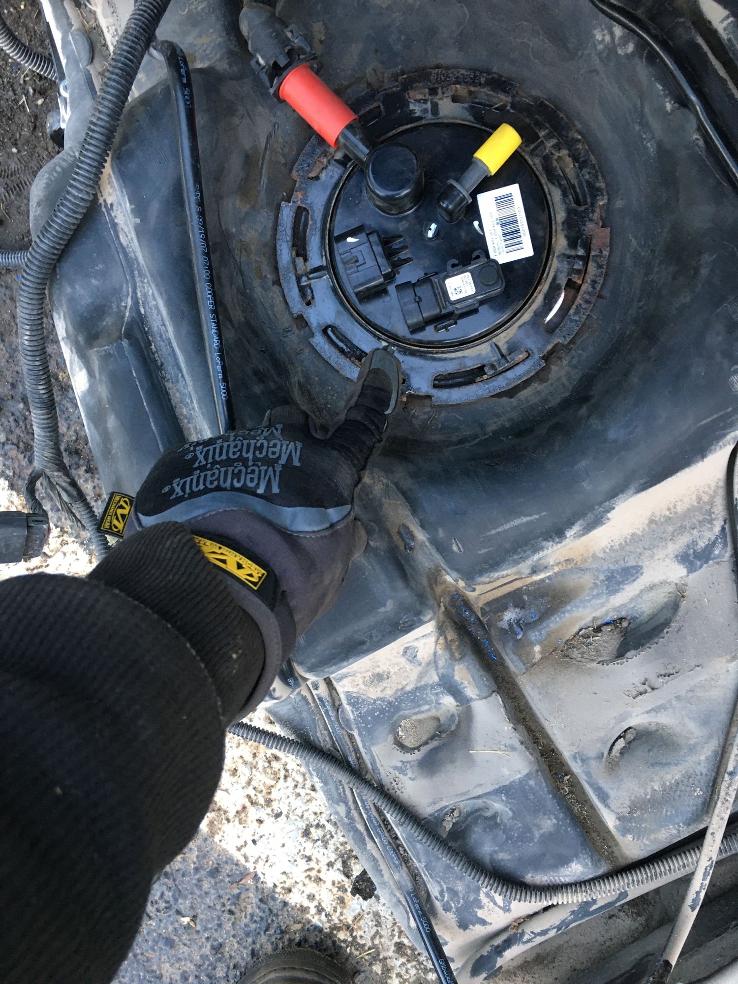

New Fuel Pump installed

I have not checked or replaced the Crank Position Sensor (CKP) as of yet.. However the part to replace it is $10.88 ( with same day shipping) and I found the Perfect YouTube video showing me where it’s located . I’m going to go ahead and order / replace it today as well.. (Thank You for mentioning this to me! @derf )
2008 Saturn Outlook XR- Crankshaft Position Sensor
I do have a question about it..
If something was wrong with the CKP, Would it show up on OBD2 reader? I am not getting any error codes and the test are coming back normal. Just wondering.

150 to 180 PSI is the average. Service limit is 140.
Fuel pressure 55 to 60 PSI with vehicle running I believe. Once again I cannot see your previous post so I will post this and then look back.
Others say 45 to 50 psi key on engine off so I am not quite sure what to think. Let's try the gas since we know it runs on starter fluid.
When you pull the tank down, see if you can get a good look at the strainer in the tank. It may be gunked up with stuff that has formed out of the 3-year-old gas and may be restricting flow.
