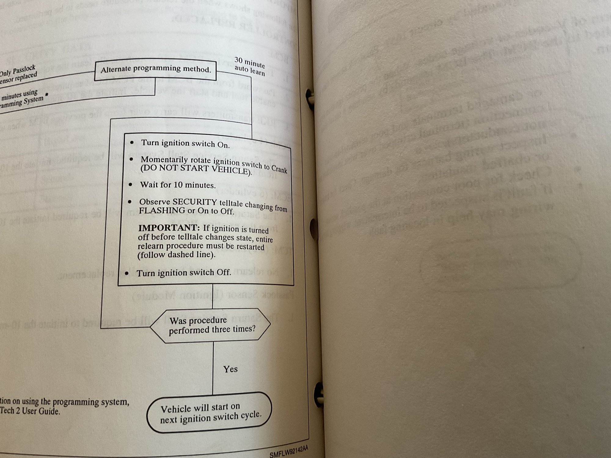

You need to do a security reset three times. I will post the procedure tomorrow. Watching game 4.
Old Oct 29, 2025 | 03:50 PM
You will need to have a battery charger on your battery or jumper cables connected to a running car for this procedure.

Takes about 30 minutes.
