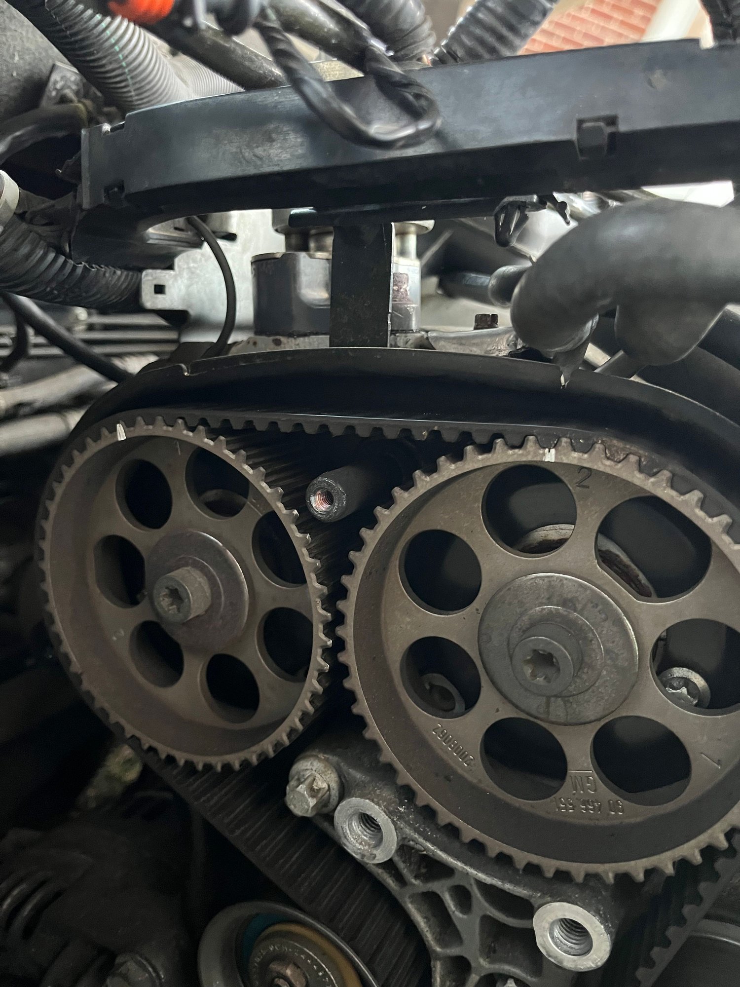

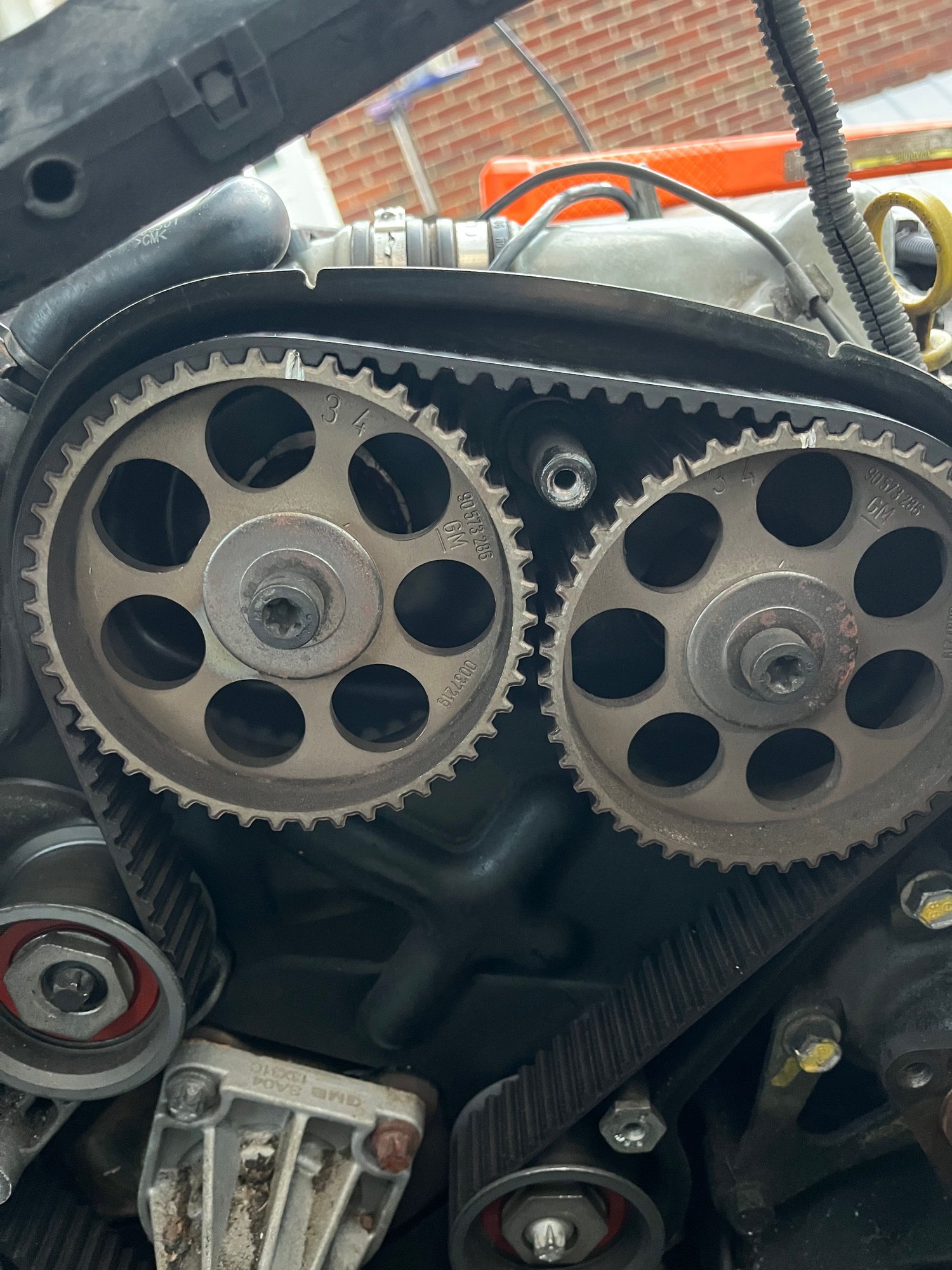

Thanks for the reply. Update... got to the timing belt. Wow. It's been replaced. No name, not an AC Delco, Dayco or any other name brand. No yellow alignment marks on the belt. But the belt "looks" fine. Not cut, torn, frayed, no missing teeth. The previous mechanic marked cam gear notches with white. I have a manual. Crankshaft notch is centered. And the cam marks at TDC don't line up. Rear exhaust cam shows retarded by two teeth. Front exhaust cam shows retarded one tooth. It's got to be one of two things. Either the previous wrench didn't keep the alignment right as he put it back together or somehow it's jumped teeth. Kinda hard to believe someone couldn't see what I see. The notches do not line up. Begs the question.... how can two cams get out of sync on their own. Tensioner wore out? Belt stretch from a no name belt? I've done a couple of DOHC chain timed engines. Never a quad cam. Never a belt. So these marks not lining up is puzzling. It looks like it explains why it idled so poorly. I'm a veteran shade tree. Don't know squat about valve timing and how it relates to vacuum. And vacuum was low. I forget how low, I just remember low. So I went after vacuum leaks. All the way down to the lower manifold block spacer. And why no matter what LetsTryThis stuff I threw at it, nothing cured it. I am encouraged tho. At least I found a real issue that isn't that hard to fix. I'm hoping these two pics load. I'll need to learn how to load thumbnails. Thanks for looking. I really do like the car. It's my commuter. I do have a backup car. A 94 Crown Vic LX. Tried and True. But it's showing its age. Don't want to have to replace the Saturn with something that would probably have more miles and more wear on it than this one.

While I've never worked on one of those, I would think it's because the previous "mechanic" didn't get it quite right. I'm one of those fools that always starts a car for a minute after replacing timing components to see if it starts and runs smoothly. If not, I shut it down and go back over everything until I'm 100% satisfied with it. I always rotate the engine two full rotations before I ever fire it up. That's just to make sure the timing marks still line up. I guess I should have said that first. I have a feeling that you're going to do the same thing. As far as that explaining those codes, I have no idea. Maybe Andy will be able to tell you. Going back and looking at those photos, I can't be sure that those teeth marked on the cams are the true timing marks. Can you confirm that? I see what looks like a couple of notches on the gears and wonder if THOSE are the marks?

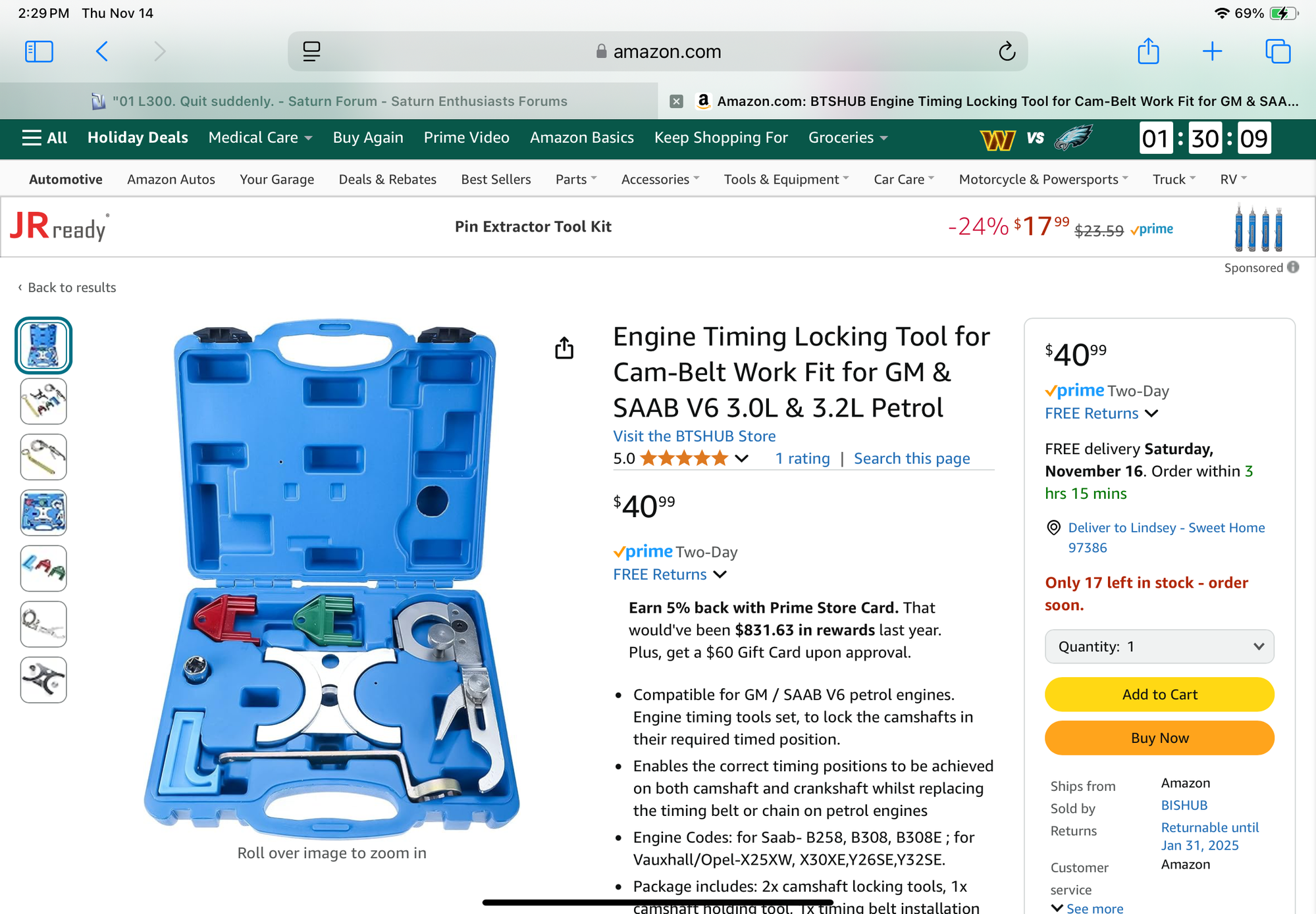

Rubehayseed said "Going back and looking at those photos, I can't be sure that those teeth marked on the cams are the true timing marks. Can you confirm that? I see what looks like a couple of notches on the gears and wonder if THOSE are the marks?" Me too!! Maybe a magnifying glass will help on my end. Also was wondering why it looks like two sets of marks on forward set. I am also getting an "engine speed input signal" code. po 727. Our GM dealer doesn't know what an engine speed sensor is for this motor My guess is a crankshaft position sensor. I just bought the tool kit. I live in Eastern NC, a long way from you. I'm going to get both belts. Wondering about idler pulleys. Also wondering about a new tensioner. If it's not raining again tomorrow I'll have it off and will be able to check out side play and bearing noise on the pulleys. My Hanes manual has a long drawn out procedure for using this set of tools. But I'll use all the advice I can get. Will post up when I find out for sure which marks are which. I had to stop working on it and won't be able to get back to it in earnest till Tuesday. The tool kit will be here Sunday. I'll have parts here by then too. I'm going to replace every pulley in there. Thanks in advance.
