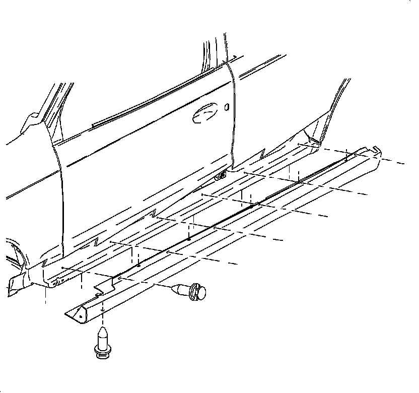

2. Remove the plastic fasteners along the top and the bottom of the rocker panel molding.
3. Remove the plastic fasteners, the rear wheelhouse liner to the rocker panel molding.
4. Remove the plastic fasteners, the front wheelhouse liner to the rocker panel molding.
5. Rotate the rocker panel molding out and down to remove.

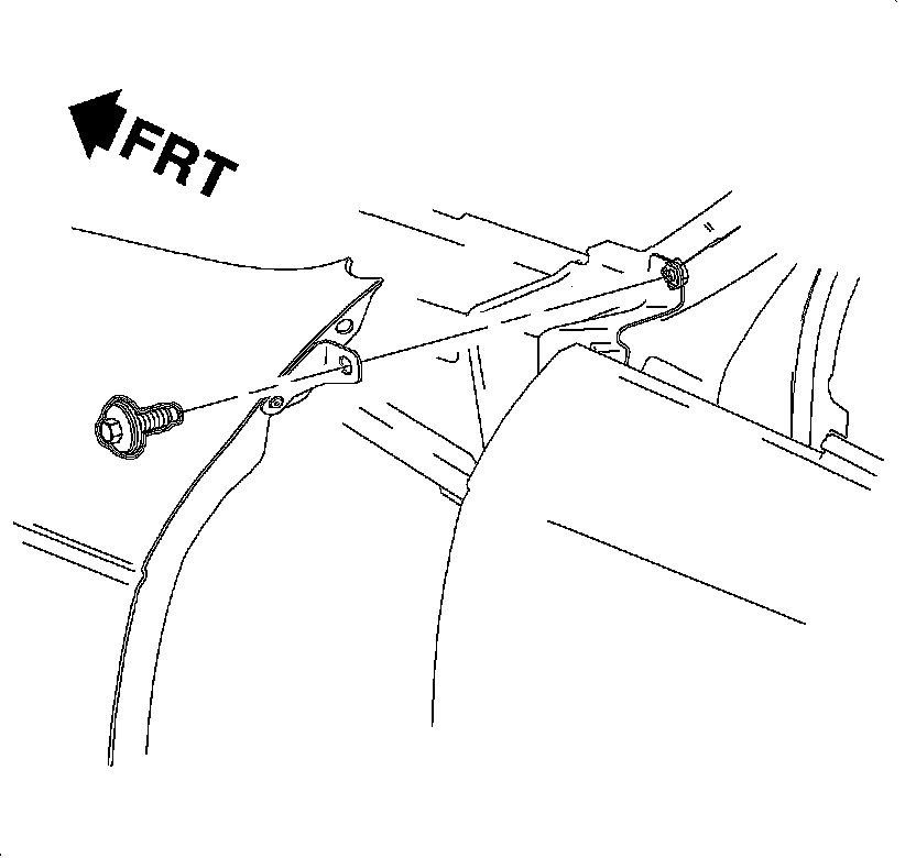

9. Remove the fender reinforcement bolt behind the marker lamp.

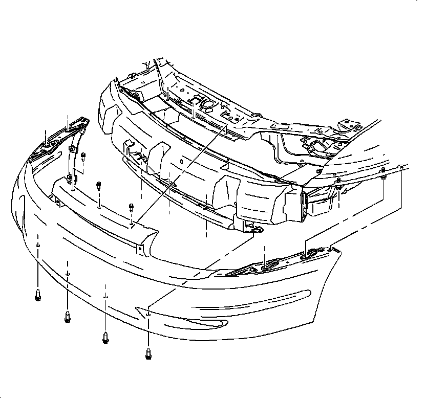

10. Remove the front fascia lower front plastic retainters.
11. Remove the front fascia upper front plastic retainers.
12. Slide the front fascia forward.
13. Remove the front fascia assembly.
14. Remove the fascia shoulder bolts from the fender bracket.

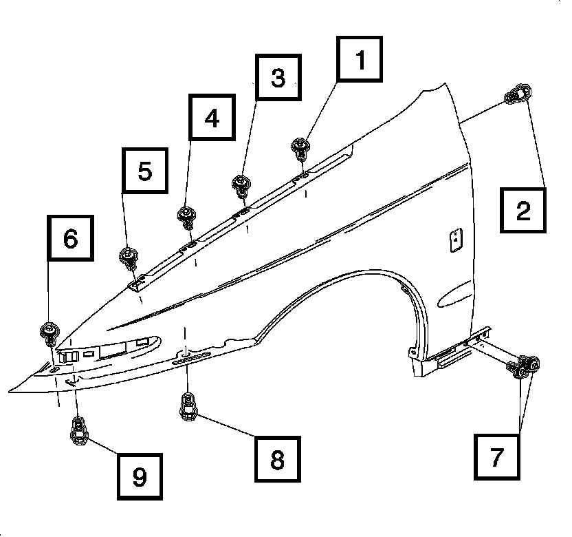

https://charm.li/images/DM15Q313/gm130/1747971332/
3. Install the bolts to the fender and tighten in the correct sequence as shown.
Tighten the fender bolts to 10 Nm (89 lb in).

8. Install the fender reinforcement bolt behind the marker lamp.
