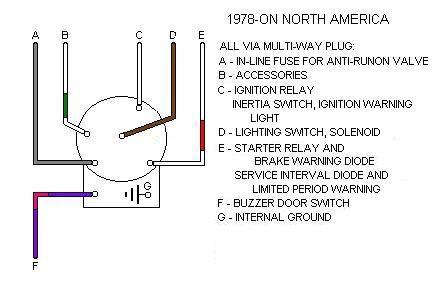

As for the ignition to door locks connection I found the diagram below. My guess is that cable "F" is burnt out. I had white smoke come out of the steering column a couple of times back in 2023; did nothing about it and it did not reappear, but this must be the wire that was loose and burned. I will take the car to a mechanic to inspect the ignition.
