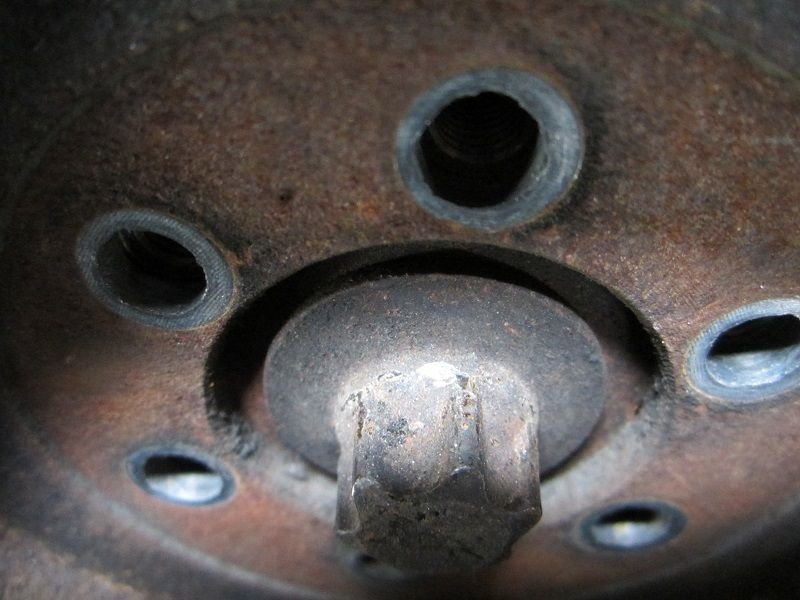

Here's a photo of what I'm looking at. I can't tell if the crank bolt must be removed or if the pulley is just rusted in place. Either way, I have to remove the pulley to change the timing belt.

You do not need to remove the center bolt and the timing belt sprocket unless you need to replace the crank seal or work on the oil pump. The fan belt pulley/balancer comes off after you remove the six little bolts. Your pulley may just be stuck after 18 years and never being taken off.

My manual says you can get the belt off and back on without removing that part.

it looks like your pulley is just rusted to the belt sprocket. Do not remove the center bolt.

Thank you so much! I sprayed it down completely in hope the rust will give way. Might you have a photo of a pulley/balancer off of the mount? I can't find a picture of it anywhere. If I do get this beotch off, I'll post a picture. Any wisdom on how to beat the beotch enough to fall off?

The fsm has drawings only, I can not access the 3.0 I have out right now. I assume that when you removed the six small bolts nothing came off. My power steering pulley was very stuck on my 3.0. I actually bent the p/s pulley a little when I changed my water pump.

Right, the pulley just remained in place. I gently tapped around the pulley, but it sounds like one piece of metal.
The power steering pulley literally fell off. The pump leaked for 18 years and everything is covered in steering fluid. Everything, but the crank shaft pulley/harmonic balancer. I'll just keep spraying it for few days and tapping on it. I wouldn't feel safe using heat because I would melt the rubber.
Any idea how to replace the timing belt without taking the crankshaft pulley off? I don't see enough room anywhere to slide off the bad belt and install the new!

I have had the coil itself fail and have replaced it with the compressor on the car. How rusty is your car? I live in the NW and cars don’t rust here except on the coast. You need to get the balancer off to replace the timing belt.
