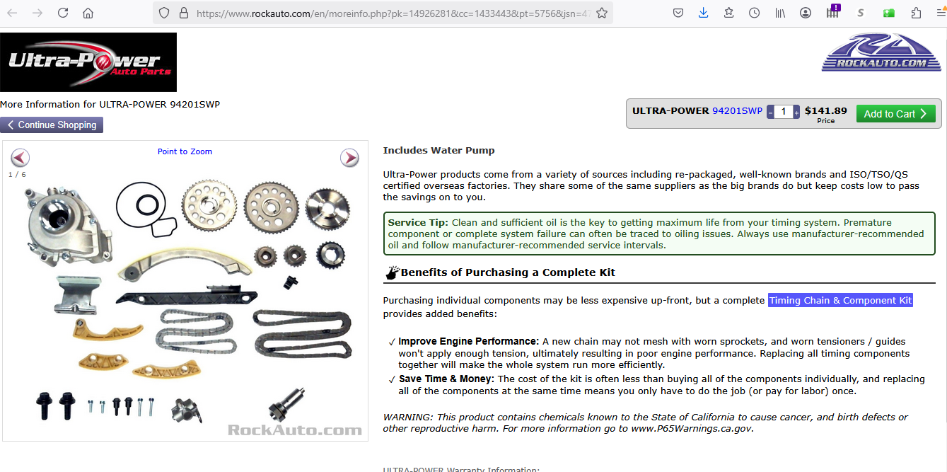

This was the kit i was looking at. I had gotten some parts there before so that was just where i started looking.

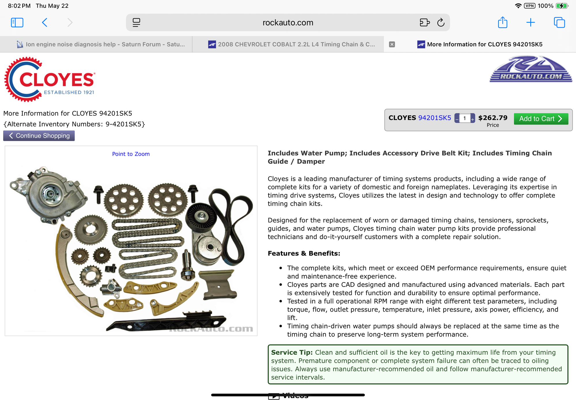

This is the kit I just purchased for my 2007 Chevrolet Cobalt LT. It the same car as your 2007 ION 3. I have the engine out and the cylinder head is off and so is the oil pan. I purchased the car not running at 165k miles from a co-worker. The car had seen extended oil change intervals and that is deadly on these engines. The main chain had stretched and the engine had a broken long black guide. The chain had jumped many teeth and had very low but even compression. I replaced the exhaust valves and I am going to start reassembly this weekend.
Thats pretty close to what i found on rockauto while searching. But that specific one did not show up for my car.
This seemed to be the main one that i noticed.
https://cimg2.ibsrv.net/gimg/www.sat...630f5f9ff3.png
Looks to be similar to yours minus the belt and the item next to it.
Similar/same on partsgeek and A premium. Tho this is one item/kit thats unusually more expensive on aprem then other sits.
