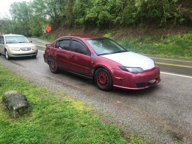

Hello, new to the site. I have a 2004 Ion and I want to change the look of the front of it. I’ve already done some body work/modifications on it, that need to be finished as well. I was wondering if the front on a 97 SC would work.
https://cimg5.ibsrv.net/gimg/www.sat...87cc8ad7f7.png
97 SC
https://cimg6.ibsrv.net/gimg/www.sat...8357fc51a.jpeg
This is what I currently have.
https://cimg7.ibsrv.net/gimg/www.sat...e51680108.jpeg
This is the back.

I know bones put a sc coupe nose on his sedan. I will ask him to post some pictures.
02 LW300 Jun 16, 2024 03:59 PM
https://cimg6.ibsrv.net/gimg/www.sat...71640a3b5.jpeg
02 LW300 Jun 16, 2024 04:05 PM
The rear of the fenders do not fit the A pillar exactly. The supercharged coupe nose really changes the look.

If you look at the picture, you can't do the full s car wrap around on the sides. It's just not shaped in that way. So you kind of have to splice the front part in. I have physically seen that car up close in that configuration. While it looks cool, I think the bottom of the radiator is left thoroughly exposed very low down on the car so you need to put something across there, unless the radiator sits up higher than the s car. For whatever reason, in my mind, the gap between the bumper and the bottom rail looks much wider than the space on the Saturn s cars. That opening was not for air flow, it was for looks. The air dam underneath was angled forward and on springs in order to direct air directly across the radiator. Which is why you never want to delete the air damn if you live anywhere hot. Without that direct airflow, do you stand a chance of overheating.
I'll check with him as to what he did. But as you can see where the ends of the front piece meet the ion sides, the curve is not is not the same so I'm not sure how to gracefully handle that with body work. As you can see and I'm not bashing him, it came out okay but would probably not place in a car show. That dude is very very creative. I don't know if any of you know what the aerocivic is/was. Go look it up on the web. He was the final owner and somebody rear ended him and ended it's life.

That looks like the Redline front. I was thinking about the sc coupe front, as I want to use my hood and the Redline hood is different, so the Redline front wouldn’t work.
derf Jun 20, 2024 05:00 PM
Yep. You are correct. No clue what I was talking about for which I apologize. Indeed I don't think the coupe front has much chance of working although I will now search the internet for someone who spent enough time and money to actually do it and then I'll post a picture
