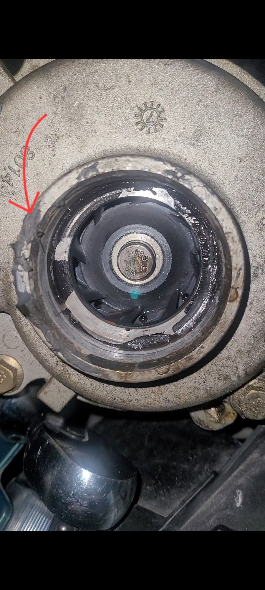

Thought I'd share this. I think this is where it was leaking from. I forgot how the o-ring looked, but obviously, it was deteriorating. So I guess it was a gasket issue and not the actual pump? Either way, replacing just a suspected gasket with all that work would have been crazy.
Anyone know what the stuff the red arrow is pointed at is? Seems like gasket maker but isn't applied all the way around. Could it have come from the o-ring?

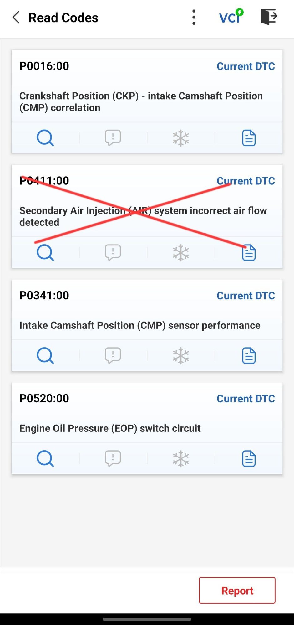

Hey guys, I'm back. I know you're all probably tired of this thread, but I really need help. So, I mentioned that after replacing the water pump, I had a few new issues, including the p0016 code. Well, the car was driving fine as far as I was concerned but today, I started it up (I drove it earlier in the morning no problem) after it was parked for hours and hours and it ran for about 30 seconds and just shut off. I tried to start it back up, and it wouldn't start. Every time I tried to start it, it eventually started sounding like it did after a mechanic replaced the timing chain after it snapped years and years ago. Like a winding sound because the head was warped and needed replacing.
I ran my scanner tool and now have a few more codes, p0341 and p0520. The p0520 is related to the oil pressure, and I've already checked to see if the oil level was good, it was. I wanna say the timing is good since I used the timing chain sprocket tool, but with that familiar sound I hear, I'm pretty nervous. This sucks bad 😭

You're now getting a P0341, which is a camshaft position sensor malfunction. I have learned that what I stated above only applies to 2003-2005 Ions with the 2.2L engine. In 2006 and 2007, there is indeed a camshaft position sensor. It's on the intake side of the cylinder head at the transmission end of the engine.

P0016 indicates that the camshaft and crankshaft are out of sync with each other. This code can be the result of an electrical issue or it can actually be a true indication that the vehicle is out of time.
The P0341 could be indicating a bad camshaft sensor, but it seems odd to have just popped up.
Was the oil light on or flashing during the 30 seconds the vehicle ran before starting?
The 0520 is for the oil pressure switch circuit. This may indicate that the oil pressure was less than expected. If this is true, you may have had an oil pump related failure which in turn starves the engine of oil. Which includes the timing chain.
Do a loan a tool for a compression tester from AutoZone or similar and hold the throttle wide open and test the compression of all four cylinders. Remember to remove the fuel injector fuse before doing the compression test.
