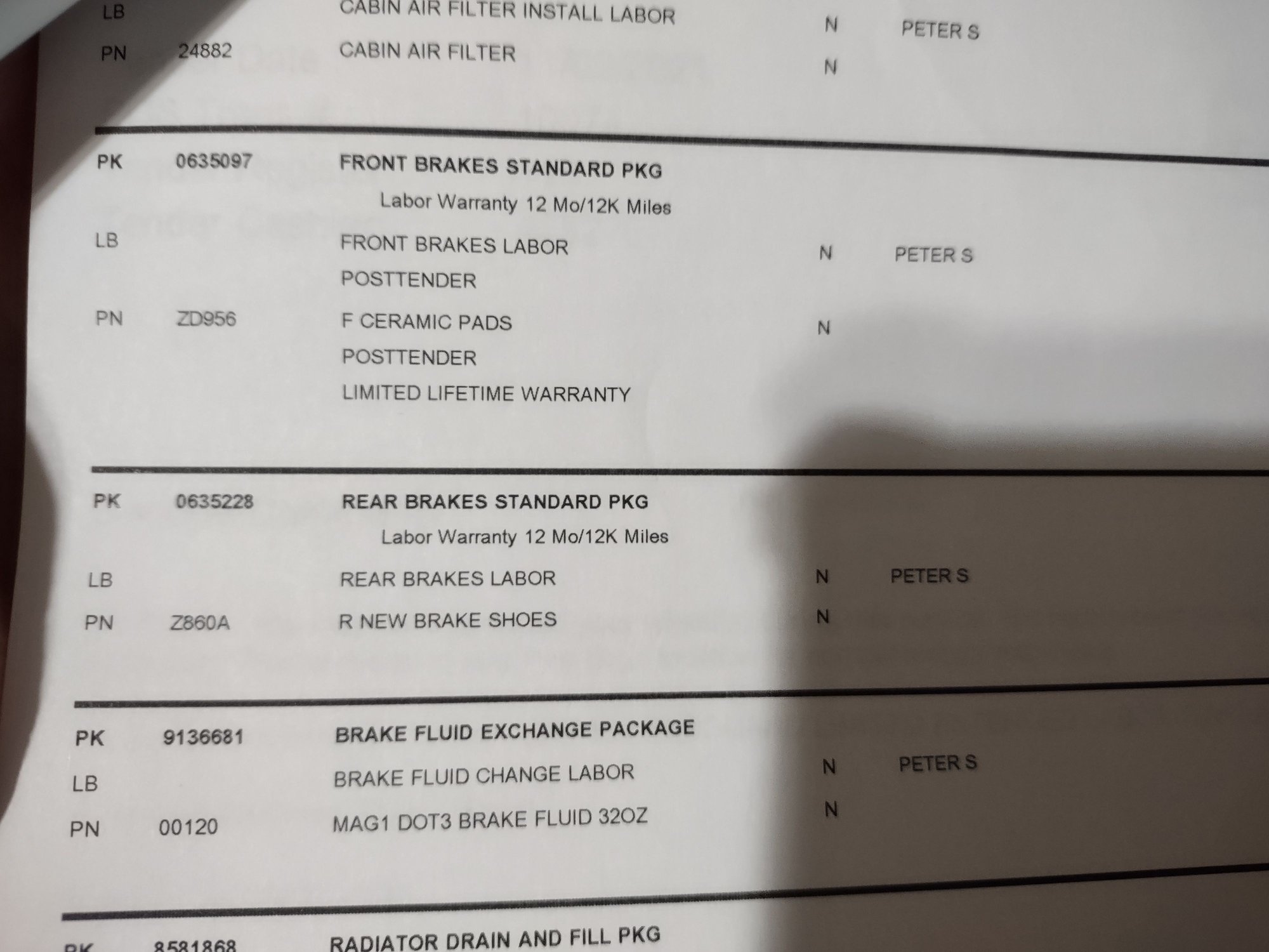

I was looking at the receipt for when they were replaced back in 2021. I was going to call them to see what the measurement of those brakes are when new in order to see exactly the amount each has worn down. But i noticed it said Front brake PADS for the front and Rear brake SHOES for the rear. - I honestly didnt know there was two different types. Much less that both types were used in one car.
So i wanted to check here and ask if its true that the saturn ion 3 has both front brake pads and rear brake shoes.
If that is true, then it raises some other questions.
As i said, i read that the front wheel drive of the ion 3 means the front brakes would wear faster. I also read that PADS, which is the front brakes (if true) wear faster then shoes in the rear. So that combined sounds like the front breaks would wear a lot faster then the rear ones. Yet despite both being replaced at the same time, the current measurements read at front 10/32 and rear 6/32. So.. my rear brakes are wearing faster? How is that so?
Old Dec 16, 2025 | 01:35 PM
Shoes are thinner when new. You will never have to replace your rear shoes unless you drive another 200,000 miles. Your front brake pads should last 40-50,000 miles.
