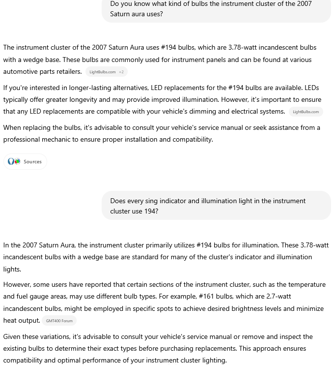

From ChatGPT:
Let me warn you about two things I learned the hard way.
1) When you order bulbs make sure to prefix the bulb number with the letters PC, ie PC194.
The prefix PC on the bulb means that it will come preinstalled in the correct socket. Don't order bulbs without the sockets, because there is a high likelihood that the sockets in your instrument panel are not serviceable.
2) Once, I tried to use a the wrong bulb in one of the indicator lights on my instrument panel on purpose, because I didn't have the right ones on hand. Whenever I tried to start the car the starter immediately died and the car would lose all power for 10 minutes It would not start until I removed the incorrect bulb.
Hope this helps

From ChatGPT:
Hope this helps
WOW, that's an extreme reaction to using.an alternate bulb!
Also, I can't find ANY bulbs anywhere with those part numbers. I am, however, finding bulbs with numbers like PC194CP, and PC161CP. Why is this so cryptic? What's the deal here?
I'd like to actually order the bulbs before taking this apart because I need the car, and I'd rather not do this twice.
