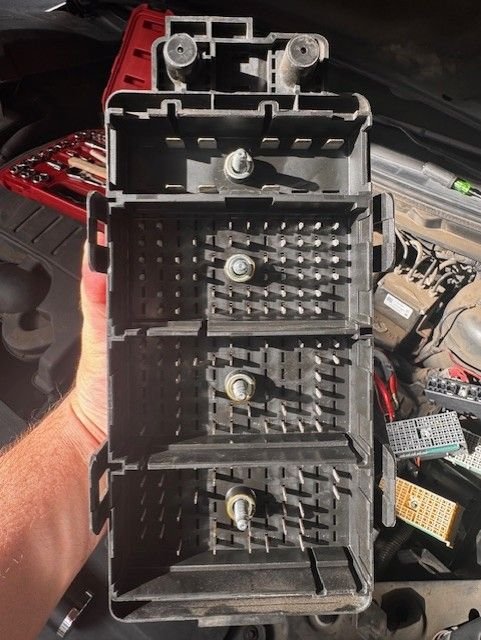

ok so im confused as to what the proper part number is for my fuse box in the engine compartment. im trying to replace it because at this point im pretty sure its the problem, ive checked everything else spent a ton of money getting it "diagnosed" and nothing has been found wrong. so its either the fuse box or a wire somewhere. when i check online im told the part number for my vin is 20822696 every site says its been discontinued and im essential SOL. however when i look at the part on my car its 25883021 see attached pictures. im not sure what to do at this point as i cannot afford to have a car payment and im really struggling to keep my head above water. dose anyone have any ideas?

Your car has California emissions.3021 is the correct part number for your car. The other one you listed is for federal emissions.
Your 3021 part was superseded by 20822697.

You can confirm California emissions by looking at the sticker under the hood with the emissions and model year, and likely the belt routing and AC system capacity. It's usually located on the front most top cross member under the hood. Yellow or white on a black background
