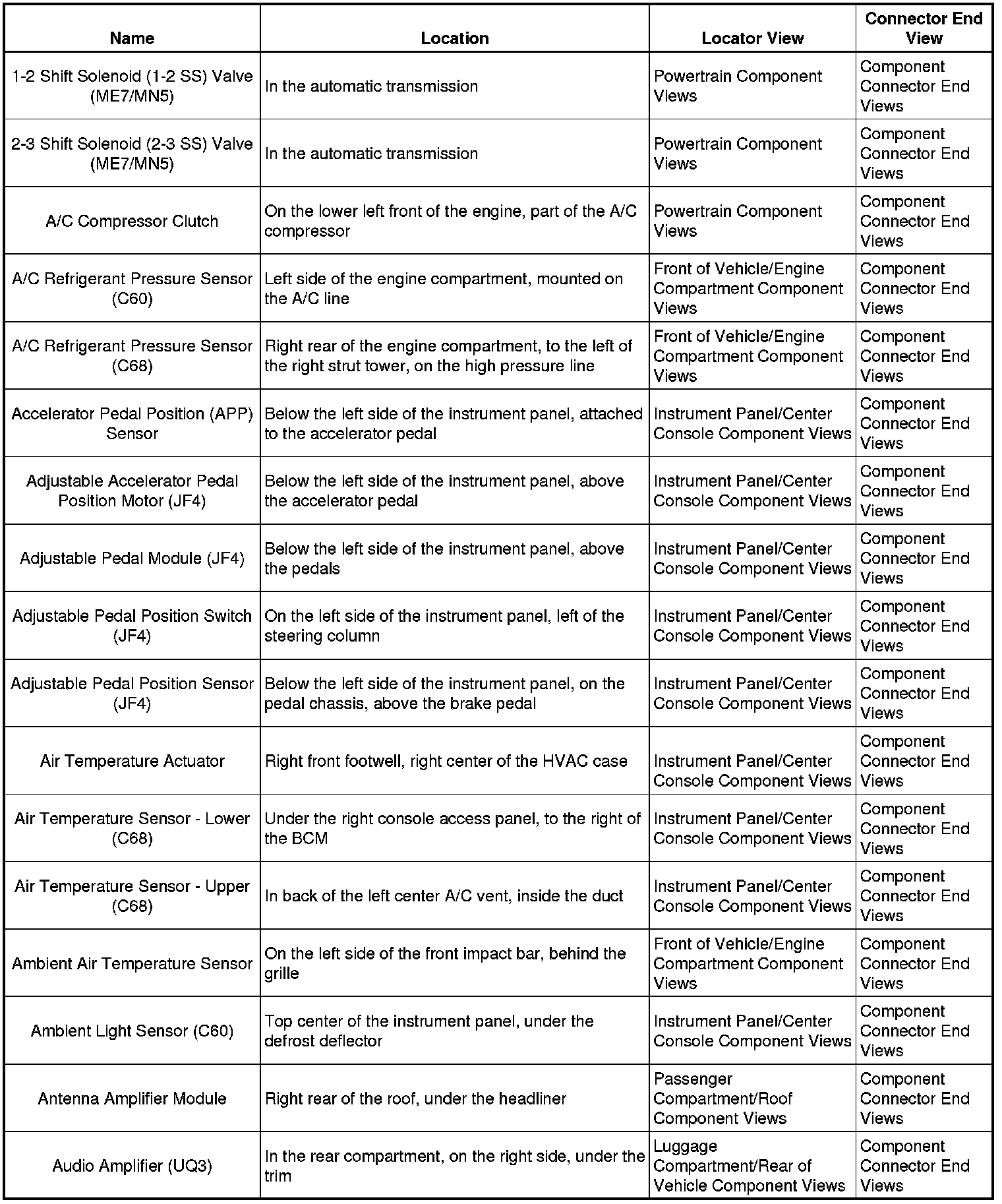

Not the same problem. In yours the fob works to lock but not unlock?
fob does not work at all. I do know the fobs do transmit. Reseated electrical plugs on Body control module. When you go to lock using the driver side door if it is warm outside not all locks lock. When it is cold, locks function normally. The
fuse is good for the remote door lock receiver.

There's an antenna that is in the rear headliner. That may be bad.
2nd from bottom.
