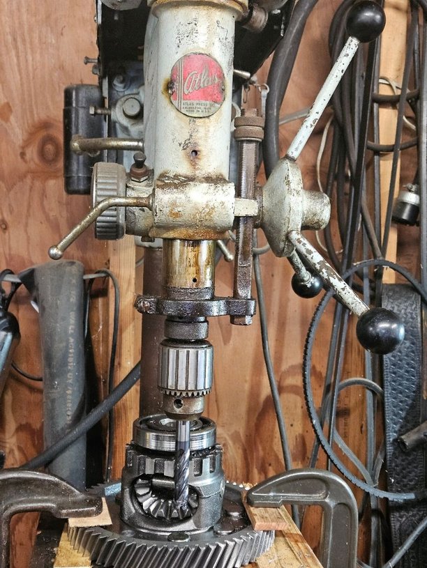

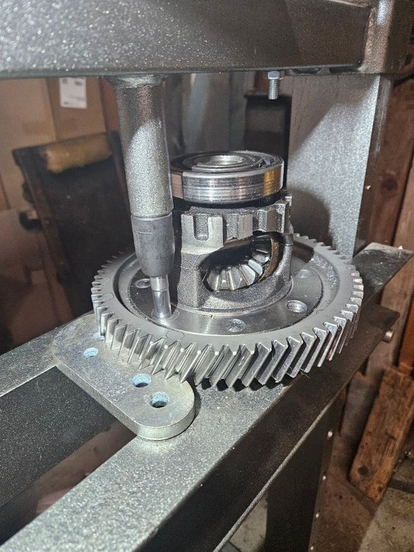

I seem to have met my match. I am in the process of getting an MFactory LSD in the MP3 I pickup last year. I used an center end mill in my drill press to remove the rivet heads. All went well until I went to press out the rivets. I have a 12 ton press and it is to the point where I can not pull the handle down any further! Maybe if i put a cheater bar on it but I know bad things can happen if you go beyond a stress point. My question: Does anyone know if I drill a hole completely through the rivet it may be easier to push out? I don't want take my acetylene to it but dont know if it might take the temper out of the ring gear beside my thinking is they will both be same temp wont make a difference. I am open for any ideas anyone has as long as it reasonably safe.

I would try drilling all the way through the rivet. I have only had one big truck rear end apart that sheared the rivets. I know we bolted it back together and it lived its life. I was not the one to removed the damaged rivets.

I think i will try and mill it a bit deeper being carefully not to go into the ring gear then perhaps drill down through it and try again.

UPDATE: I got the ring gear rivets on and the MFactory lsd attached with supplied bolt and red thread locker. What I had to do was drill a hole down thru the rivet and then mill another quarter inch below the surface level.
