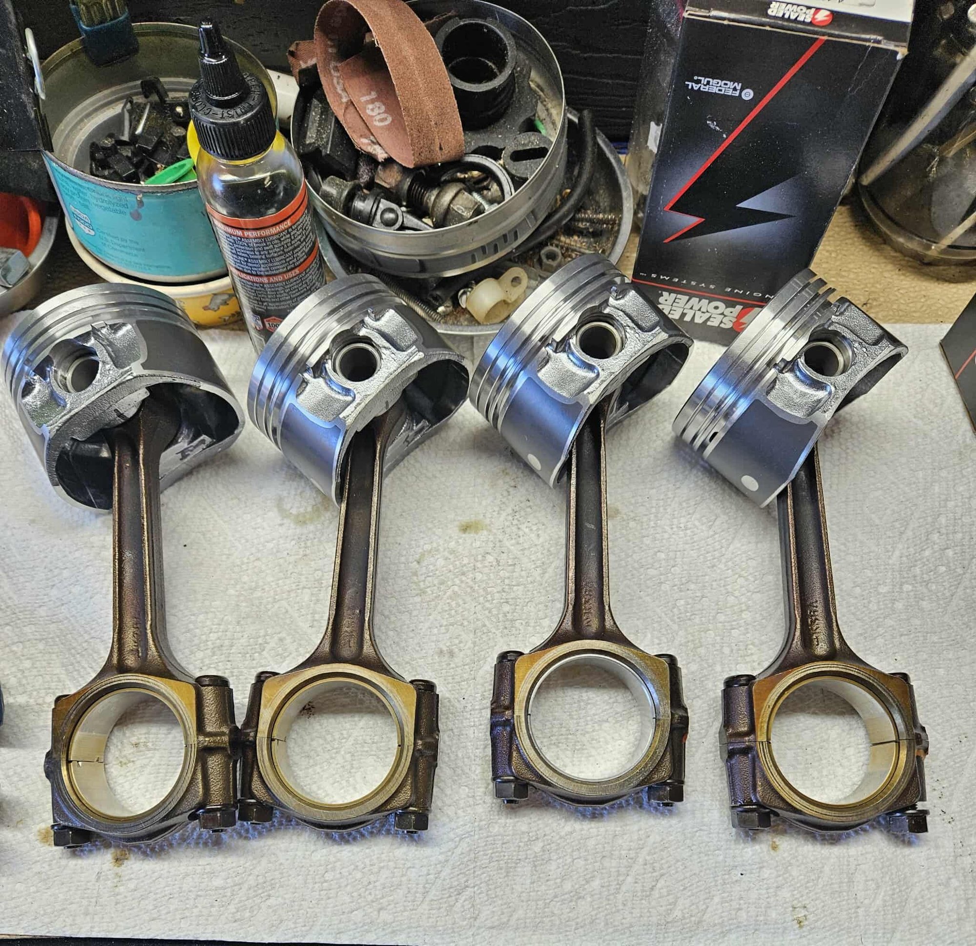

Default Goof up on rebuild
I have been slowly getting the 98's engine rebuilt. I had one goof up on my part and had to reorder a set of rings. I had to file the top ring according to instructions on the pistons I got. The ring gap had to be enlarged. So i ordered a cheapo ring filling apparatus and did practice with the old rings but when I started on the new rings and I am going to blame my 80 year old eyes, I did the initial filling checked the gap went back to continue filling and started on the other side of the ring that was not to be filled! Not only did I file the wrong side I some how got the cut not perpendicular and then trying to fix my goof up made the gap to wide. After that i started marking the side to file with a red marker and did the last 3 top rings with no problem then waited for another set of rings to arrive to finish the job. The rest of the rebuild went according to Hoyle. Posted some pics of my endeavors. Thats it for now still some minor things to do timing chain and all that but almost done. The doner motor from the 97 is still doing OK, burns a bit of oil and will hopefully put the new rebuild in next summer. Now that depends if in get the LSD into the MP3 this winter. I slow down a lot in the winter months
