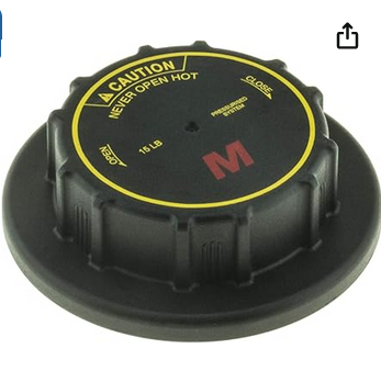

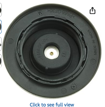

So yesterday I ordered this cap from NAPA
https://www.napaonline.com/en/p/THM7032469
But when I went to pick it up and brought it home today I found this cap in the box:
Why do they make something that should be so simple, so confusing...?
Old May 7, 2025 | 05:24 AM
It has the M so it's probably the same company. I believe I had the white one on my 97SC2. Give it a test fit. It either seals or doesn't seal I think it will work. Did you get a replacement reservoir?

The cap fits and it's marked 15lbs. So I'm assuming that it will be fine? I don't know, that's why I'm asking.
I haven't gotten the reservoir yet. A local mechanic will be coming over this weekend to see what needs to be done.
