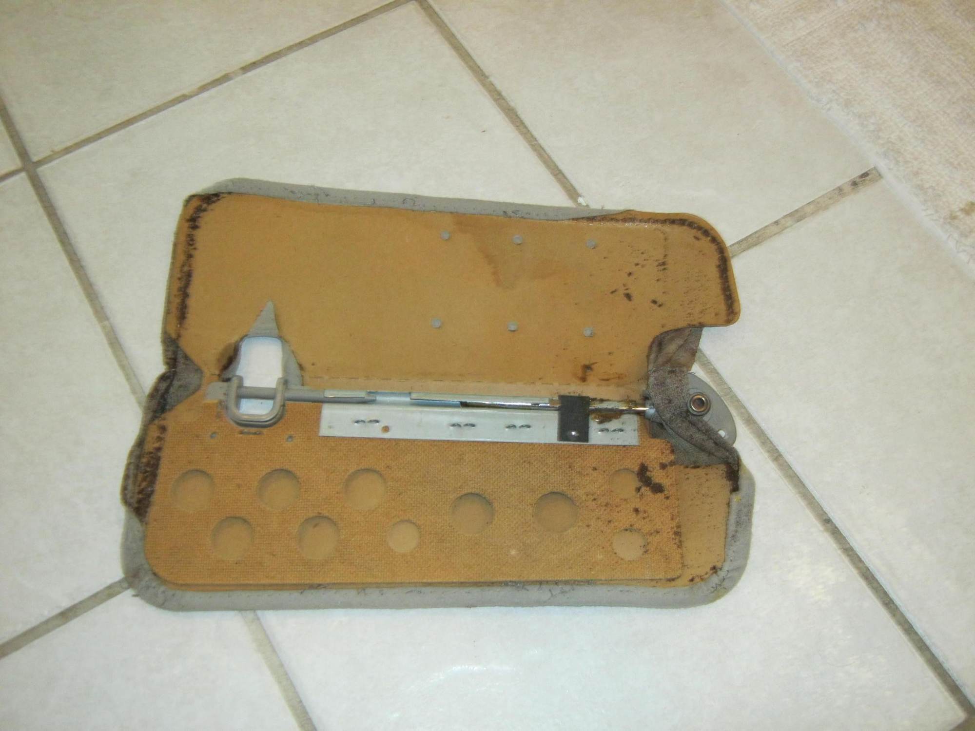

I'm sorry I can't remember the details of the 3M adhesive I used. But I did find a photo of the visors being done that show the 'spider-web' pattern that the adhesive made on the grey foam fabric backing. I remember that quite well because I had never seen that from a spray, and at the time I thought it was weird. So that pattern might be a clue...
And too bad the spray can didn't make the photo.
I'm just so sad that my write-up and photos of the whole headliner project process has been lost. I worked so hard on it...
Maybe someday I can rescue those files from the crashed hard-drive, which I still have in case I can get someone affordable to retrieve my files from it.

That write up would be a great contribution if you could retrieve it. Did you ever try hooking the drive up to a good computer and attempt to access the data?
Also, you made your visors out of carboard fedex boxes? I didn't know you could do that
Yeah, actually FedEx envelopes.
But then I decided that it was too flimsy and glued on another layer. They turned out great. The original factory visors *are* made of cardboard but have a core that is made of hard board (probably thin MDF) which, for some reason has holes) attached to a single rod. So it's the core, then cardboard, then fabric.

I think the holes were for ventilation.$300 is a price to copy data off a drive they can talk to. If not, much more expensive, probably in a clean room swapping the platters into a working unit.
