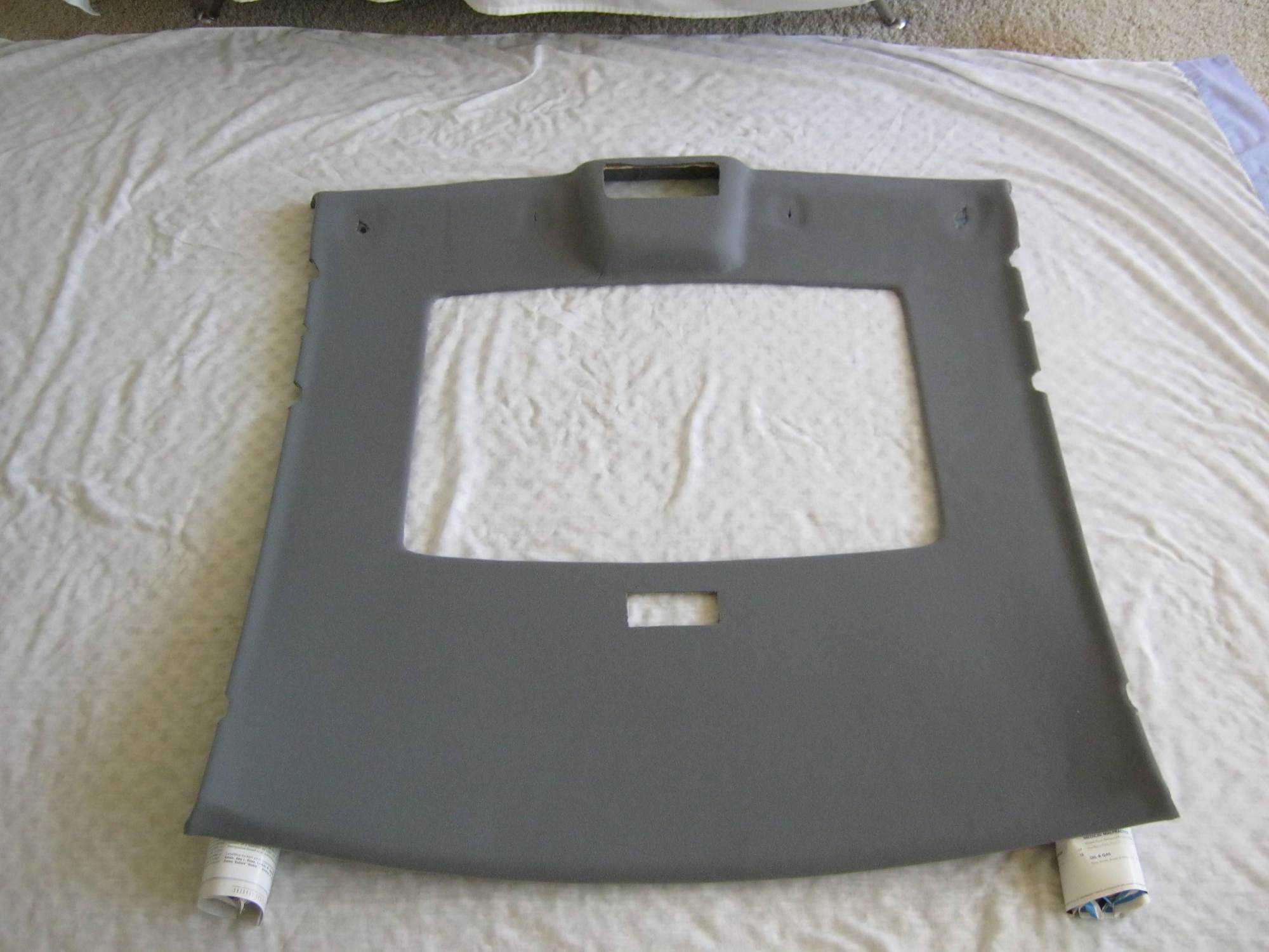

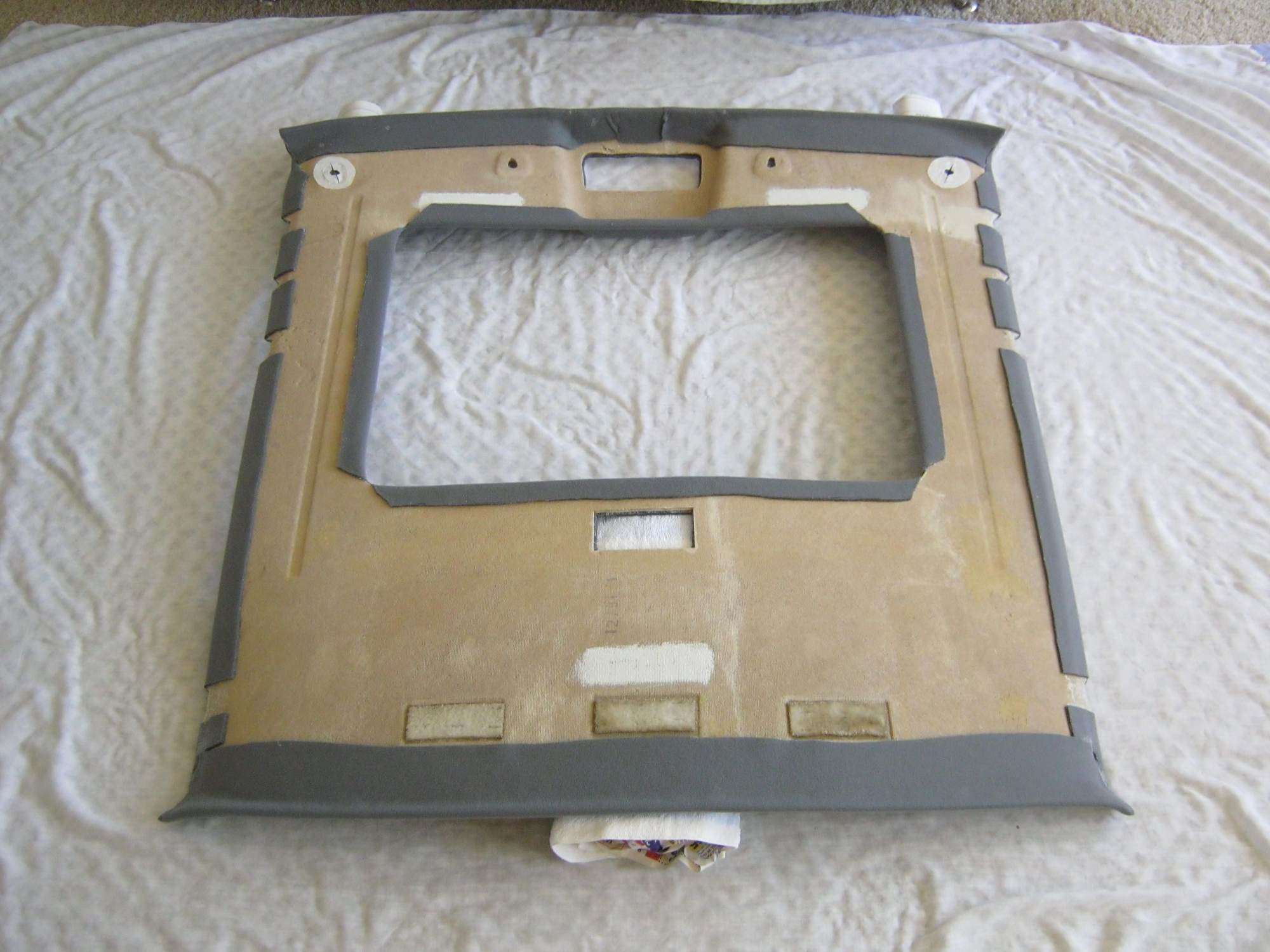

This is the back of the finished headliner. It shows how to fold the fabric on the back.
This the finished headliner.

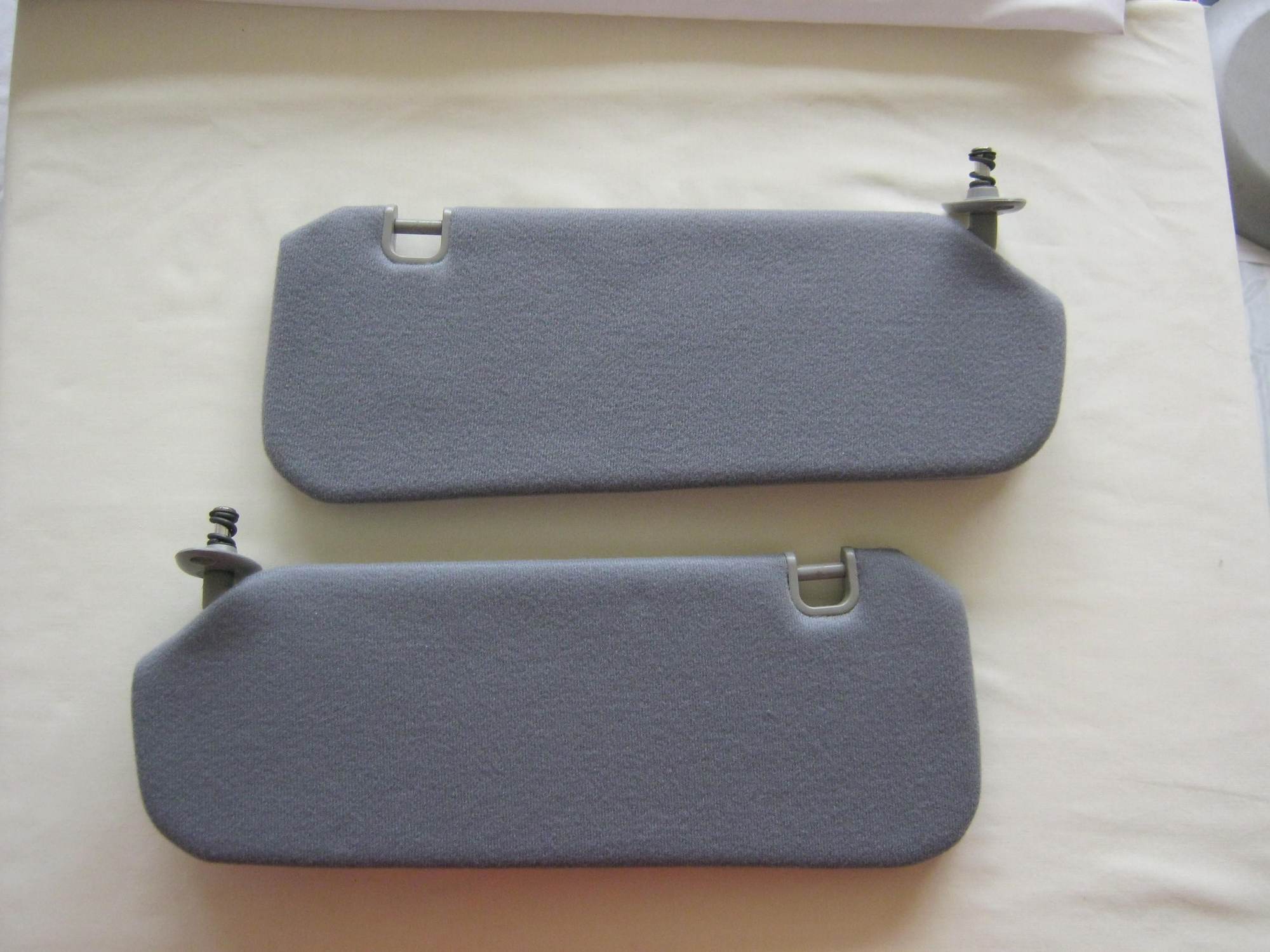

I "rebuilt" the visors, and then took them to a place for them to do the edge stitching.
The finished visors.

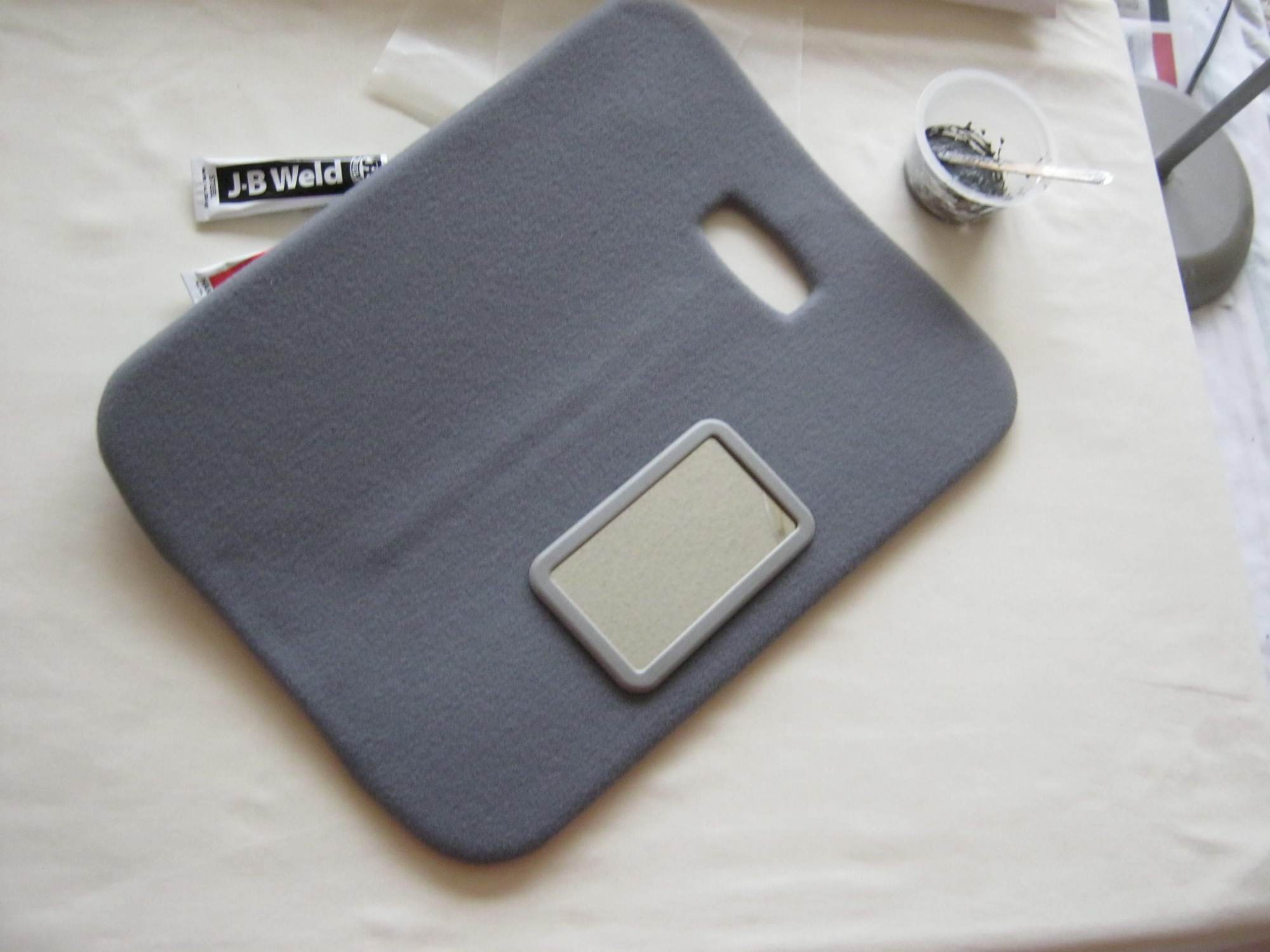

Hey StarLady, what's the JB Weld being used for? I'm just curious as I'm PRETTY SURE you didn't use it on the fabric!

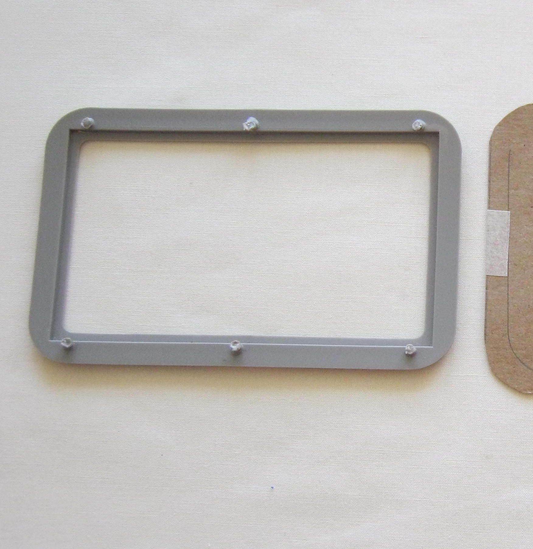

Glad you ask
I used the JB Weld to attach the mirror to the visor. The mirror originally has six tiny plastic posts that go into the visor. They, of course broke when I removed the mirror, so I used the JB Weld to connect them back together.

I only needed help from a good friend removing the headliner from the car, carrying it, and then putting it back in. It's a tricky procedure that must be done slowly and carefully. Be careful handling it and carrying it because it's made of a pretty fragile material that could break easily. It's not made of styrofoam, but it would require the same care as handling a large piece of thin styrofoam.
I'm a bit OCD, so after I removed the old headliner fabric and smoothed the surface (scrape, sand, fill in divots, more sanding), I painted it with some white house paint I had lying around. It sucked a lot of paint, but when it was done, the surface was smooth, and it gave the whole thing a "beefier", sturdier quality. Also a little heavier.

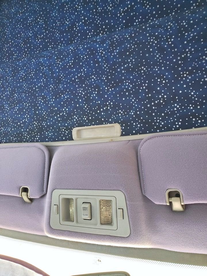

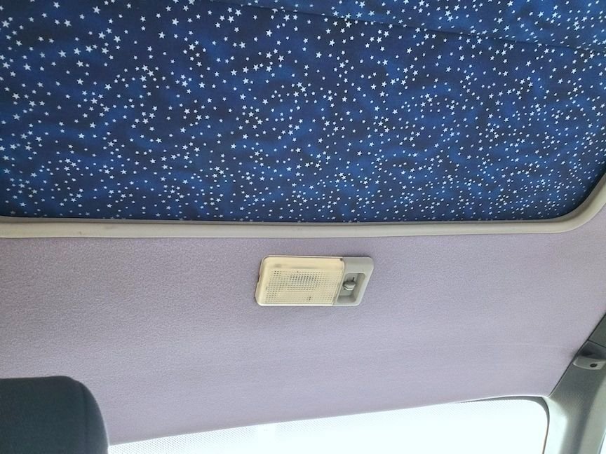

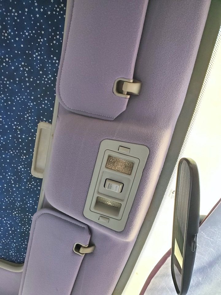

So I took some pictures of my headliner, mainly to give you guys confidence that when using the right adhesive, it will last and stay in place for years (almost 12 in my case).
P.S. I got "creative" with the sunshade.
