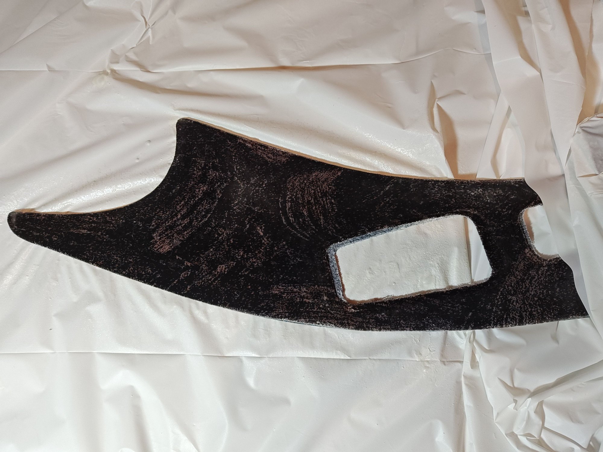

Well, the fabric is glued to the backer board and the plastic door panels have been scraped of all old glue.
Fabric and backer board
Fabric half folded back, backer board with adhesive
Fabric folded back, adhesive applied
Waiting for adhesive to get tacky
1st section, Waiting for adhesive to get tacky
Other half masked, fabric folded back
Waiting for adhesive to tack up
Fabric bonded to backer board, other half
Using the adhesive I mentioned above, you must really pull in on the trigger to get the web pattern of the adhesive to come out of the can that way. There is also a ton of overspray for a project of this small so be sure to cover up anything you don't want non-removable adhesive on.
Applying the fabric was done by aligning everything as best we could, then putting a weight in the middle of the piece to keep the end we were not working on from shifting position. Once the adhesive tacked up, I held the end of the piece we were working on while my wife carefully and expertly applied the fabric to the backer board, keeping everything aligned as best as possible with the edges of the backer board.
There are no straight surfaces to speak of, so this is much more difficult than it sounds. Also, I had messed with this fabric 15 years ago and I stretched it while trying to reglue it. So the fabric pieces did not fit the backer board as they should have. They were both too long. We used the end closest to the door handles as the reference attachment point and worked off of that because that's the first thing you see when you open the door.
When the second one has finished curing tomorrow night, I'll post a picture of both of the completed fabric to backer board sections.
Spent today wearing glue residue off of the inside door panels in preparation for hot gluing the reattached fabric backer panel to each door. Best tool for this is a Swiss army knife short knife that is not terribly sharp.
I will post pictures of those tomorrow as well.
I will reattach them to the doors once I find the glue sticks I bought for this project which are designed for very high temperatures.

I like your photos, derf. Are those 2 pieces of material both from the same door? or are they for both doors? I don't exactly understand why they're folded the way they are or need to be touching eachother. Maybe seeing it all back on the door will help.

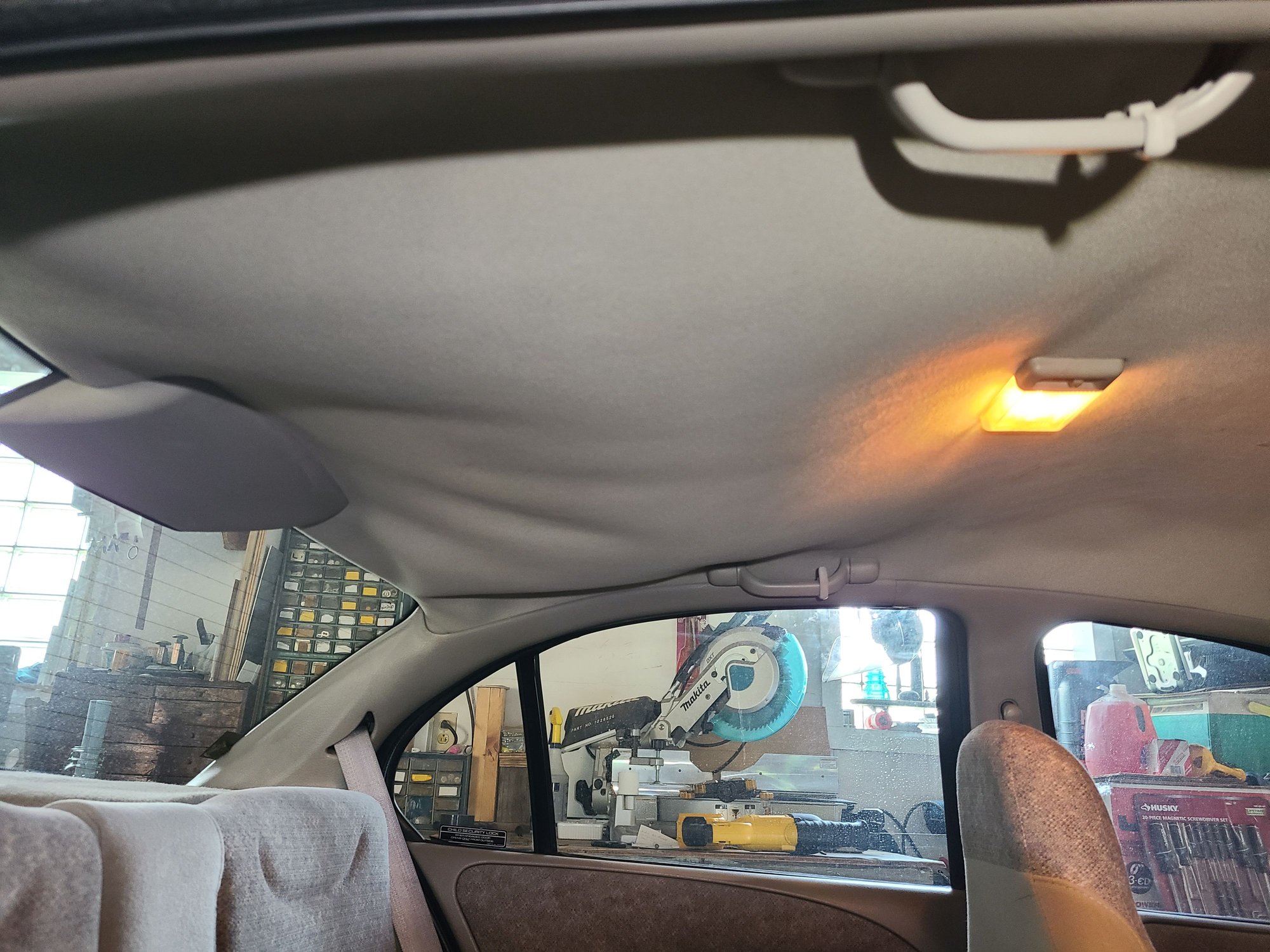

I'd like to share 2 pictures of the current state of my headliner, because I'm not sure exactly how to proceed. I was thinking of just using some spray adhesive on it without removing the headliner, but I'm also considering removing the whole thing and doing it outside of the vehicle for a more comprehensive and permanent fix. Do you have any thoughts or advice? As you can see most of the drooping is in the rear seating area, but its starting to occur in the front seating area as well:
I am thinking I'll remove the whole thing. What do you think? What would you do?

With that much material already detached, there is really no way getting around pulling the entire headliner panel and replacing all of the fabric.
As long as the glue from the original headliner is not petrified like mine was, you should be able to strip it off. The new fabric you put on actually has foam on the back and is specifically made for this purpose. It will tolerate small imperfections but anywhere the surface goes crazy uneven you will see through the fabric. Make sure the fabric that you cut is oversized so that it can be wrapped around the back and attached there as well.
We can discuss the rest of the process as well when the time comes. Basically you lay out the fabric, then fold it back, add adhesive to the back of the fabric and to the headliner board, let it tack up, then carefully starting from the middle mate the two together. Then do the other half
