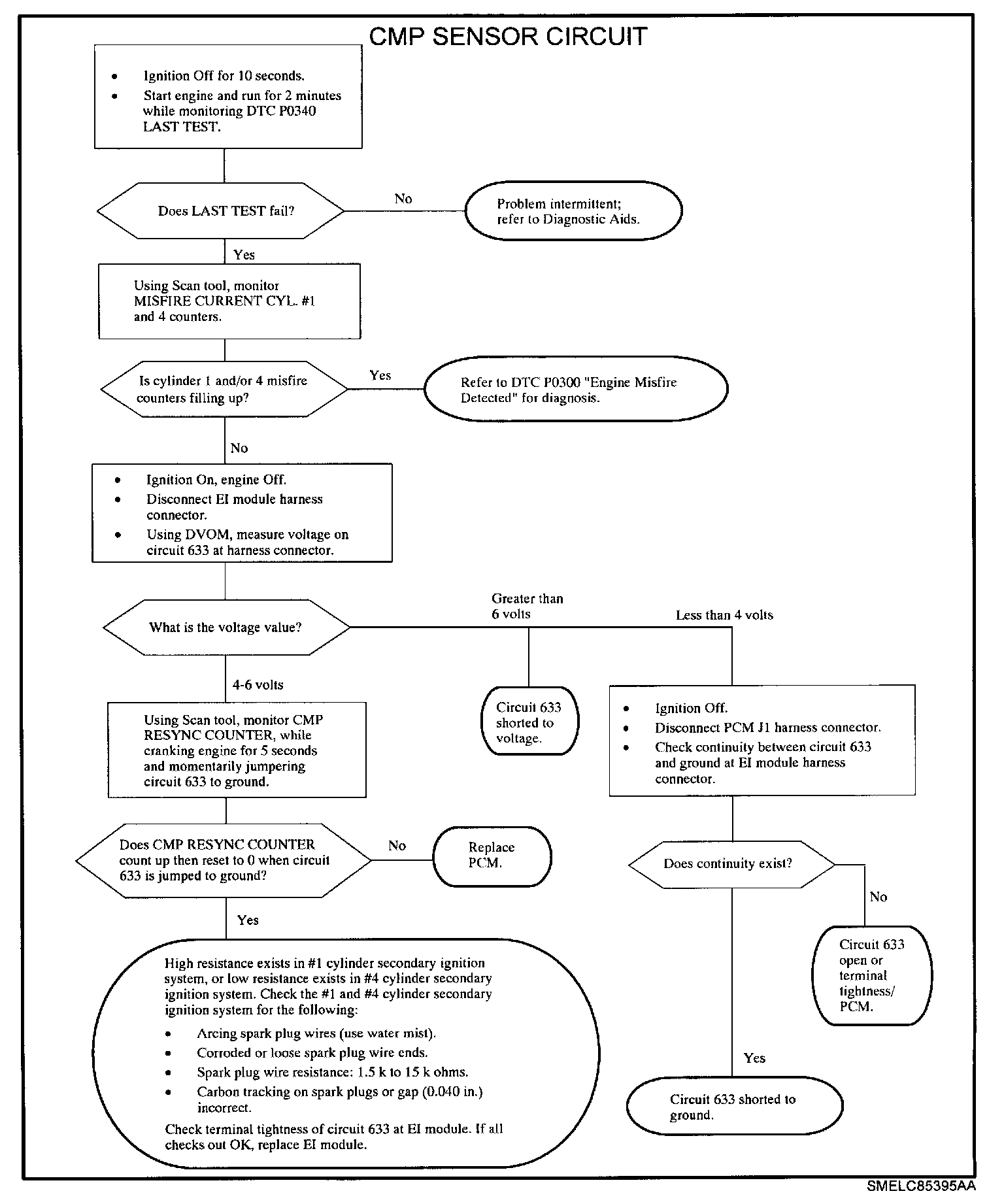

Diagnostic Chart:
https://charm.li/images/DM15Q313/gm130/201485948/

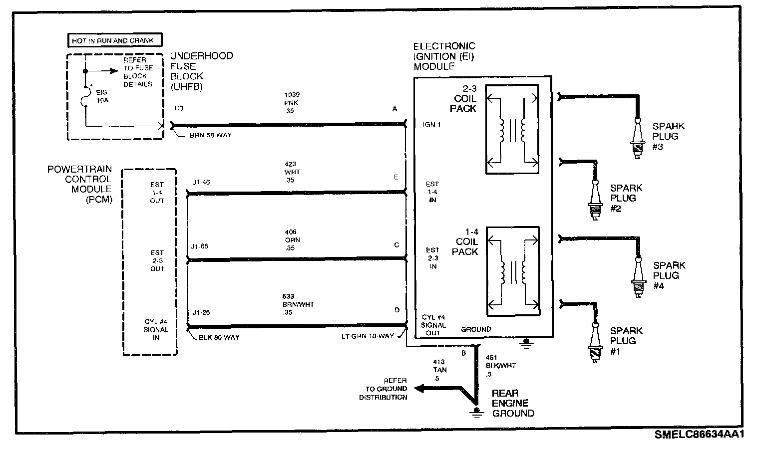

Schematic:
https://charm.li/images/DM15Q313/gm130/201504588/
The electronic ignition (EI) module supplies a ground to the cylinder #4 signal wire whenever it determines cylinder #4 has just fired on its compression stroke. The EI module uses capacitive pickup plates located under the 1/4 coil pack to determine the polarity sequence and voltage amplitude of the cylinder 1/4 secondary ignition. The PCM supplies 5 volts on the signal line and expects to see the cylinder #4 signal wire go low after every 14 crankshaft pulses (2 revolutions). This is used to determine the position of the camshaft, except under decel. The PCM only uses the transition from 5 to 0 volts as a valid TDC compression #4 cylinder signal. DTC P0340 sets when the PCM detects missing cam pulses (not seeing one cam pulse every two crankshaft revolutions).

DIAGNOSTIC AIDS
Use Scan tool to monitor CMP RESYNC COUNTER while running engine. The counter should count to 14, which indicates the number of notches passed on the crankshaft in 2 revolutions, then reset to zero when a cam pulse is received.
High resistance in the #1 secondary ignition system or low resistance in the #4 secondary ignition system can set this DTC. Check for corroded or loose #1 or #4 secondary ignition components. Use Scan tool to monitor MISFIRE CURRENT CYL. #1 and #4 which may point out an intermittent misfire causing the DTC.
A missing cam pulse without a cylinder misfire may not affect engine operation.
grcauto8453 Jun 10, 2025 12:04 PM
Misfires can cause the PCM to set the P0340 code. We need to verify codes and do some testing.
