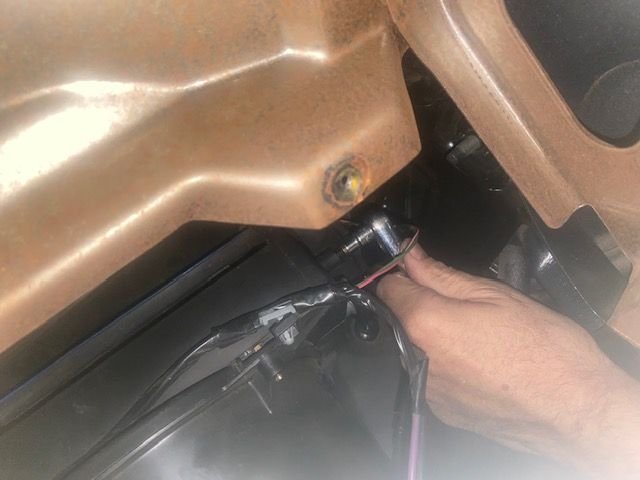

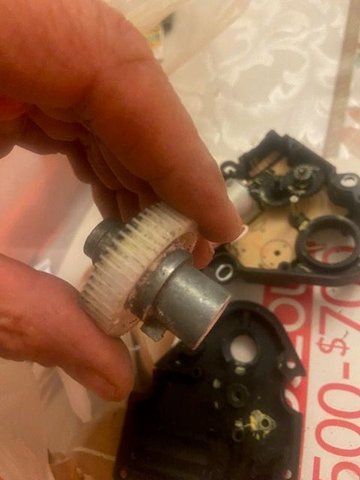

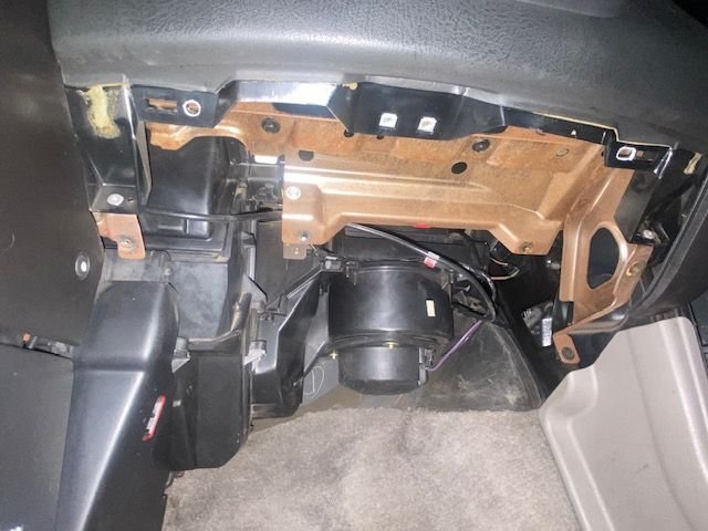

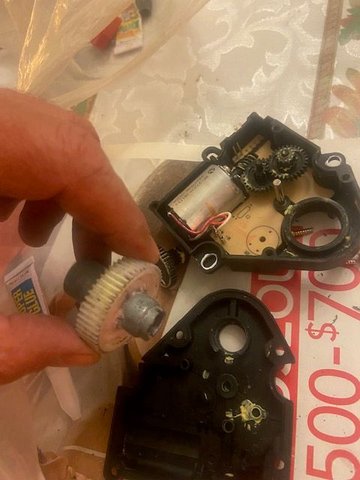

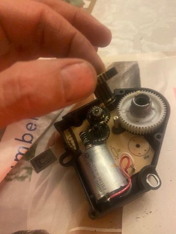

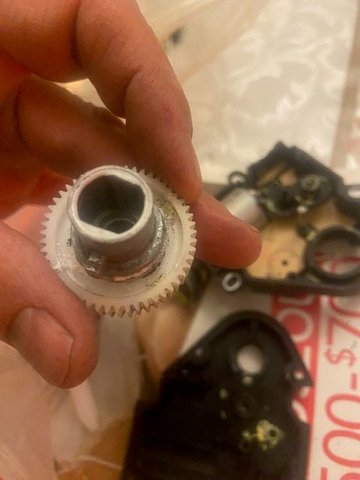

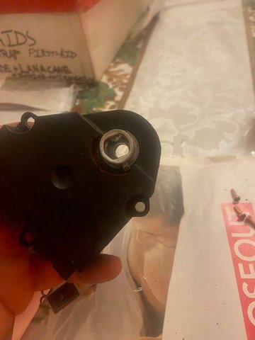

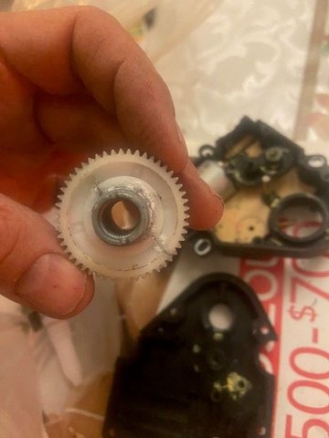

Hi just wanted to share I was able to fix my 98 Saturn SC2's AC Recirc/Fresh Air Actuator using Super Glue and then carefully sprinkled with Baking Soda to Wet Glue.
It's been over a year and it's still solid.

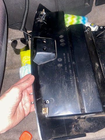

This is a common problem, the nylon sprocket cracks open. Then the actuator just makes a clicking noise, behind the glove box.
Be sure to round metal File enlarge the sprocket hole as needed slightly to make sure it doesn't fit on the metal shaft with too much tension/force which is what causes them to split in the first place.
Take care
