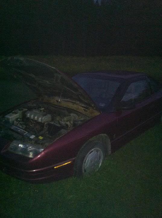

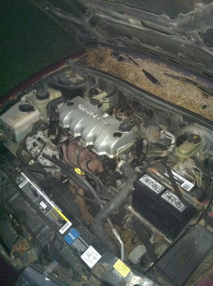

ok so im buying this car for 250...the only thing wrong is that there is a hole in rad and two pistons are not fireing... so name me some things off on what that could be please... its nice to be back

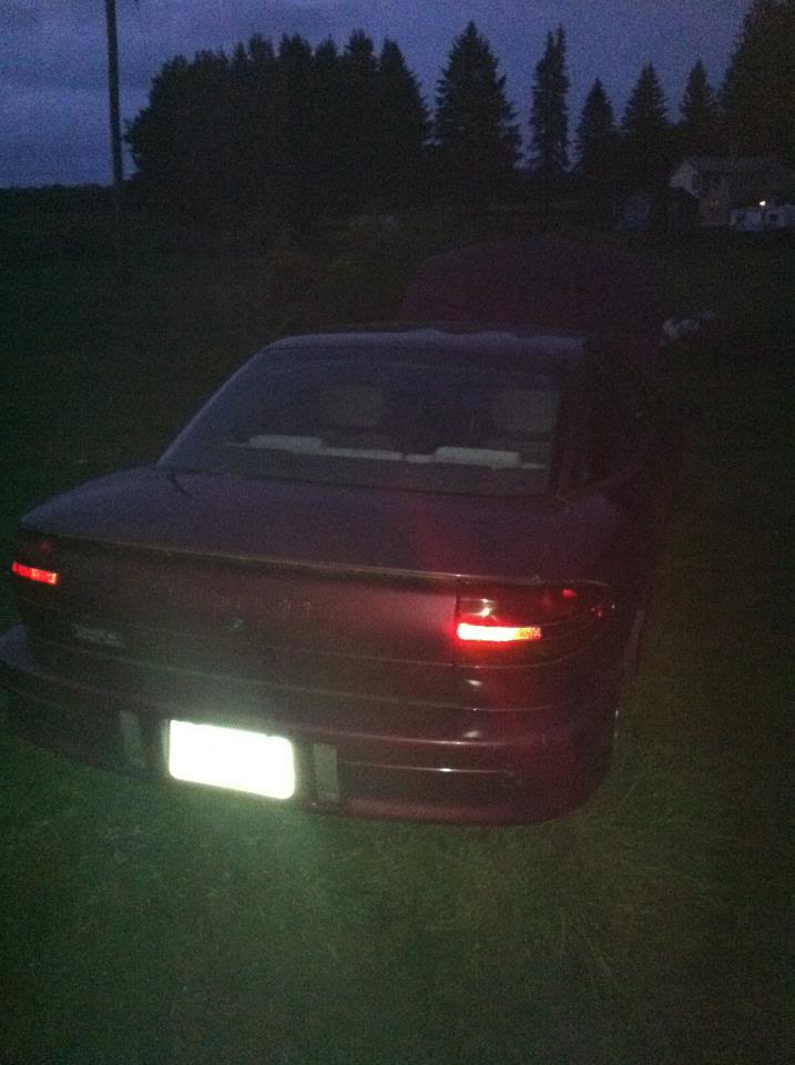

OceanArcher Sep 4, 2012 06:55 AM
I'm looking at the last picture and have to comment -- this belonged to some farmer who parked it in his field one Spring, and just found it again after cutting down all the wheat? Anyway, hook up your OBD diagnostic tool, and get us a reading on the failure codes ... post the actual numbers here, and we'll try to help.
Rubehayseed Sep 4, 2012 08:18 AM
Do what OA suggested first. I'd pull all four plugs and run a compression test on it too. Check for fire at all four plugs. It may be something as simple as bad plugs, wires or coil pack.

winkler91 Sep 4, 2012 11:02 AM
no not a farmer... lol he just drove it up the hill to his house when the two quit but coasted it into his back yard

OceanArcher Sep 4, 2012 12:04 PM
Before going any further, I'd clean out all the grass/hay from the engine bay and underneath -- would sure hate to have my $250 go up in smoke. By the way, where's the intake lines and breather box ??

winkler91 Sep 7, 2012 10:17 PM
figured out the major problem lol it is the CPS
