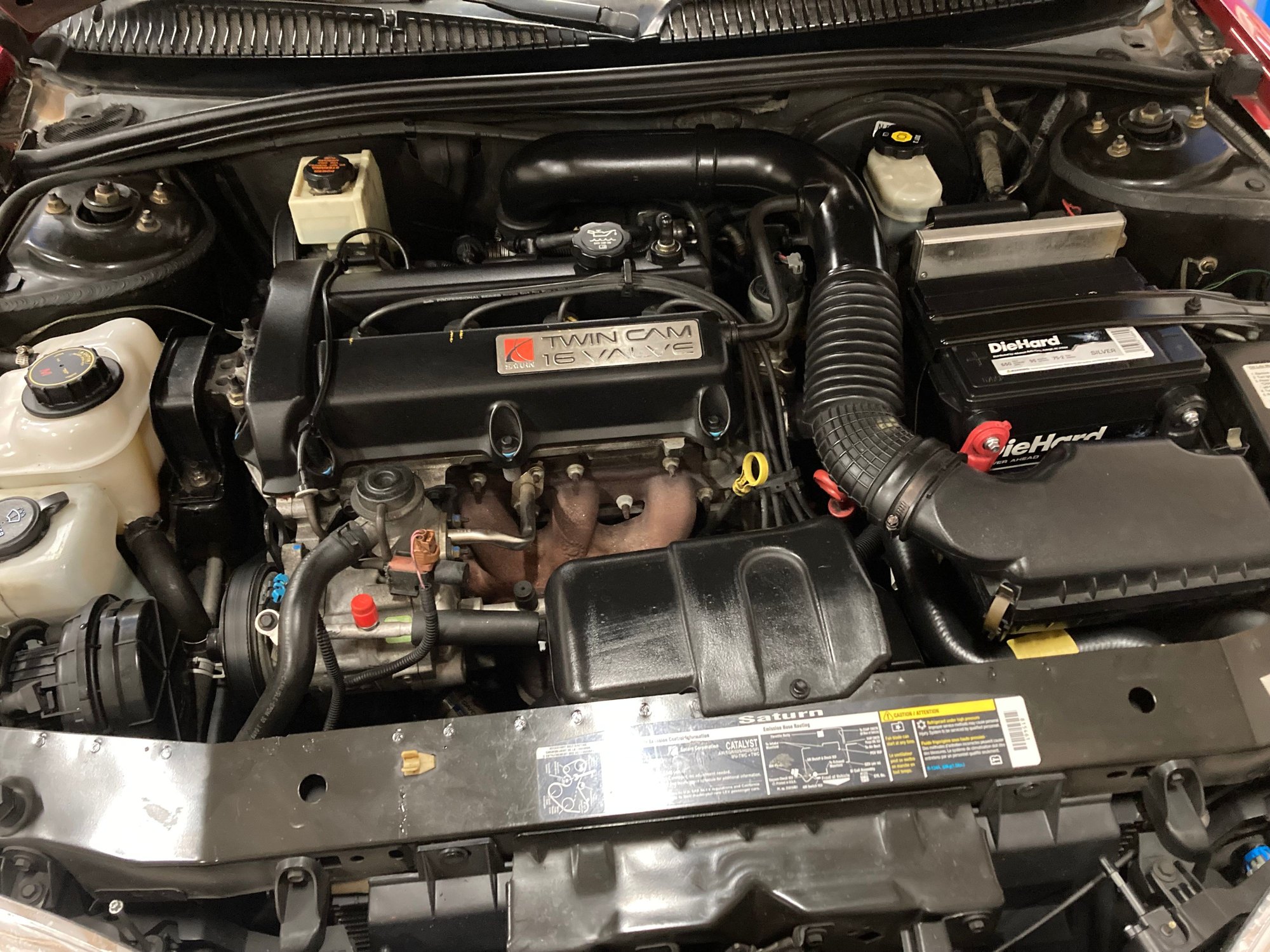

My wife's Saturn SC2, 232K, bought it new in '02. Recently, it has failed to start so I'm trying to diagnose the issue. Replaced the fuel filter and did find the input side of the old filter to have some rusty looking fuel come out when I dumped it out. Checked fuel pressure at the rail, 60 psi. Checked spark, good. Replaced the plugs, old plugs were nasty especially #s 3 and 4. I have yet to ohm out the coil packs but that is where I'm looking next. Once it does start, it runs well and restarts easily. Bore scoped each cylinder and noted nothing out of the ordinary for an engine this age, still has cross-hatch on the cylinder walls. Any advice will be greatly appreciated.

Coils test good. Cleaned up the coils and ICM, contacts and housings. Thought I would never get the bolts out as they were Loctited in place. Luckily the blue product. Wire brushed the bolts and chased the threaded holes with a tap. M6X1.0 in the event someone out there is interested. Reinstalled everything and then pulled the CPS. It tests open on the bench but will generate a few millivolts of current if I spin a bolt over it. I have parts coming but they will not arrive until tomorrow. Going to try the CPS first. Wiring to all this stuff is old looking as it is over twenty years old. Hope I don't get into replacing a harness!
