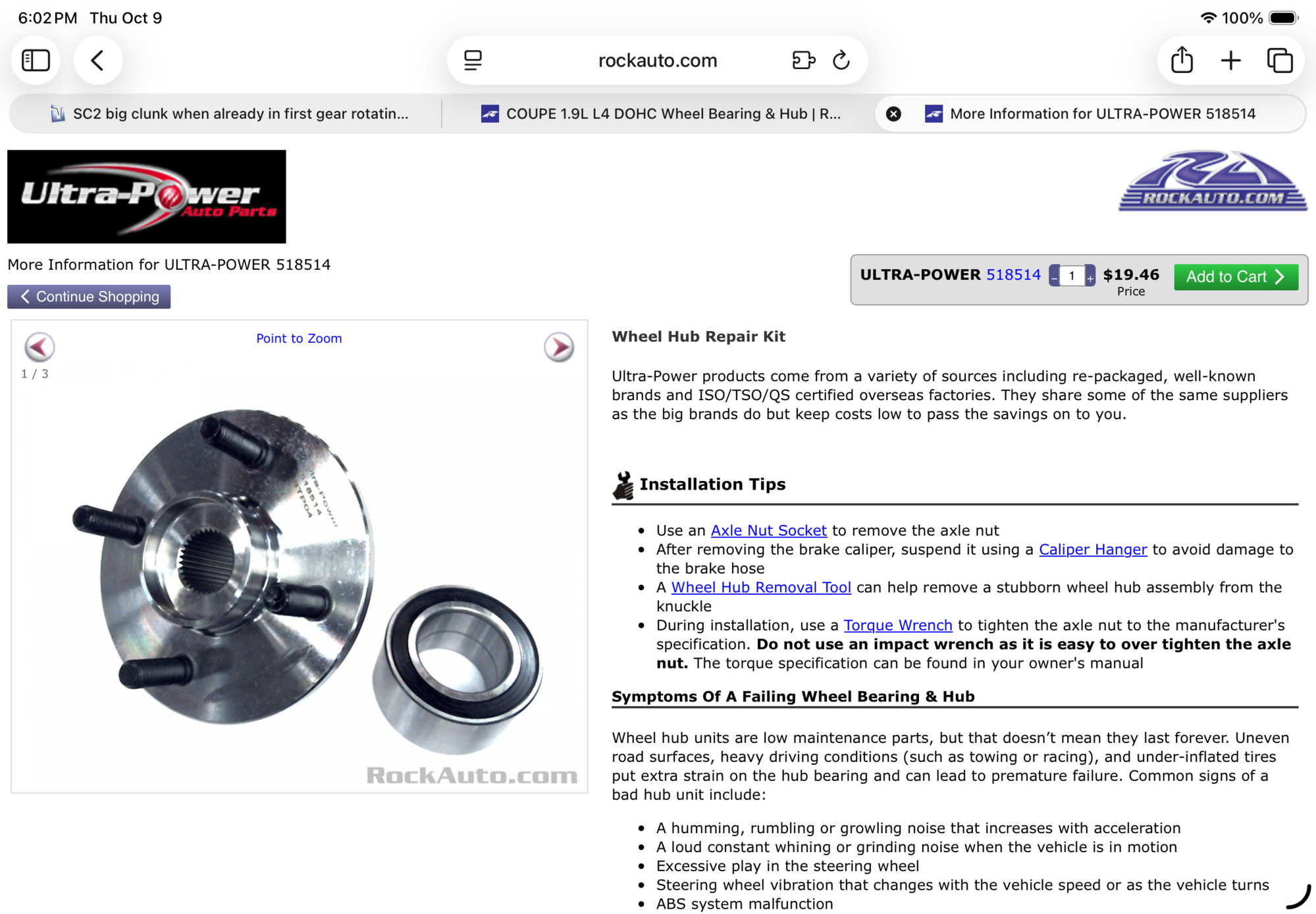

It seems to me that the right front wheel bearing and therefore the hub need to be replaced, as I do not have access to a press, even though I bought spare bearings 15 years ago for when they became impossible to find. If I can't find the hub I will go that route. It would seem based on the geometry of this suspension that you could have a bad wheel bearing and still have the tie rod and lower ball joints intact, but that's just me. I need someone to pull in the tire while I look at it to figure out what's what.

I bet that the front hub itself fractured between the bearings. Let me look at how it is setup. I had an Audi that had a hub fail 35+ years ago.
Old Oct 9, 2025 | 07:08 PM
My Audi had a similar setup, you can see the one piece outer race and the two separate inner races. My Audi spun on of the inner races and I had to replace both the hub and the bearing. That is what I would look at on your car, you may have also destroyed the knuckle. On my Lincoln the knuckle is aluminum and it seriously deformed in the accident. All the tapers stretched and the knuckle ended up with 2+” of toe out after replacing the bottom ball joint.
Old Oct 10, 2025 | 08:31 AM
It sounds to me like you found the issue, derf. I think if I were in your position, I'd replace the whole hub assembly. I was going to ask about the ball joints as I didn't see them on your list at first. But, you covered it thoroughly. I'm pretty sure that if you replace the hub assembly that you'll cure that problem. I'd come help you, but Reatha is having thyroid surgery on Monday and she needs me here. I DO have a large mirror I could send you if you really want it. It's 42" x 32". It came out of one of the bathrooms when I remodeled them a couple of years ago. Just let me know.
