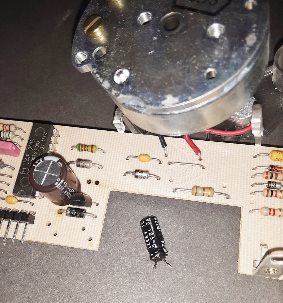

Cruise control works fine, so the VSS should be good. Gonna head to Pick a Part and see if I can grab a cluster out of that '94 SL they just got in. Maybe I can get a good speedo board out of it?

Bummer, someone already got the cluster. Was a 1998 next to it with the cluster, but it's far different. Oh well, take her apart again and see what's going on...

Literally, it took 30 minutes to remove the dash, the cluster, and disassemble it. At first, I couldn't see any burned spots, but then I unhooked the board from the speedo motor and there it is! Cap is shot, the same one the person in the other forum mentioned. I'm gonna hit a local electronics store to see if they have one, if not I'll order online. Fingers crossed!

It works! Got basically the same cap, but rated 50v instead of 63v. The rest were too big to fit in the space on the PCB. Soldered it in, put the cluster together, and drove the 3.3 miles I tried yesterday. It registered 3.3 up, and 3.3 back home. Now just have to put the dash back together and hope that's it for a while

I searched so many short zombie threads, most 10 -14 years old, here and elsewhere, describing the same problem after replacing the gears, but most never came back with a solution. One reply was that replacing the speedo board did it, then I found an old thread where the guy popped in years after the last response, and said this specific cap caused the problem several times on his Saturns, but no responses after that.
Maybe when the gears fail the stepper motor gets stuck, causing that cap to overheat? Obviously that cap is feeding the voltage to the odometer, so it failing would not affect the speedometer.
