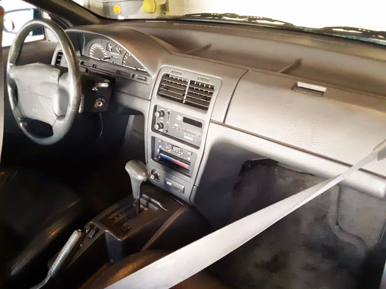

Epilogue:
Picked up a couple 2 packs each of #73 and #74 bulbs at Auto Zone while I was out working. Came back and tested all the bulbs. 3 were bad so I replaced those, and I put new bulbs in the turn signal positions. Put all the dash pieces back in place, and everything works as it should.
Thanks again guys for the assistance, AND for the motivation to take it on!
Old Aug 3, 2019 | 07:28 AM
  #25
That interior shot sure reminds me of the gold SC2 that I had. Thanks.
