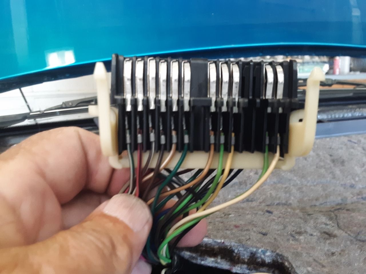

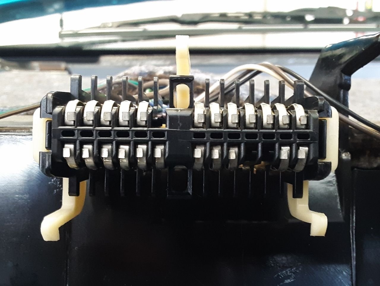

As you can see, the main connector doesn't have pins, it just has contacts that touch the conductive strips on the film. I cleaned all of the contacts on the plug and the film with Q-tips soaked with electrical cleaner. Still nothing. Looks like the odo traces come off the speedo traces, and the tach comes directly from the plug. The outside upper and lower main plug contacts are the tach, and with the engine running I get a constant 3.3v no matter how fast the engine is reving. The inside upper and lower contacts go to the speedo, and read 12.9v constant. Doesn't look like any cold solders, can't find any wire breaks, and no burnt spots on the inside components. BTW the lower left solders are the tach connection, the middle solders the odo connection, and the right is speedo. I checked continuity between the solders and contact strips of the receptacle, and it seems good.

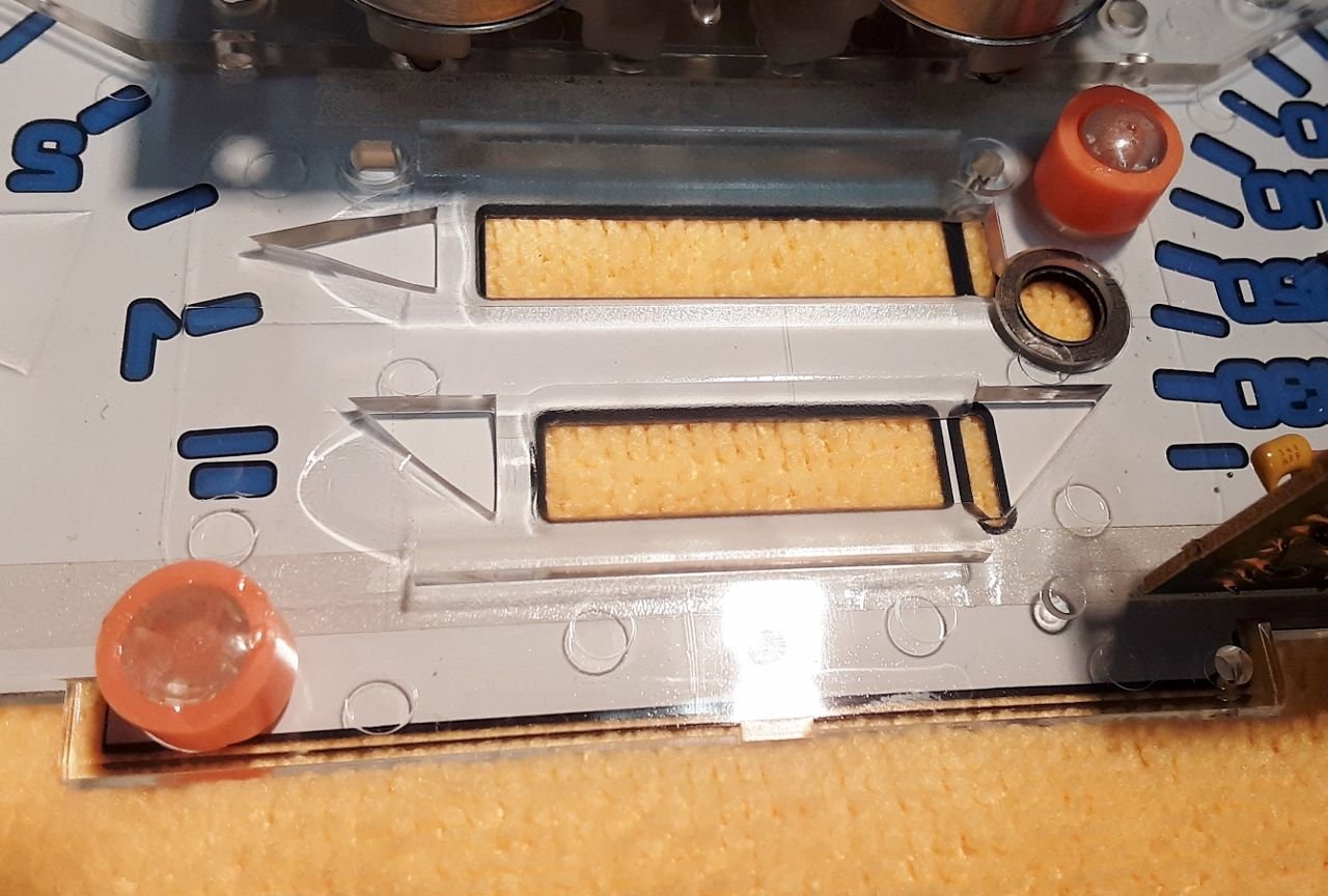

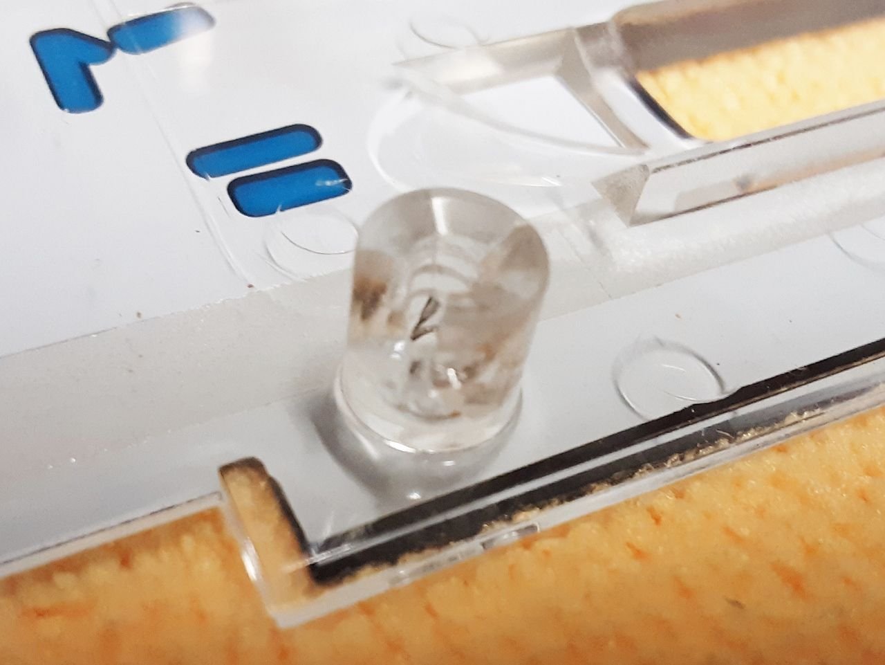

Here's what I'm doing to fix the two odo mounts. First pic shows the bottom one missing a piece, the upper on just cracked a bit. I cut pieces from a rubber smoothie straw I had that just fits around the mounts, filled it with 2-part clear JB Weld "plastic weld". Let it set an hour, it shrunk in, so I topped it off and will let this harden for a while. Then drill new holes and put some lithium grease on the screws when I install the odo. Hope it works!

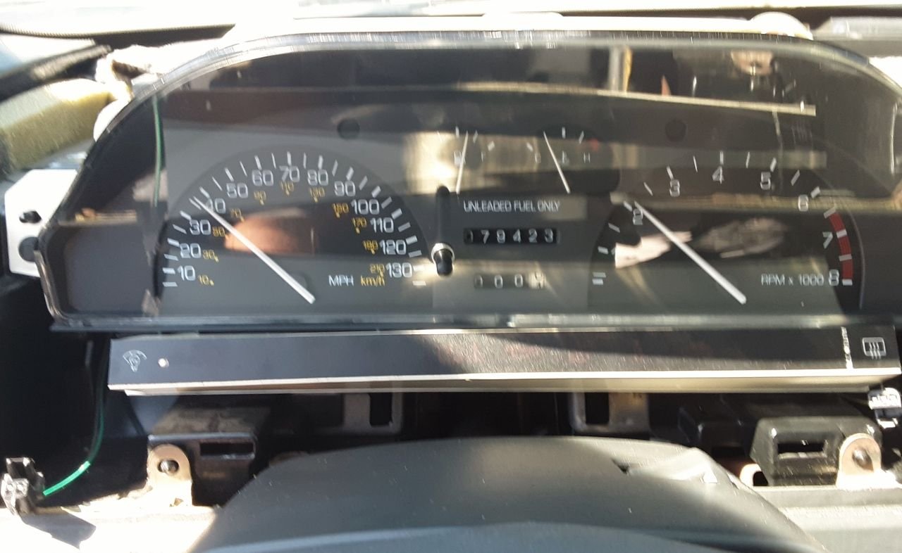

ODOMETER WORKS!!!
The rebuilding of the odo mounts with epoxy didn't work, so I removed them, drilled through the IP faceplate, and put nylon screws in. Used a couple nuts on the backside as spacers, but turns out it was too close to the faceplate and the gears were slightly rubbing, causing the hesitation. Now I have a 1/4" nylon spacer and thin nylon washer, and it works!
BTW the nylon screw heads on the faceplate don't show when it's all together. The front IP lens assembly covers them.
Still need to get some new bulbs before closing her up, but am SO happy to have it all working again
