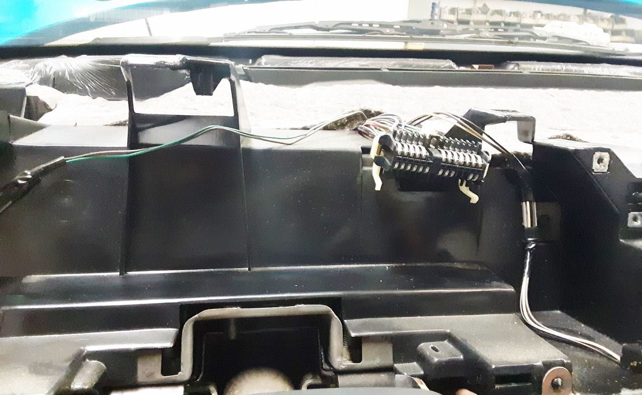

Got the dash off and cluster out this morning. No issues. However when I removed the cluster the connection was loose and pulled out by itself, so apparently it's never been properly seated. You can see in one of the pics from the top after I removed the dash cover, it's at an angle. So thinking this was what caused the tach to stop, I seated it and started the engine, but still no tach. BTW the three hook legs that secure it are not broken, they just were not engaged well.
I see one white wire at the bottom left of the plug, perhaps the tach. How would I check to see if it's getting signal? Is it variable voltage I'm checking for?

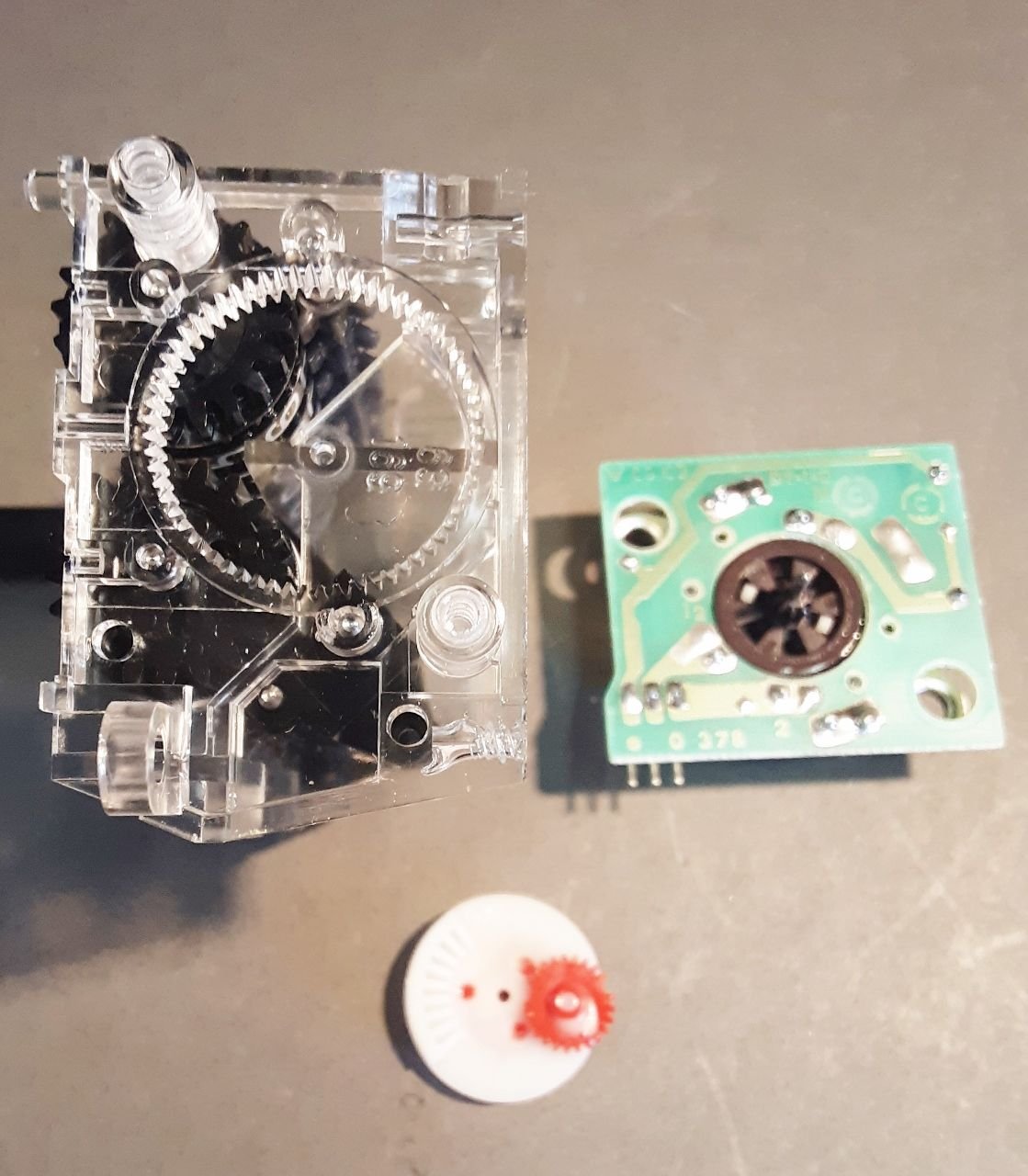

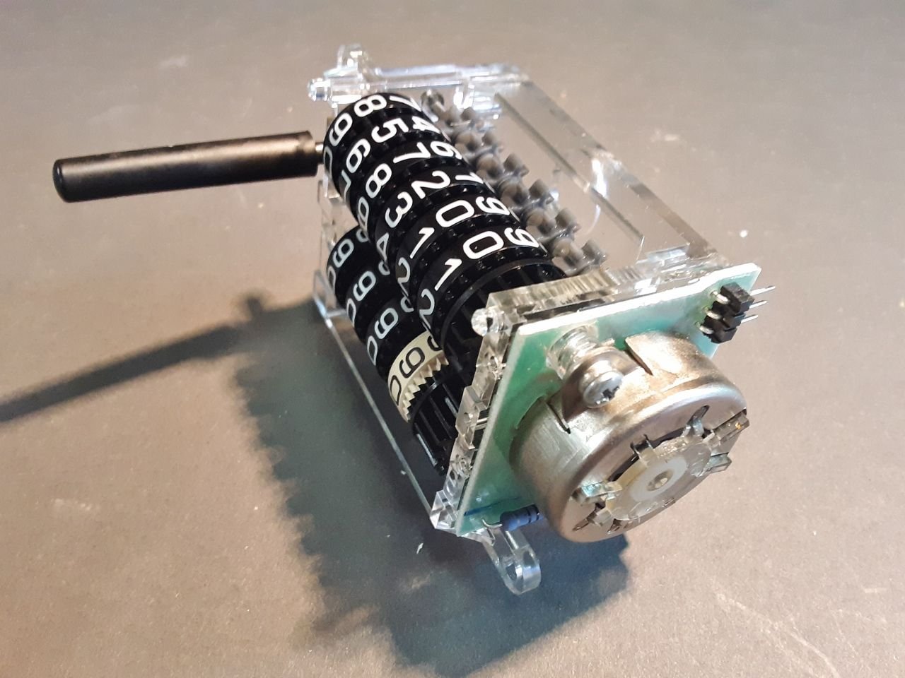

Got the housing apart. Not easy, having 10 snaps, and make sure you get ALL the black screws out. I missed 2 on each end, but luckily didn't hurt anything prying before I noticed them. PATIENCE is the key. Also as you work around freeing the tabs, insert a folded business card or similar to keep to gap open as you work on other tabs. Prying the face plate out is easy, just be careful and go slow.
Have the odo pod removed and removed the motor, and yep, the red gear is shot. Funny thing, a minute after I finished this the mailman showed up with the new gears
So I'll put it all back together, clean up the contacts on those small black connectors that power the odo, tach and speedo, then see if the tach works now. If so, I'll re-install the dash etc. If not, I'll have to troubleshoot some more.
