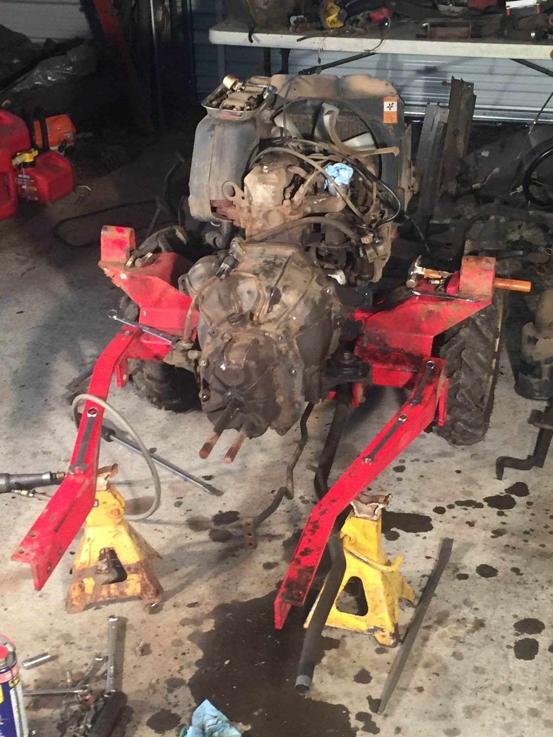

I have a 1995 Massey Ferguson 1210 4x4 compact tractor and the original clutch is finally out of adjustment. Which means I have free pedal and the cluch slips so it is time for some major repair. You think replacing a clutch in a car ia a pain you should work on tractors. The engine is structural in a tractor they do not have a frame like a truck. To replace the clutch you have to split the tractor. My little tractor has a front end loader so there is a frame that comes with the loader to transfer load to the complete tractor. Here are a few pictures of where I am now, I am still removing the bellhousing. I have a nice shop but no heat and we got our first snow of the winter last night.

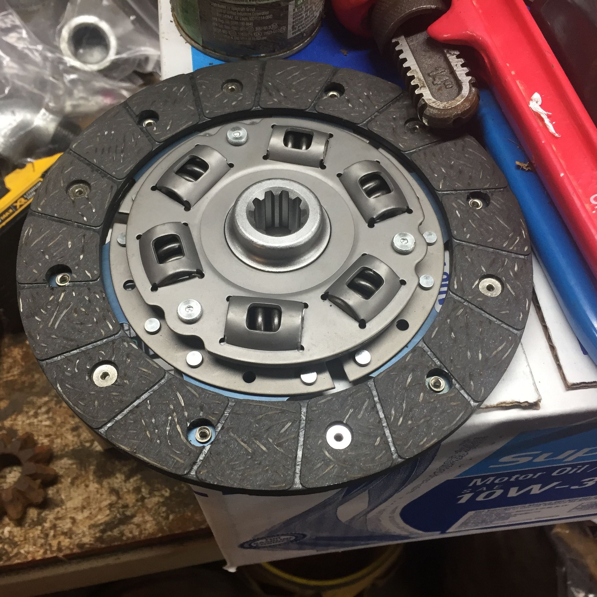

Now that I have the bellhousing off I have discovered that I purchased the incorrect clutch disc. See the above picture for the incorrect clutch! My Massey Ferguson 1210 has 13 splines not 10 splines. The clutch is only 7 and 1/4” od but it looks like a 20 lb flywheel maybe more. The tractor is only an 18 hp 3 cylinder Diesel NA. The local tractor repair shop and wrecking yard will send my disc to the clutch shop in Portland for a reline. Under $100 and back in business. Done for today it is cold in the shop and we have a nice fire going in the wood stove in the house.

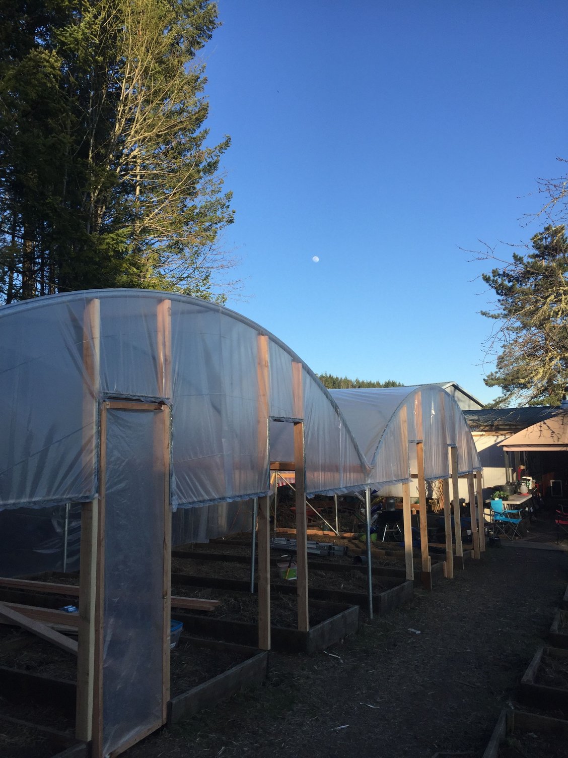

The last two weekends have been this project. It is 15x40 and I still need to finish. Today I got the plastic secured. It is over 6 raised beds and will allow a longer growing season.
