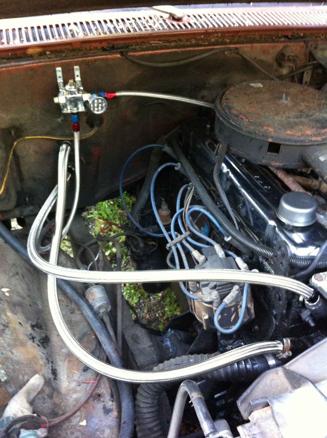

I will start with my Dad's former welding rig; a 1982 Chevy C20 that I call Putter Project. My Dad started his own welding business back in 1982. His 1st welding rig setup was a 1953 Ford F-250 with the original 239 flathead; paired with a rebuilt 1954 Lincoln SA-200 Pipeliner welder. In 1990; when the flathead finally gave-in to multiple cracks in the block; he replaced that rig with a 1973 F-350 with a C6 and 360FE. That truck with the C6 was a pig and he ran that for a few years before getting the '82 C20. He bought the C20 from a friend who also hooked him up with another 1973 F-350 4x4; with a 390FE and a 4-speed. The '82 C20 has a 292 inline 6 and a 3-speed. My Dad ran that truck all the way up until 2010 when he had a major stroke. Before he had the stroke; he had already bought a 2001 Ford F-250 utility body and a 1967 Lincoln SA-200 welder to replace the '54 SA-200 and the C20. He was going to junk the C20 as it had over 500k miles at that point. I intervened and agreed to pay for maintenance and insurance for it as a work truck and weekend toy. It was this truck that I used to cut my teeth with the other projects. I did my 1st front suspension rebuild on this truck (it's 2WD). And a year later; I replaced the fuel system as well. I had learned how to assemble AN hose assemblies at the end of college (I was very bored at that point) and decided to try it out. Immediately afterwards; I did a full exhaust on it with Pacesetter headers and a 3" single exhaust that consists of a Summit single inlet/dual outlet muffler. Since that was fairly loud; I installed 2 x 2.5" glasspacks behind it; and it quieted it down a little. I would take this truck to work in the bad weather as I installed some used 34" Interco Super Swampers on American Racing Baja wheels. Somewhere in between 2013 and 2014 it started missing and I got a wiff of exhaust fumes in the radiator. I concluded that the head gasket was on its way out and parked it for shorter trips to the landfill (other side of town) and Home Depot. I spent most of my time since on the other projects. Most of my pictures with this truck are held prisoner on Photobucket; and I only have 1 picture of the 292 on my computer. So here it is

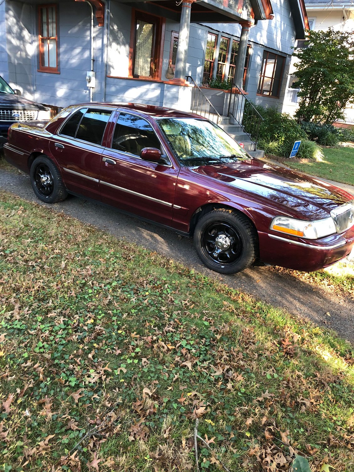

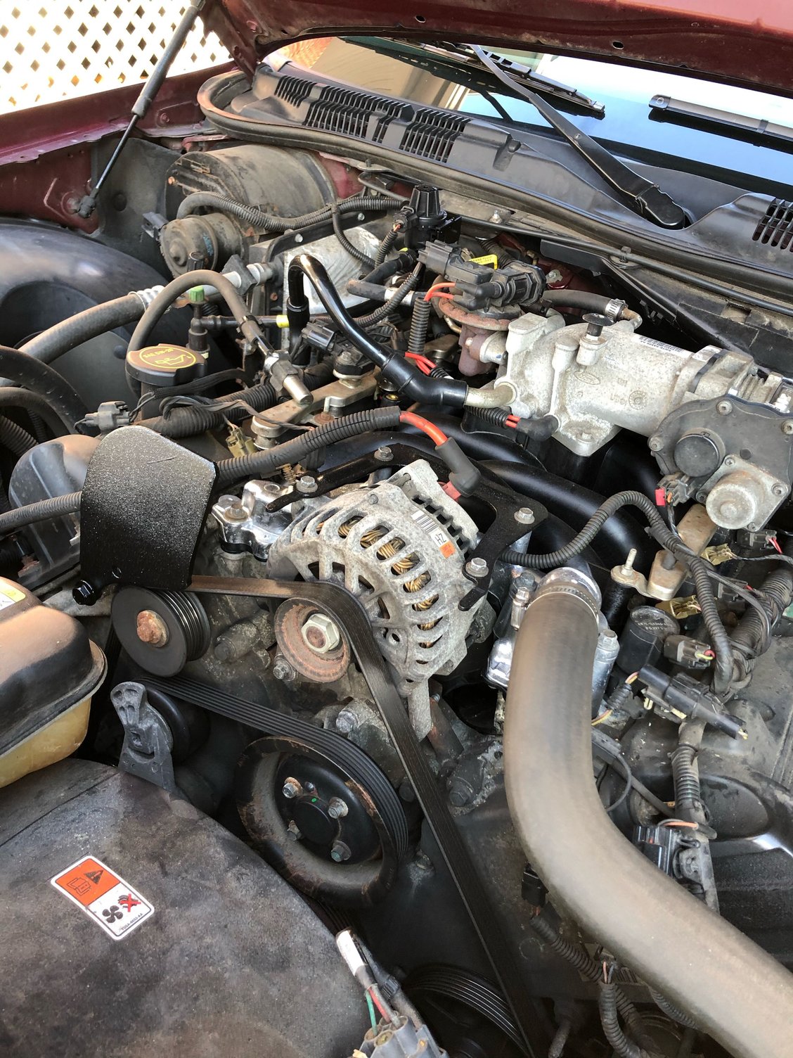

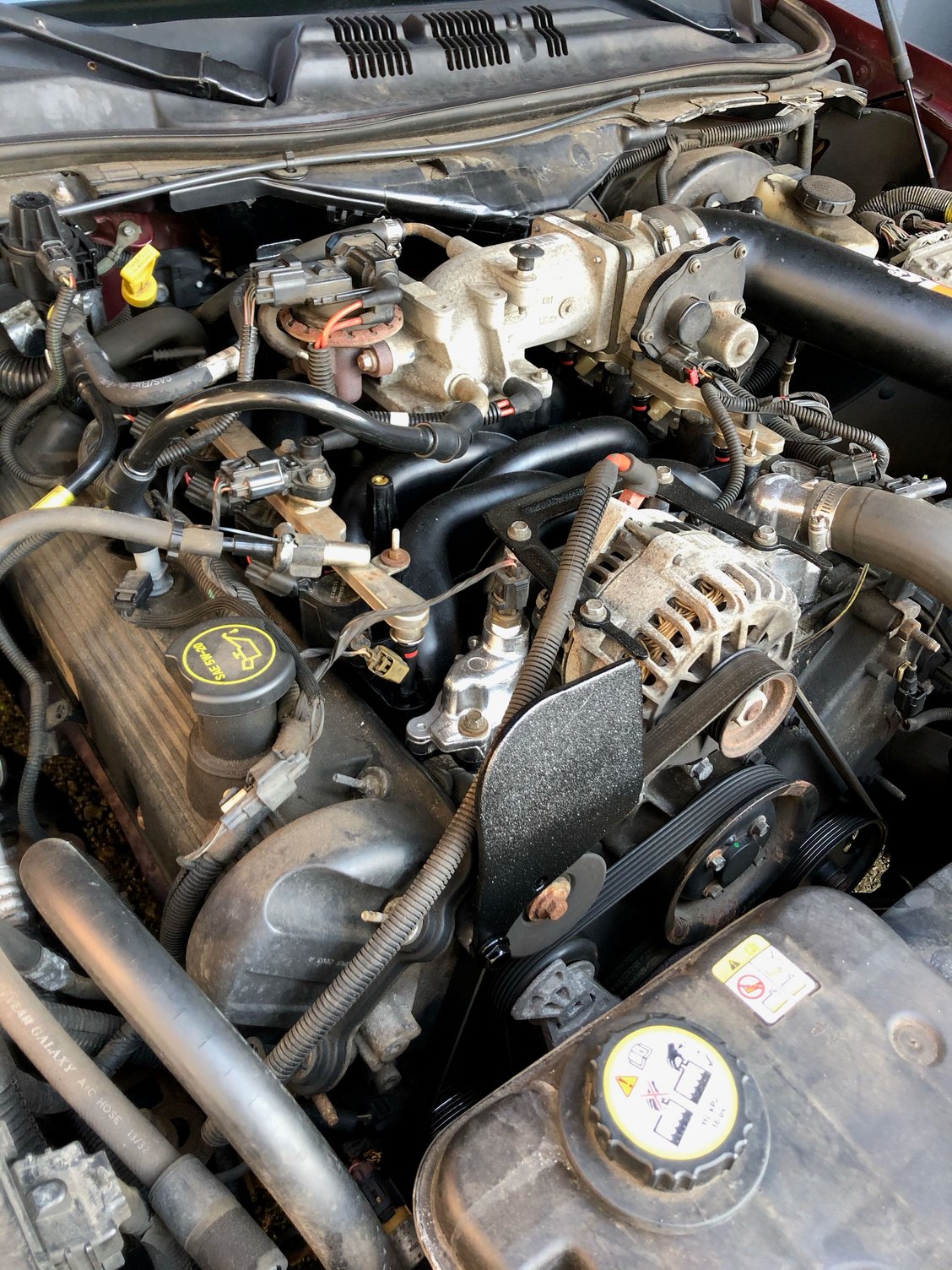

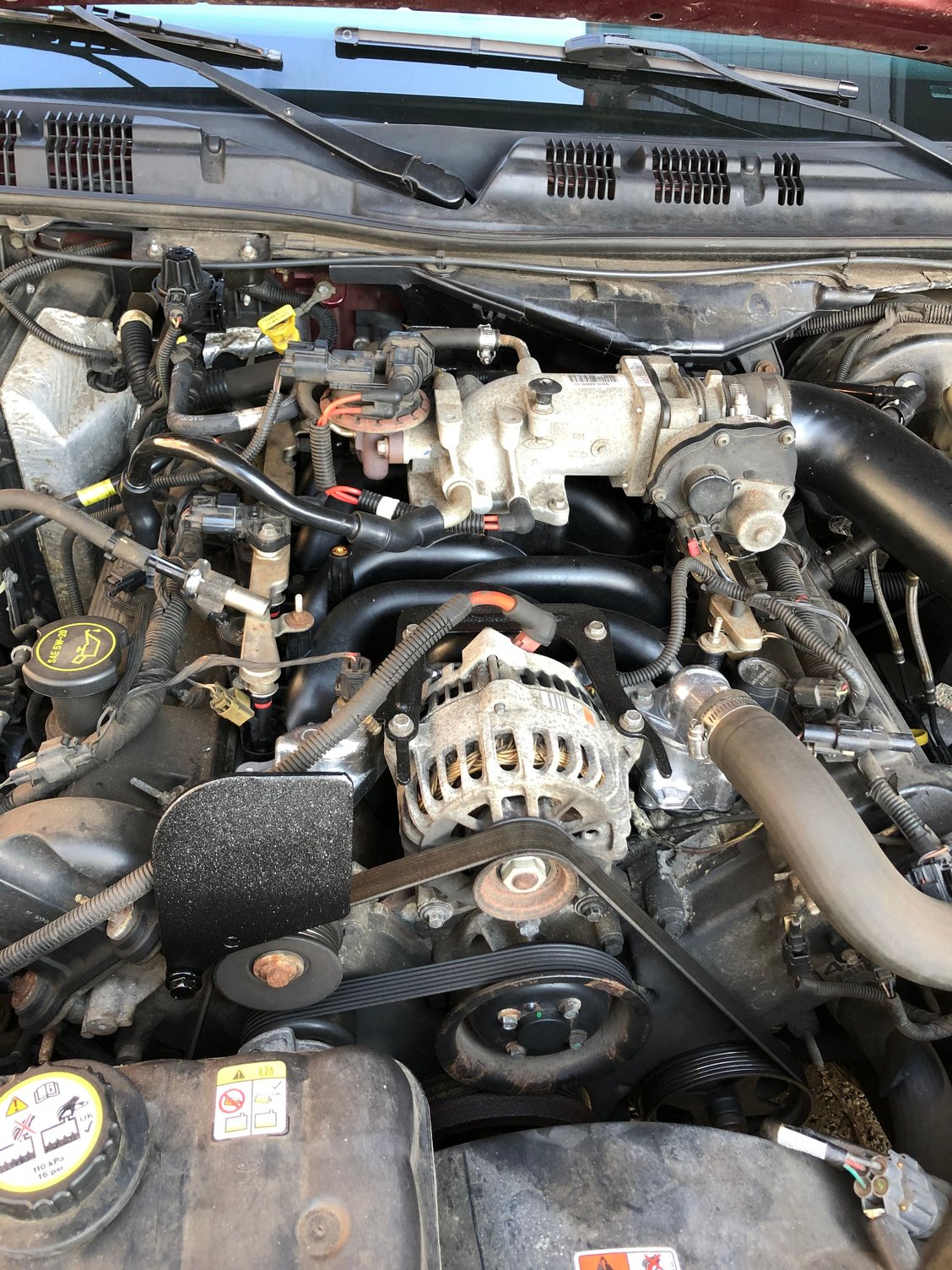

I got my 2005 Grand Marquis in 2016 when I blew the head gasket on the 4.0L in my 1991 Ford Ranger. Since that truck had too much damage by previous owners; I patched it up so I could look for another car. When I got the Mercury; I gave the Ranger to my Mom so I could take her Crown Vic off the road for the rebuild (more on that later). I bought my Grand Marquis with 70k on the odometer. It was owned by a retired police Captain who used it for both business and personal. I just don't get why anybody would get a base model Mercury and not get a base model Crown Vic; or at least a P71; but whatever. My first mod was replacing the sway bars with ADTR units. I pulled the P71 wheels I had on the Crown Vic and ran them on the Mercury for a couple years before switching back to the wheels/tires it came with. Then last October I switched them out for 2015 Explorer wheels that were intended to go on the Crown Vic. I had to open the center bores up to 2.79" to fit on the front hub and rear axle. I like them; but they have Blizzak snow tires on them; and I will have to switch them out in the Spring (found out the hard way that I can't run winter tires in the summer). I'm still up in the air about what I will replace them with. On Thanksgiving weekend; I replaced the plastic intake manifold as that developed a crack by the T-stat housing. I also used that time to paint the EGR valve bracket and metal heat shields on the 4.6; a subtle improvement in appearance. The car runs a lot smoother now. I also started on my dual exhaust project around the same time. I had gotten a left-side tailpipe assembly from the junkyard a couple years ago to use as a template to build a larger 2.5" tailpipe. Since the passenger side of that P71 was ripped up; I decided to cut off the passenger side tailpipe on my Mercury to use as the other template. This I did in December and have mocked up the tailpipes in the basement. The mufflers are 2.5" Dynomax Super Turbos with the 25" case. I was going to run these on the Crown Vic; but I miscalculated the length of that exhaust and could not run them on that car. When I clear other parts out of the basement; I will acquire the rest of the exhaust which will be a Pypes X-pipe with built in cutouts and Stainless Works long tube headers. I wasn't going to do this originally and was going to do a more budget friendly single 3" exhaust with BBK Mustang shorties, cats (I was going to run 2 x 3" cats), a 3" cutout, a 3" version of the Dynomax muffler, and 3" piping. But these former CV mufflers changed all that. Almost forgot to mention that I installed a K&N CAI that I was going to use for the Crown Vic; but later supplanted it with a custom CAI with 4" PVC for the Crown Vic.
Pics......

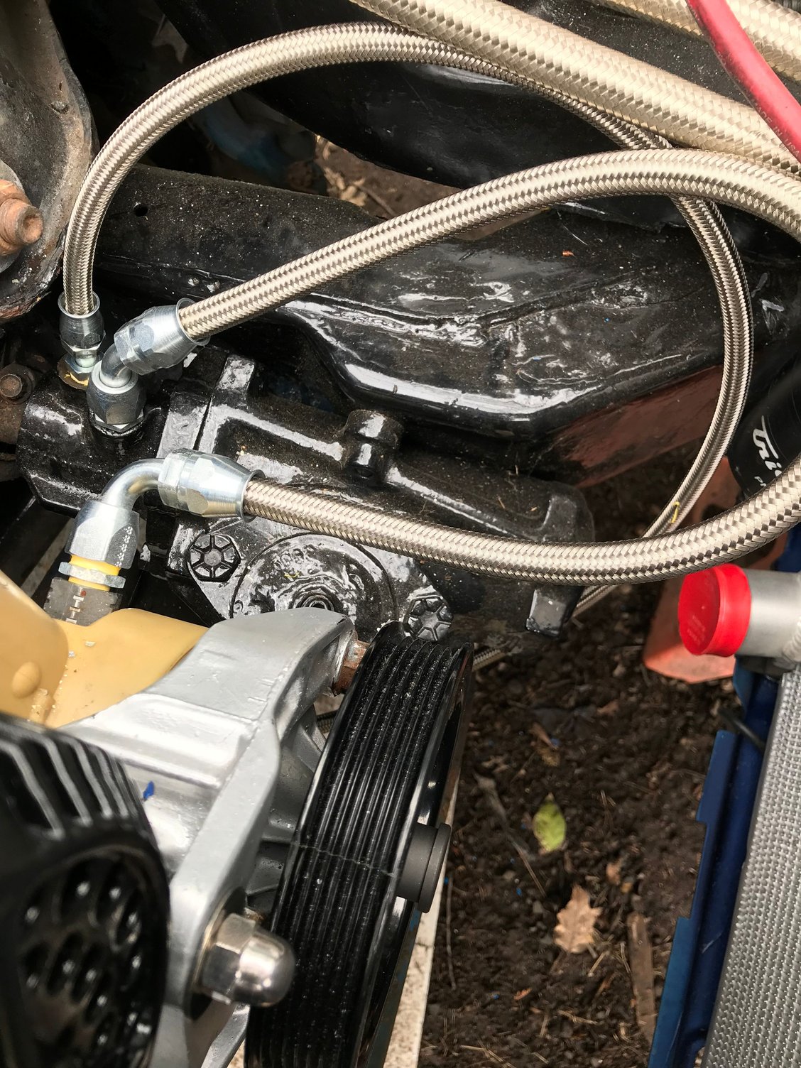

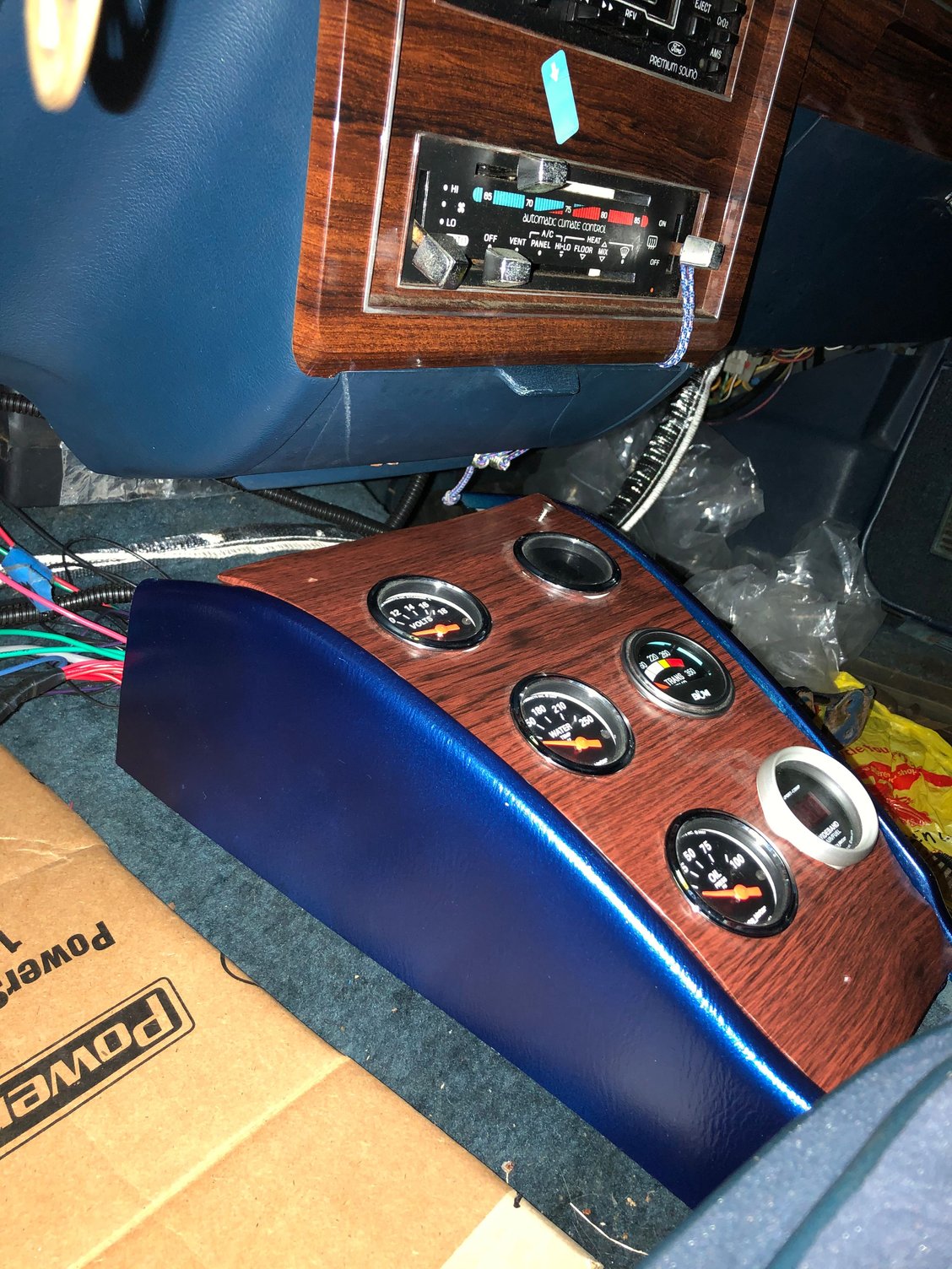

The Crown Vic Build

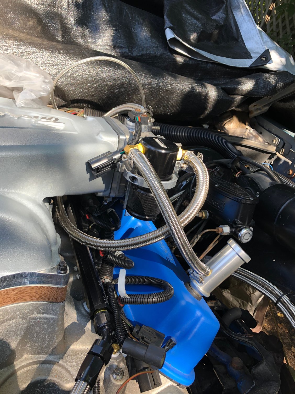

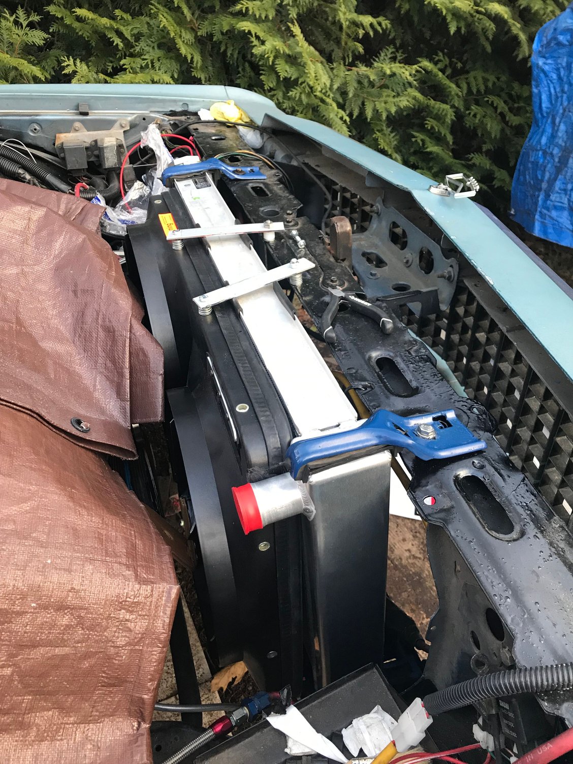

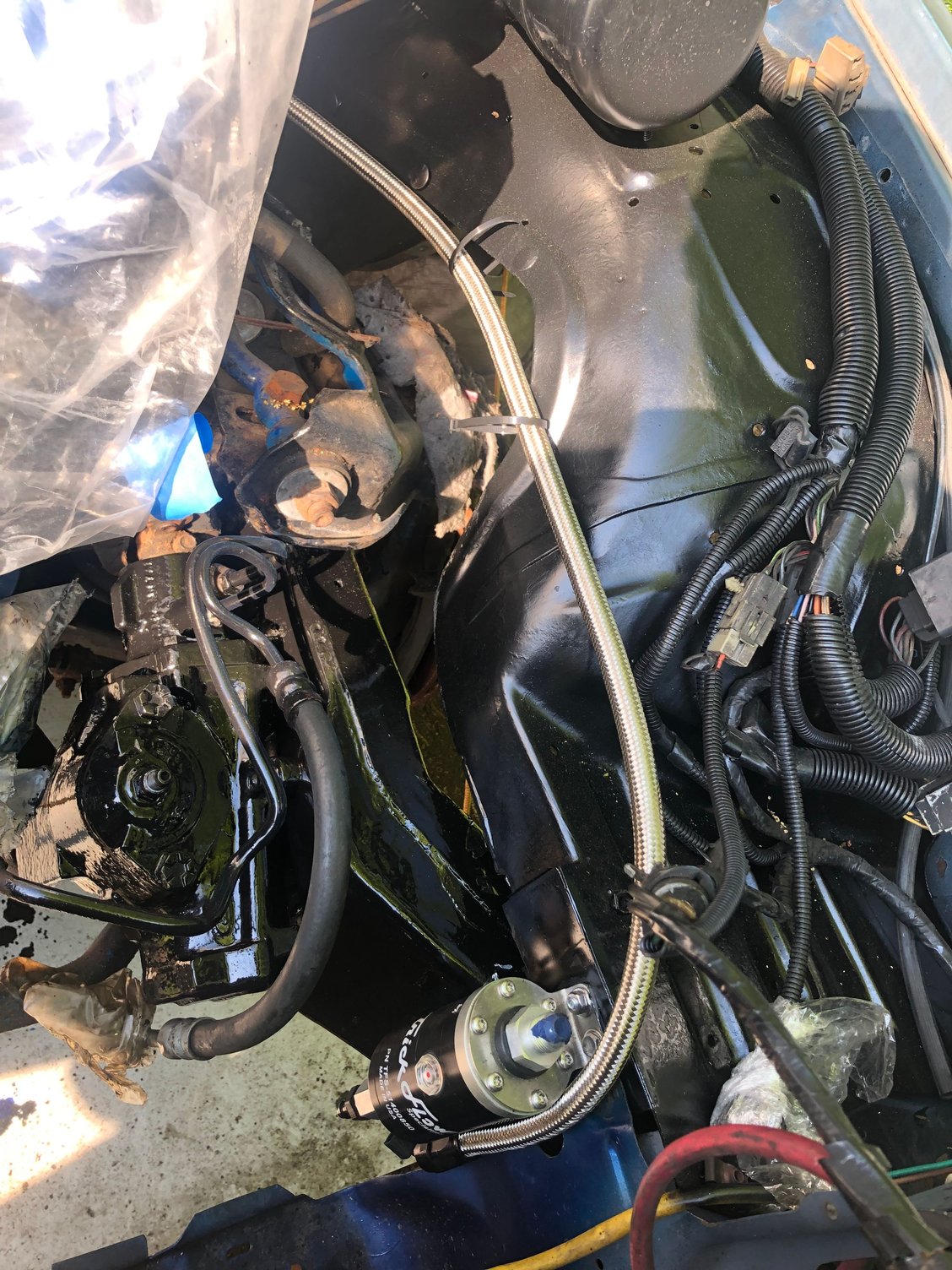

I pulled the 5.0 and AOD out the following September. At this point, it was no longer a pull and replace deal; as I had already decided to do a mostly aftermarket build with the CV; only thing that's stock are the block, crank, and rods. And in 2016, my job was really starting to consume A LOT of time. So the progress was slow. I cleaned the engine bay and started to plan wiring routes. In the Spring of 2017, I disassembled the 351W and was trying to convince my Dad to let me build it in the basement; but he said no. I was annoyed at the time; but I realized that I had a hard time maneuvering a full built rear axle out of there; and a 500# engine would be far more difficult to get out of there. So I sent it off to a local speed shop to be rebuilt. Because of work; I woukldn't be ready to retrieve the engine until the Spring of 2019; a full year after they finished rebuilding it. During that down-time; I asked that they paint the block Ford blue. Before all of that; I pulled the brackets and anything else that was useful off of the 5.0 and AOD and sent it off the junkyard at the request of the township (instigated by my neighbors). I cleaned and painted the brackets to be reused. I noticed with the empty engine bay; that there was a lot more oil that needed to be cleaned. So I pulled the engine mounts and cleaned the frame and X-member. This ballooned to cleaning and painting the rest of the frame back to the rear bumper. I noticed that there were a number of dirty severed wires that look to have been that way for a while. I decided at that point to install the MSD 6AL inside the defunct glove box. When routing the wiring for that I noticed that the main harness was looking rough. So I pulled the harness and realized that a number of connectors had been broken. So I rebuilt the harness on the kitchen table. When I reinstalled the harness I found other things that were missing or not made functional; such as the fuel vapor solenoid; which was one of the severed connections that I discovered. I took it apart; cleaned and painted the bracket; and replaced the solenoid and its connector. I noticed during that process the remnants of a metal battery tray. I had always thought that it was part of the plastic fender. So I took the evap canister down and grinded the rest of the metal off; cleaned and painted that area; and installed a metal universal battery tray. Then I started the plumbing. I got a gas tank and a Specter fuel pump to modify. I fitted a Holley 255lph pump in place of the larger stock fuel pump. I stepped the both the supply and return lines of the fuel system up to a combination of -8AN hose and 1/2" aluminum tubing. I modified the stock fuel filter housing to hold a TFS fuel filter. I ran 1/4" tubing to the evap canister and stepped that up to -6AN to the intake manifold. I knew I wanted/needed to run gauges; but didn't have anywhere to put them. So I got a center console from a 1994 Subaru and made a gauge mount from that and a piece of aluminum sheeting. Since I was also planning on running an electric fan; I realized that I needed an auxiliary fuse box. So I got a Painless fuse block and installed it under the dash. All of the added accessories run off of that fuse block. This further necessitated the need for an organized power supply. So I bought a bus bar and cleared the passenger fender of useless things like the EGR solenoids. When I got the engine back; I had much difficulty fitting it into the engine bay because of the aftermarket heads and the Ford Racing valve covers. The valve covers were for carb'd applications running a shaft rockers assembly; so they were very tall. So much so that they hit the wiper motor and smashed it during the install. After removing the wiper motor; I still couldn't get the engine in position; so I cut sections of the wiper motor box to get the engine to fit. I should have gotten different valve covers instead of doing that, but I liked the way the Ford Racing covers looked with the painted engine block. This caused me to thoroughly clean and paint the inner fenders. Then last year when COVID-19 became a thing; I found myself having reduced hours at work and more time to work on the CV. And that is where all of the little things started getting done. And they are many little things that have become very time consuming. Just got done plumbing the power steering pump and currently fitting a Flex-a-Lite 295 fan to a universal BeCool radiator. When we thaw out a bit; I will get right on that. Afterwards it's fitting and plumbing the trans cooler; and wire up the fan controller. Then I will check the car over a dozen or so times before the 1st start. I will post the progress as it happens.........
