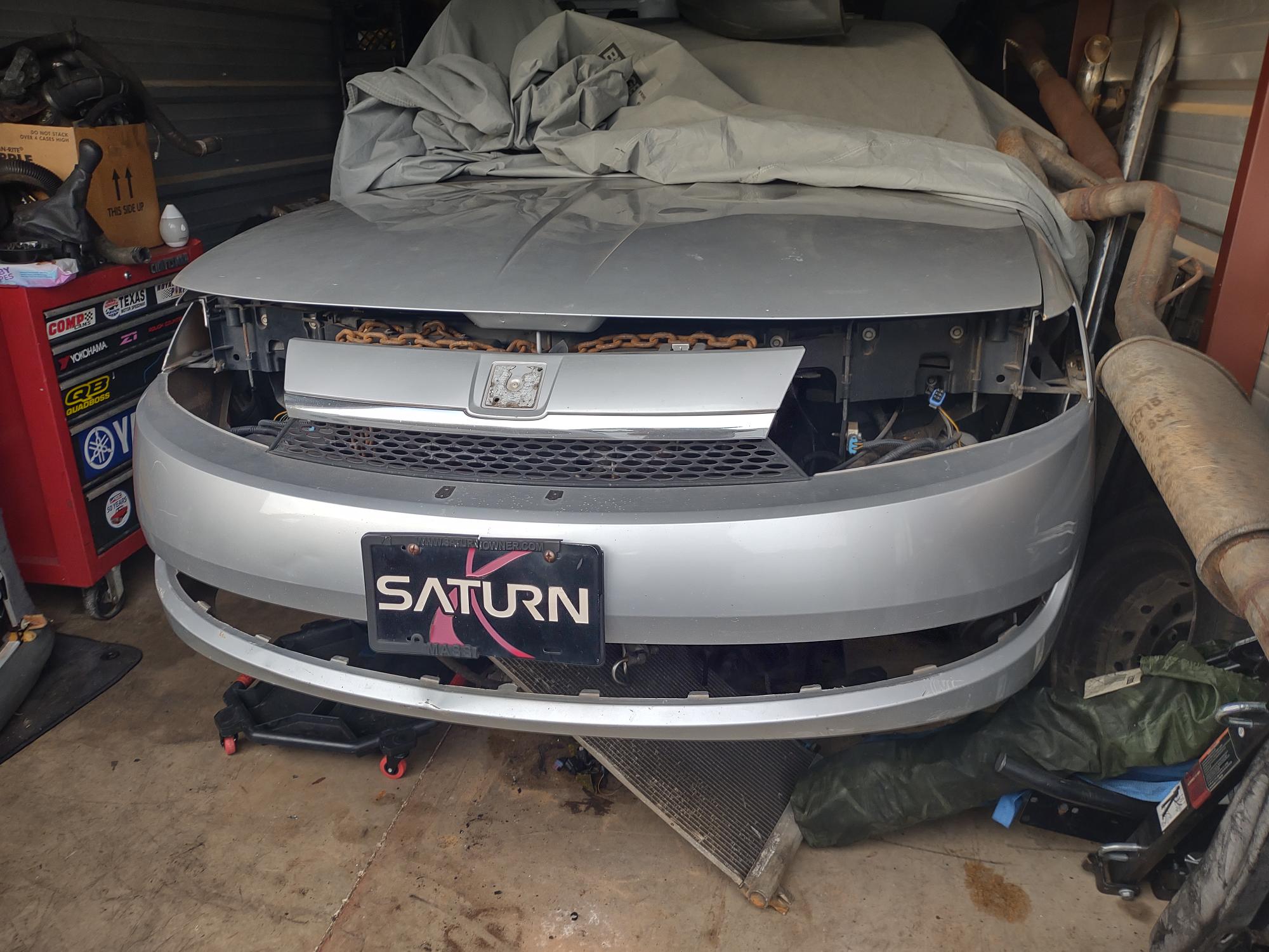

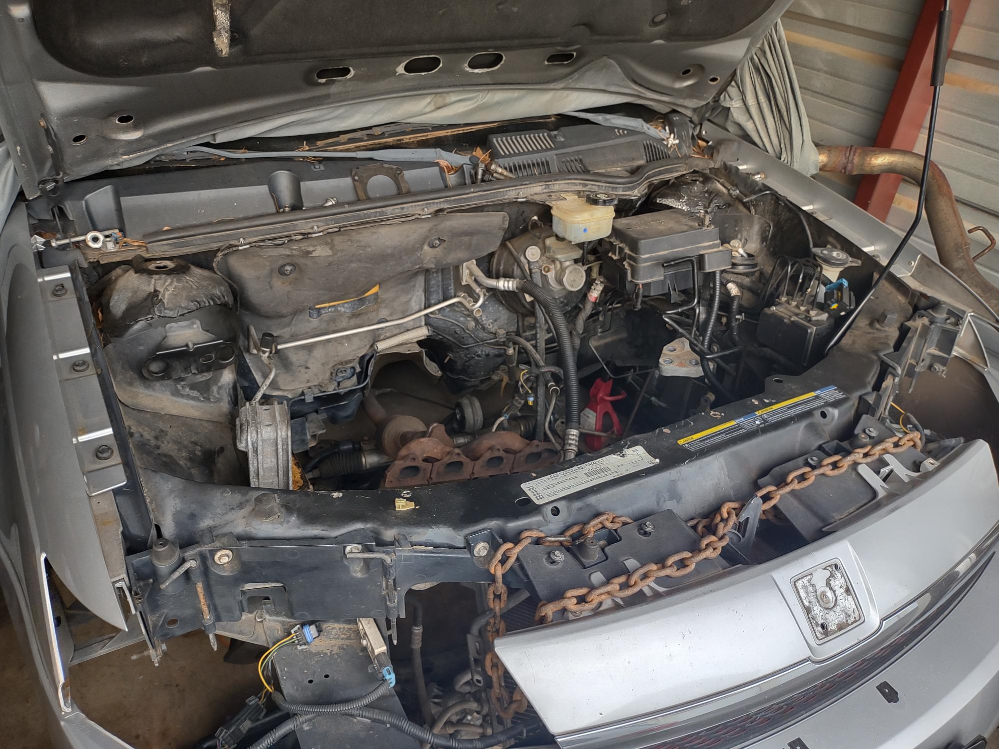

Well, look what I dug out tonight.
Do I start a new thread? or should I pick back up on this one?
Its depressing in a way. I once kept this car almost show room quality. Now its a hunk of crap.
Anyway. Been missing having something fun to thrash on after work and on the weekends. My plan was to have Amsoil fund this, but yea, going to shows events around here, I dont have beer so no one is to interested. Especially when its been tripke digits. Live and yuh learn.
I have some plans. The lady and I are going to get this going again.
And for you environmental freaks, the a/c is still hooked up. Hence why its all dangling in the pics. Only thing on the car that still works.
I do plan on bringing the recovery machine home from work to drain it so I can detail under the hood while I am gutting it.
