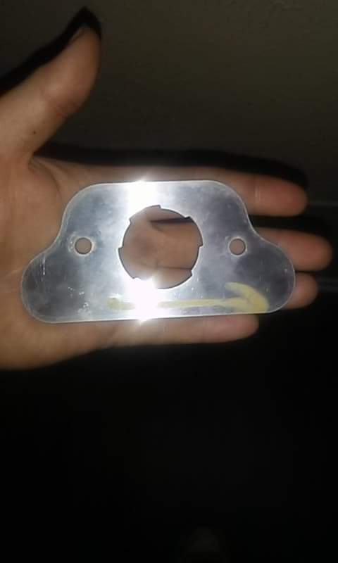

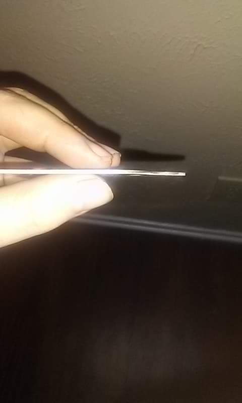

Old Feb 4, 2020 | 07:46 PM
DropDead's Avatar
Joined: Apr 2019
Posts: 854
Old Feb 4, 2020 | 10:16 PM
Capital T should be the good one to build. What do you gain by cutting off the balance shafts? I realize they run at twice crank speed. Is there other way to run the water pump?
Old Feb 5, 2020 | 11:17 AM
DropDead's Avatar
Joined: Apr 2019
Posts: 854
Bothe the low output and high output use the same exact motor. Difference is turbo and injectors.
You could switch to an electric water pump.
Or someone makes a kit to run it in the crank.
Then the way I'm doing it
And removing 15ish pounds of rotating mass will allow me to rev the car out past 9k plus free up 10-15hp
