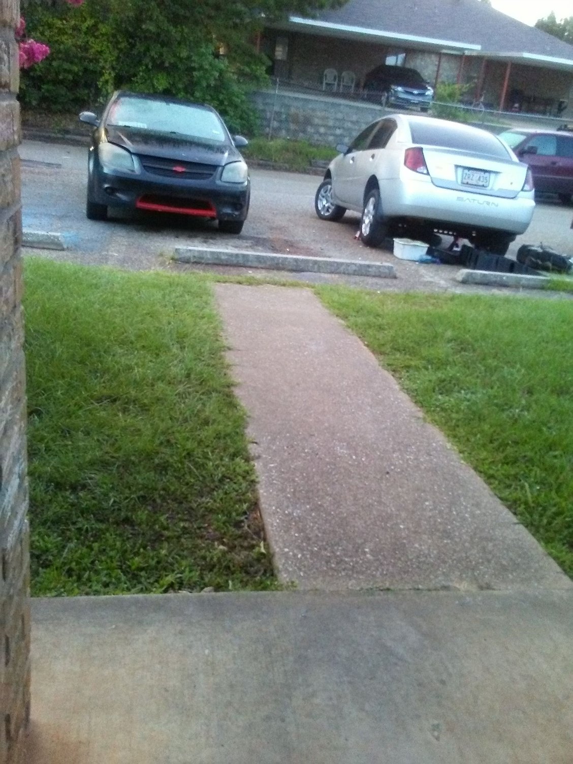

Its a mess. Sat like this for years. Tucked in a storage building now.

Cars moved. Steering rack got destroyed somehow. But its home now. Its a mess. I know only a couple of you know how clean it used to be once upon a time.
it looks like it will be a full on resto car now along with the swap. Which I'm honestly okay with.
