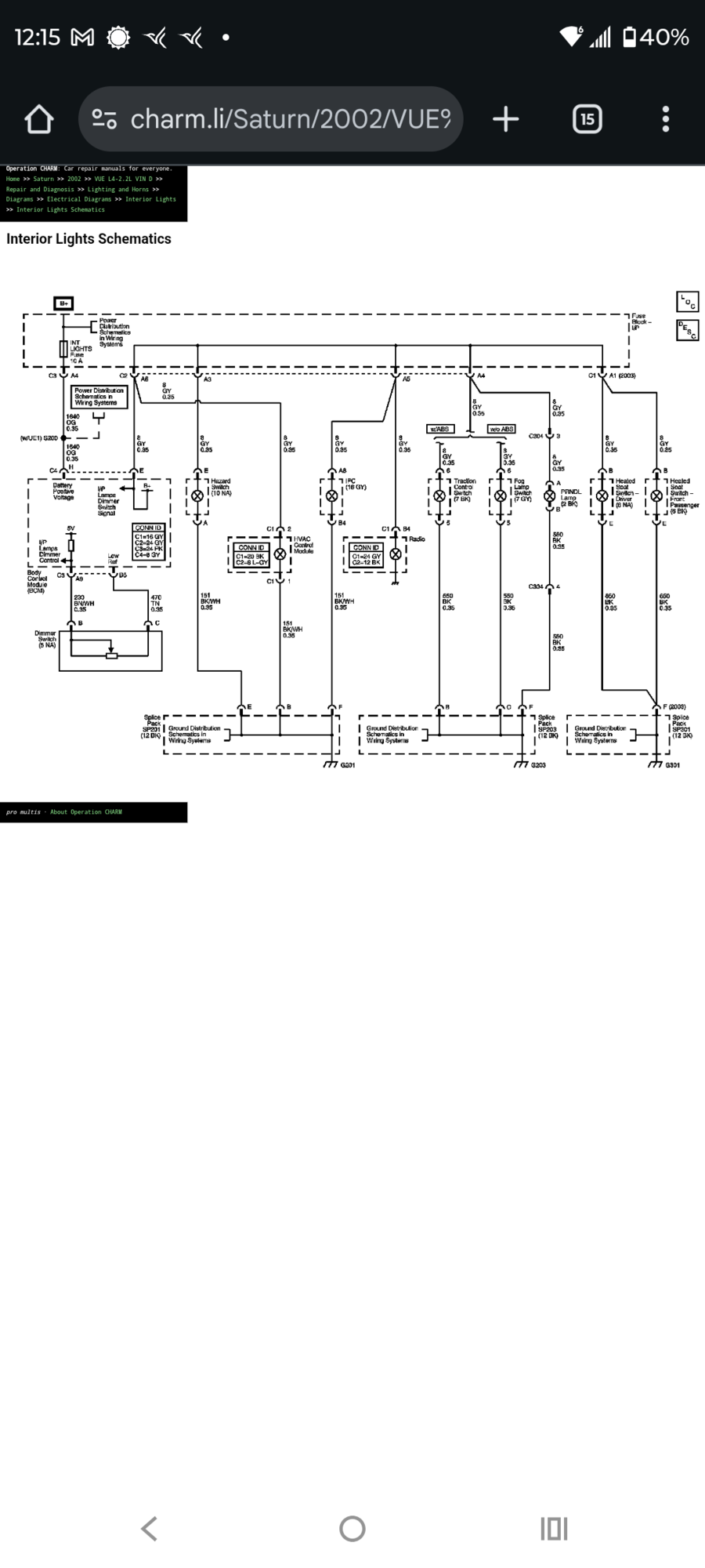

Shorts in lighting circuits can be difficult to diagnose. There are several lights on that one fuse. Running lights in front and rear including the license plate light and the dash lights. It appears that they have not worked since you got the car. Does the car appear to have and damage near any of the exterior lights? Does the car have a new stereo in it, there is a light function in the factory radio harness. Trying to find a starting point for you.
Old Nov 24, 2025 | 11:33 PM
Here are screenshots of the schematics. Some may not come into play but are included for completeness and to aid in understanding how the entire system works.
