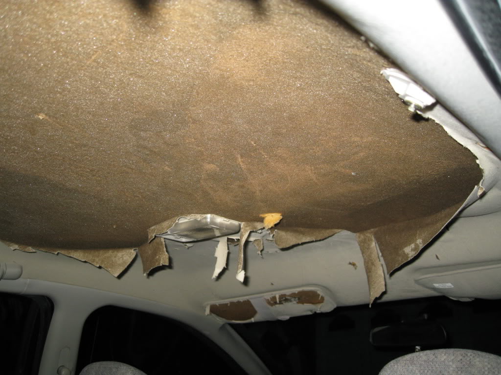

Does anyone know how to replace the fabric layer on the ceiling of a '97 4-door SL2? Most of the fabric has come down and some is hanging in strips. The material above the fabric is like fine compressed particles of some sort, nothing like glue or staples sticks to it. The Saturn dealership is asking $700 just to replace the fabric. Way too much for me right now.
Any help is appreciated. Thanks. Also, does anyone know if that fine particulate material is toxic? Attachment 1974 Attachment 1975 |
That is the glue that holds the headliner in. You can do it yourself. Take out headliner,clean old glue with a wire brush,be gentle around the edges,if you break them off duct tape them back on the back side. Buy the fabric and some 3m spray glue. Make sure you glue the edges good and when you cut any holes for visers,etc. use a razor blade and cut an x instead of poking a hole. DO NOT oversoak the fabric with glue or get the glue on the fabric. Fold it in half and do one side at a time while covering the other side with plastic. Good luck. I have done thousands.
Geez Louise -- did someone go bonkers in there with a utility knife?

I'd go to the junkyard and look for a good headliner and replace the dang thing. It's not that difficult. I replaced both of the ones in the SC Coupes I had and the one in my 99 Dodge Grand Caravan. The pick a part in Nashville charged me fifteen bucks for each one. A hell of a deal! If you try to do the fabric yourself, you'd better make sure you get EVERY bit of that old glue off. If not, it's a waste of time because you'll have a spot where the fabric won't stick. And if it doesn't stick, it'll cause a bubble which will lead to a sag and then the whole thing will eventually come back down.
