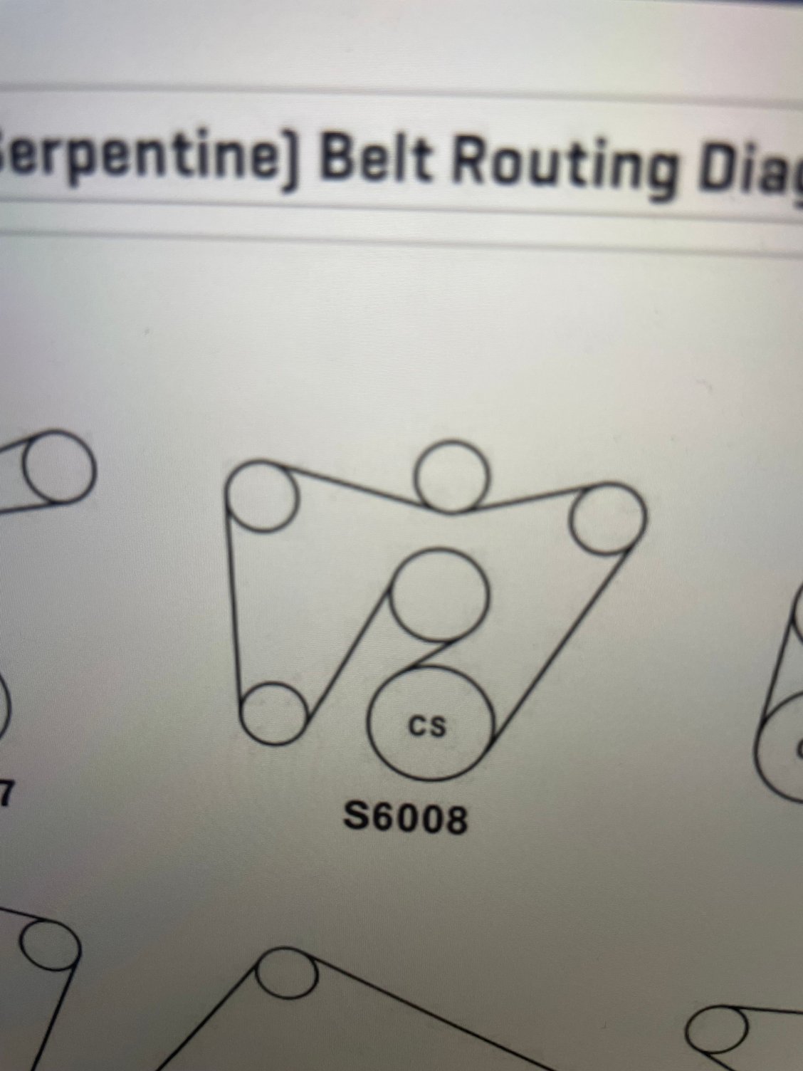

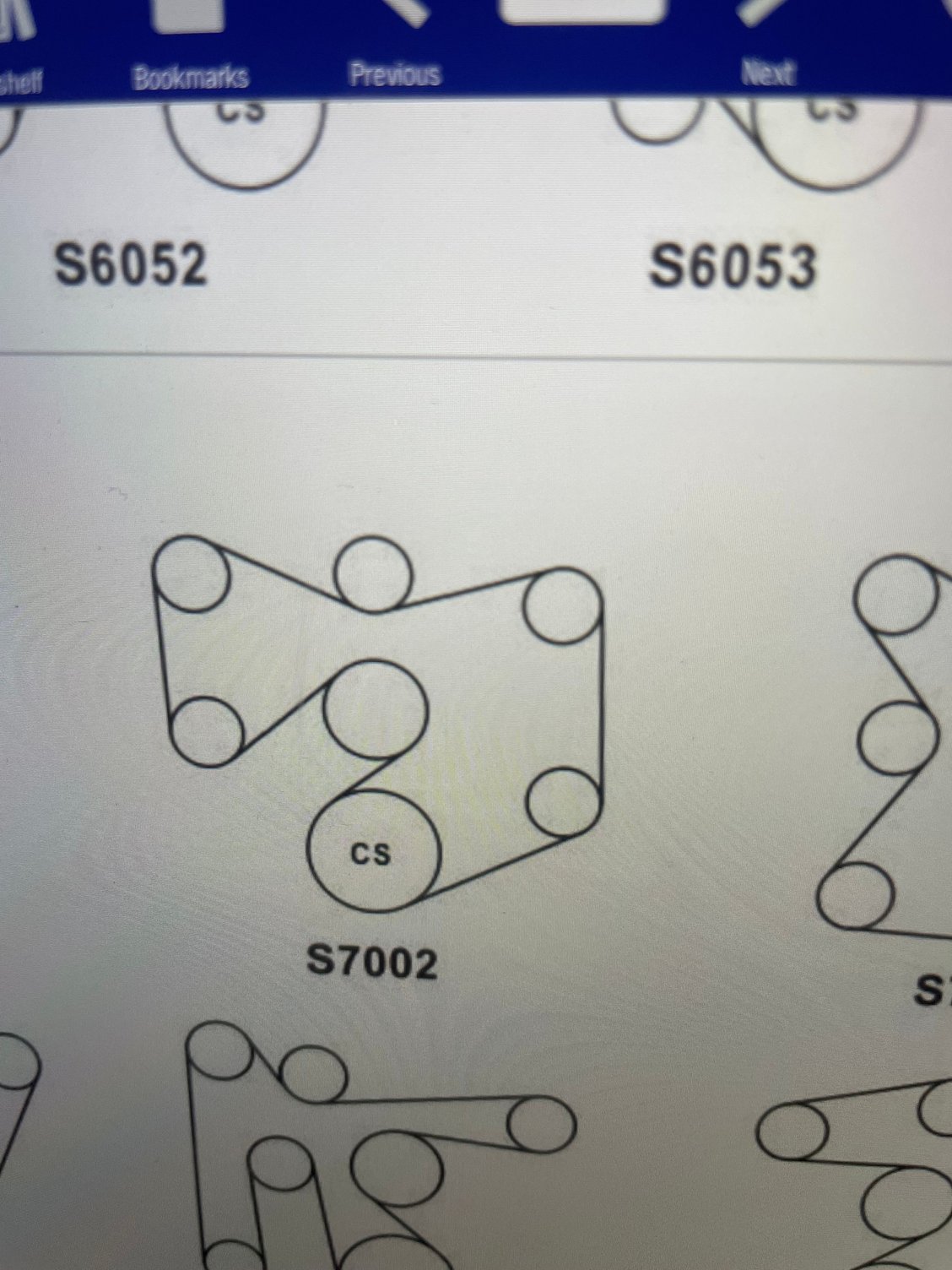

Looking at the belt diagrams I believe that you can replace the belt and leave the defective a/c compressor in place. Your car was available with and without air conditioning. I will post both diagrams. The compressor is in the lower right position. If you have your mechanic install a belt for your car for the non a/c option, it should solve your problem.
https://cimg8.ibsrv.net/gimg/www.sat...d57b6dd06.jpeg
Without a/c
https://cimg0.ibsrv.net/gimg/www.sat...95b7ff8f2.jpeg
With a/c

thanks I am sure he can figure this out at this point I hope to get a 2nd car soon ( I have a 2002 firebird that I cannot drive in the winter) so this Saturn is going to be going as soon as I get another car

If the compressor bearing is making noise, it is bad enough to make your car stall at idle. Take the belt off and see if it quits stalling. If it runs correctly put a belt for a non air conditioned car on and drive it. I have done this with many cars for years.
