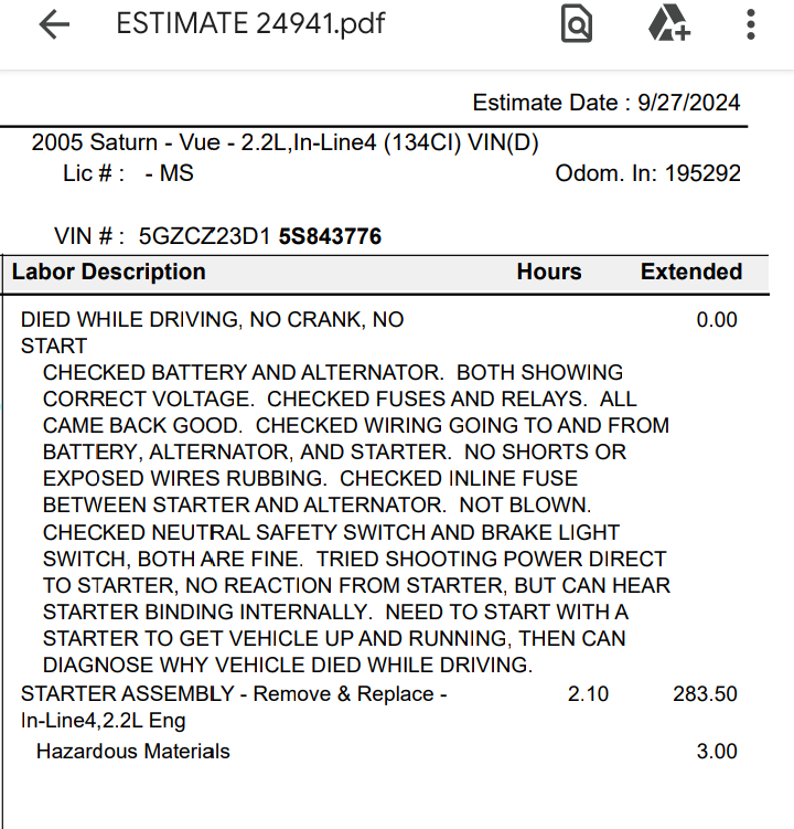

Default Just got this from mechanic
I went in yesterday and requested a list of tests they had already performed because supposedly they were going to hook it up to the computer in the shop....
My car hadn't moved from where I had pushed it to park it after I was towed with a tow rope!
Now mind you that when I requested the list she couldn't provide me one, she was going to have to ask the mechanic if he remembered which ones he had done........
