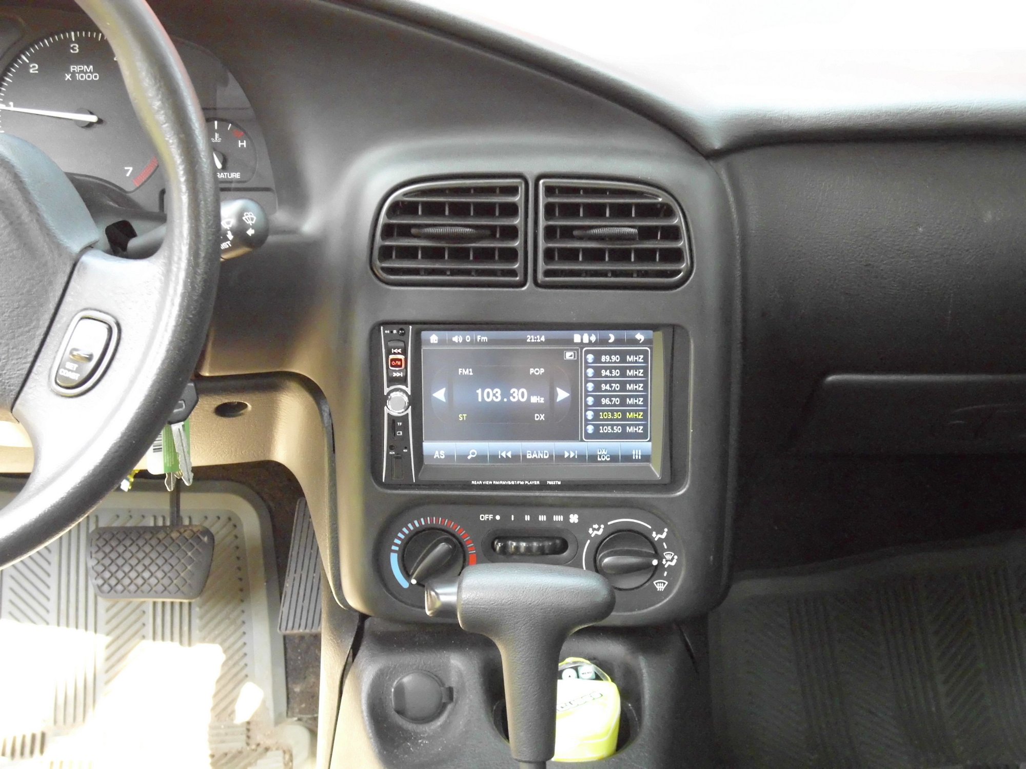

Took out the Factory radio and installed a Double din touch screen stereo with a back up camera and bluetooth. I bought the cheapest stereo off of ebay any I am still pleased.
Before
After
Back up cam

The problem with these cheap stereos is that they are 7" x 4" , not the standard size. unless you know this you wouldn't think to buy an install kit for a 7" x 4" stereo. I happened to get the wrong one but was able to trim out what was not needed with an x-acto knife, trimmed off the 1/8 th lip from the inside diameter and the radio fit just perfect.
i have a few complaints about the stereo , made in china, generic no name. the radio beeps when turned on for a few minutes then stops. but does it every time the radio is turned on, the clock is in military / 24hour time
other than that the radio has great sounds, the screen is big and more sensitive than my sons JVC stereo
radio cost me a whole $53, $10 for the install kit, the backup camera came with it. has USB, AUX, TF for micro sd card, bluetooth, plays all video and audio formats. No cd player or dvd player but you can watch them using a USB flash drive.

No issues connecting the radio it was just the annoying buzzing every time you start up the car, lasts about 2 minutes, The back up camera I mounted above the Licence plate had to drill a 1" hole to mount it properly. The wire was run under the carpet and console to the radio. got a radio conversion pigtail instead of cutting wires. the main issues will be ordering the right size radio . the one i got is about 1/4" bigger than the standard touch screen radio so I had to modify the bezel that frames the radio. these radios come with pictures and tells where to connect it. not hard just tricky .
