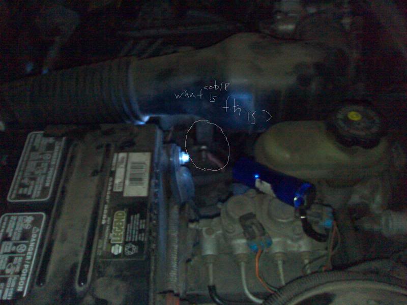

what the heck wire is this? it goes from the battery to the engine, but there is also a red wire
Attachment 2051 Attachment 2052 |
Its a PCM ground. Theres another one on the back of the block, two more on the left bell housing to block bolt and two more on the drivers side frame rail.
