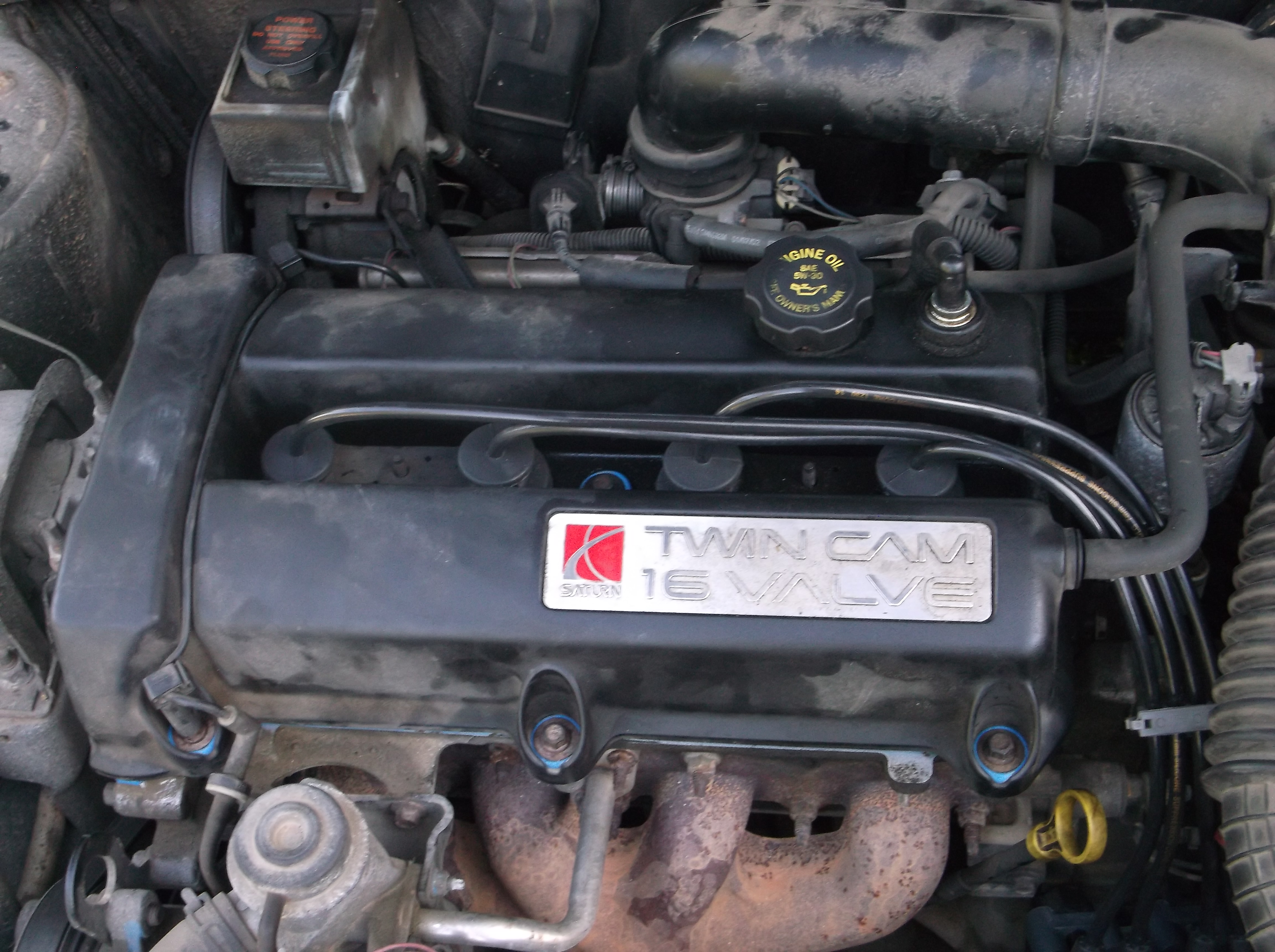

close up of valve cover. sry for all the dirt. i used to take this car down lots of dirt roads, through creeks, and mud holes. this was before i got the job with UBER

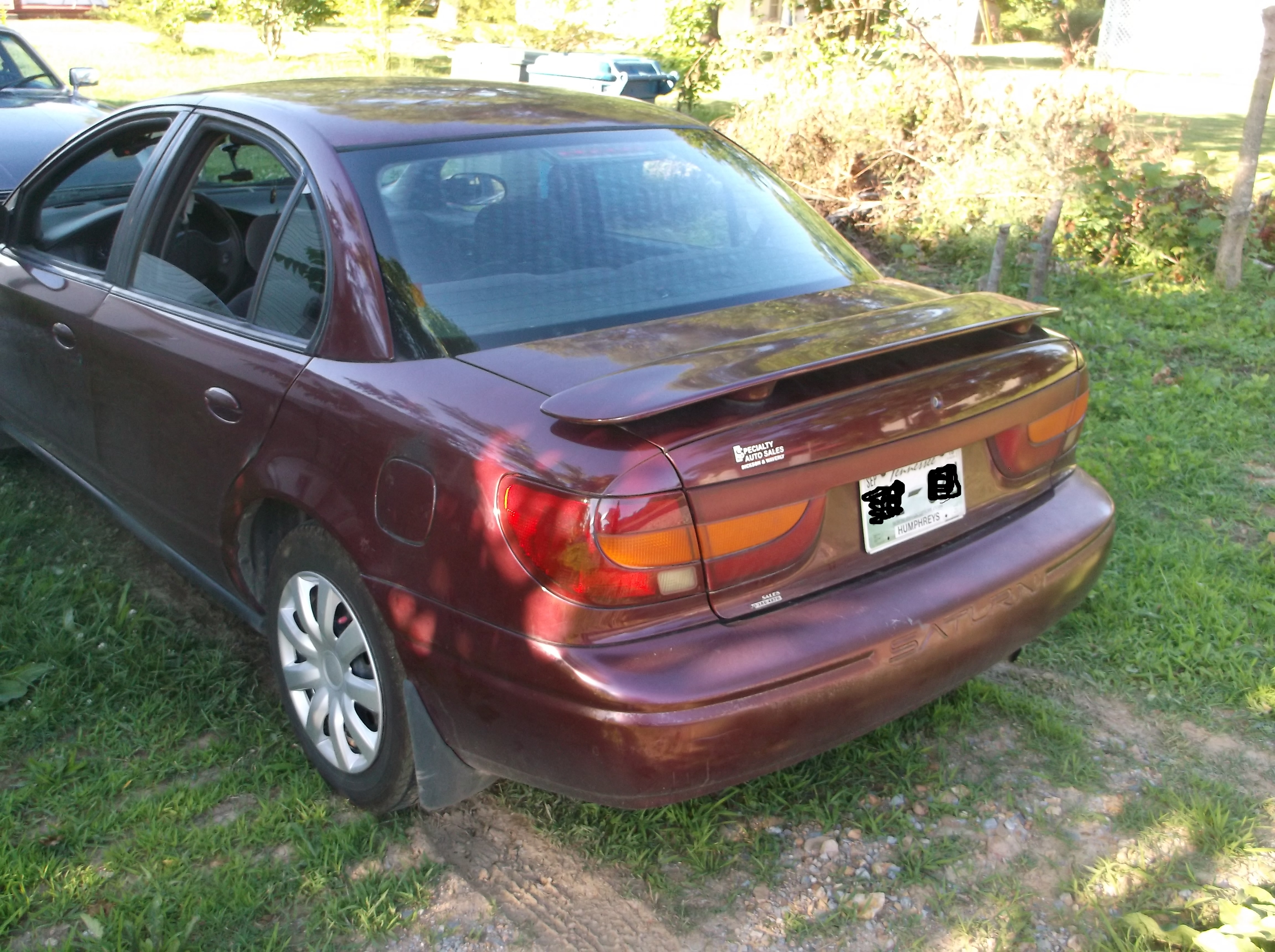

the area on the trunk where the red and amber areas are i plan on getting a custom made piece of plexi and adding colored LED stripes back there to add additional running/brake, turning, and reverse lights to the car. probably gonna look weird but who knows. and sorry that i sent all these pics one at a time

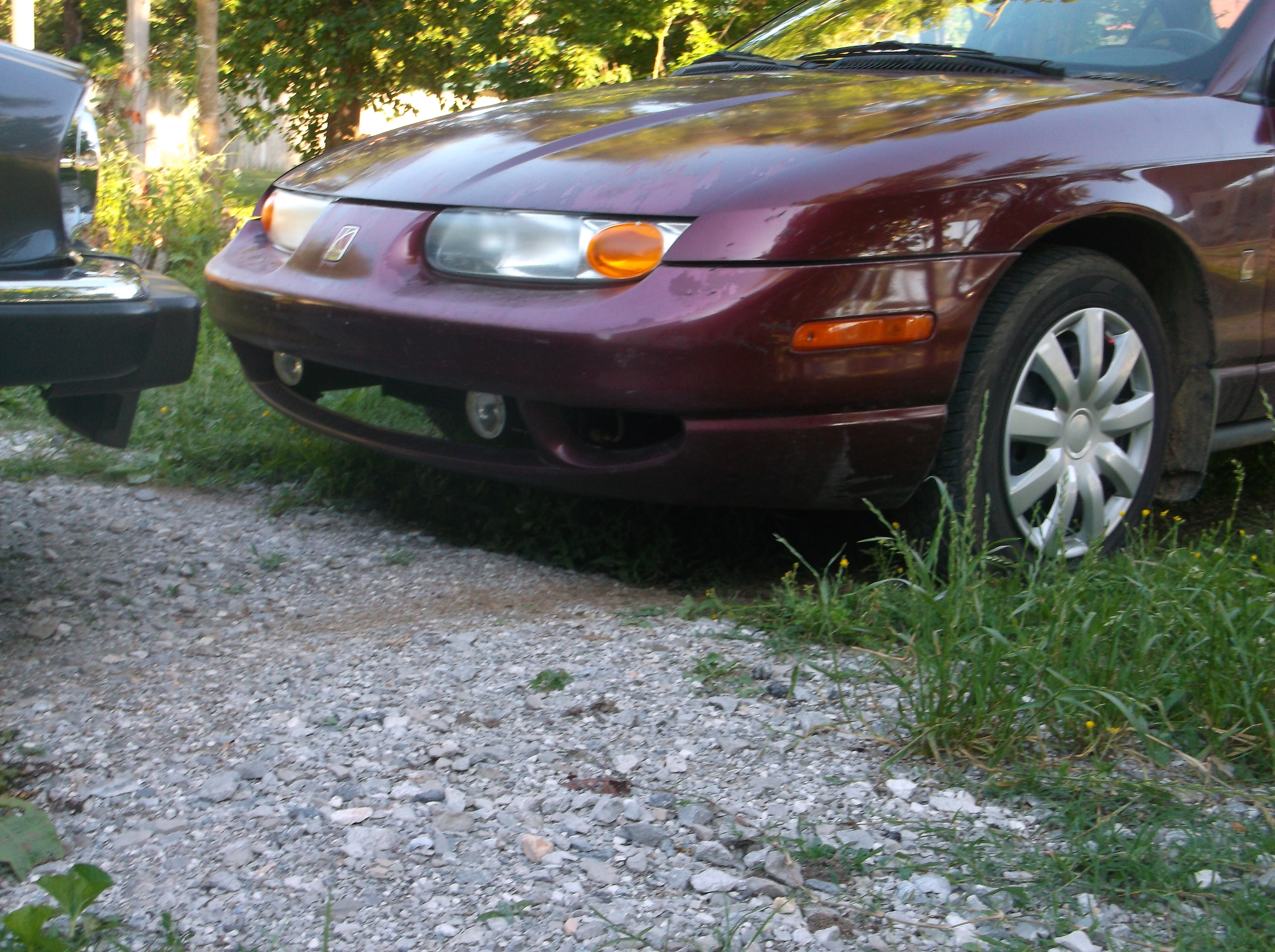

Nice. Very nice. Looks like it's been regularly waxed, but did something happen to the hood? Reflection isn't the same. Not criticizing, just asking. I HATE when parts of my car do stuff like that.
